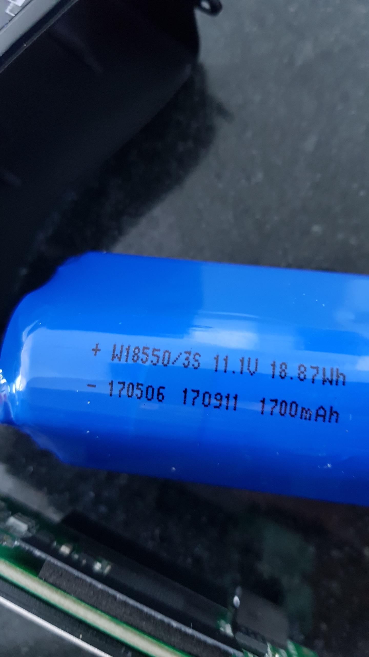

I have a vaping device that I love. It is discontunued and all new ones being shipped is coming with a dead battery.
How do I go about reviving this battery? I put the voltmeter on the solders behind the board and it is reading 6.85 volts. So I think the battery cut itself off and the board is not recognizing it.

Voltage for a 3s pack at that level is beyond revival.
6.85/3 = 2.28V per cell......
About all you can do is take off the plastic wrapper and see which type of cell they are and go from there.
I suspect there are 3 x 18650 cells.

On the pic it says 18550. I have watched 0 volts batteries revived. Why not this one?

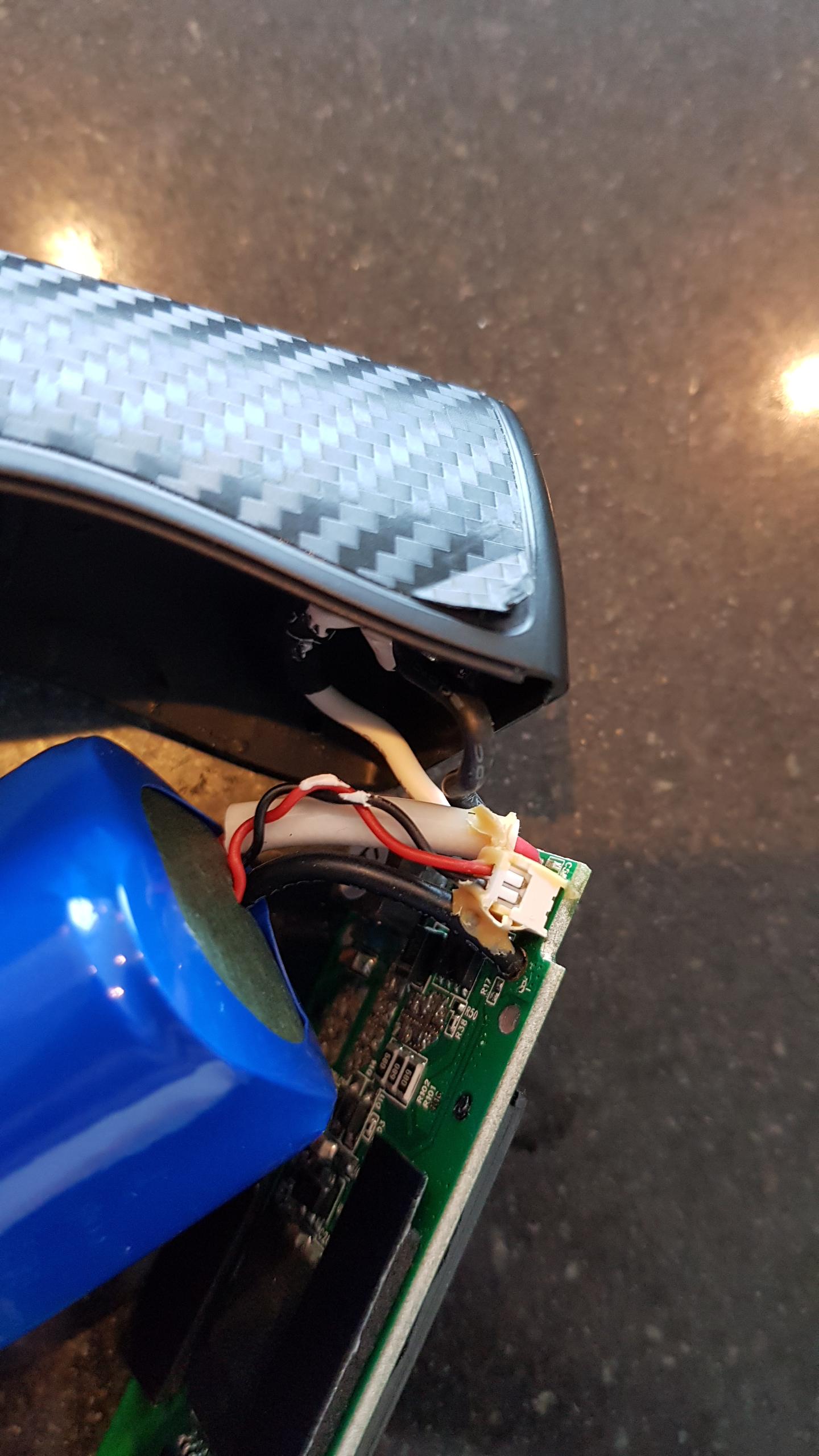

Martaine, how do I jump it connected to my PCB?
In other method I should desolder it (and remove the plug going to PCB)?

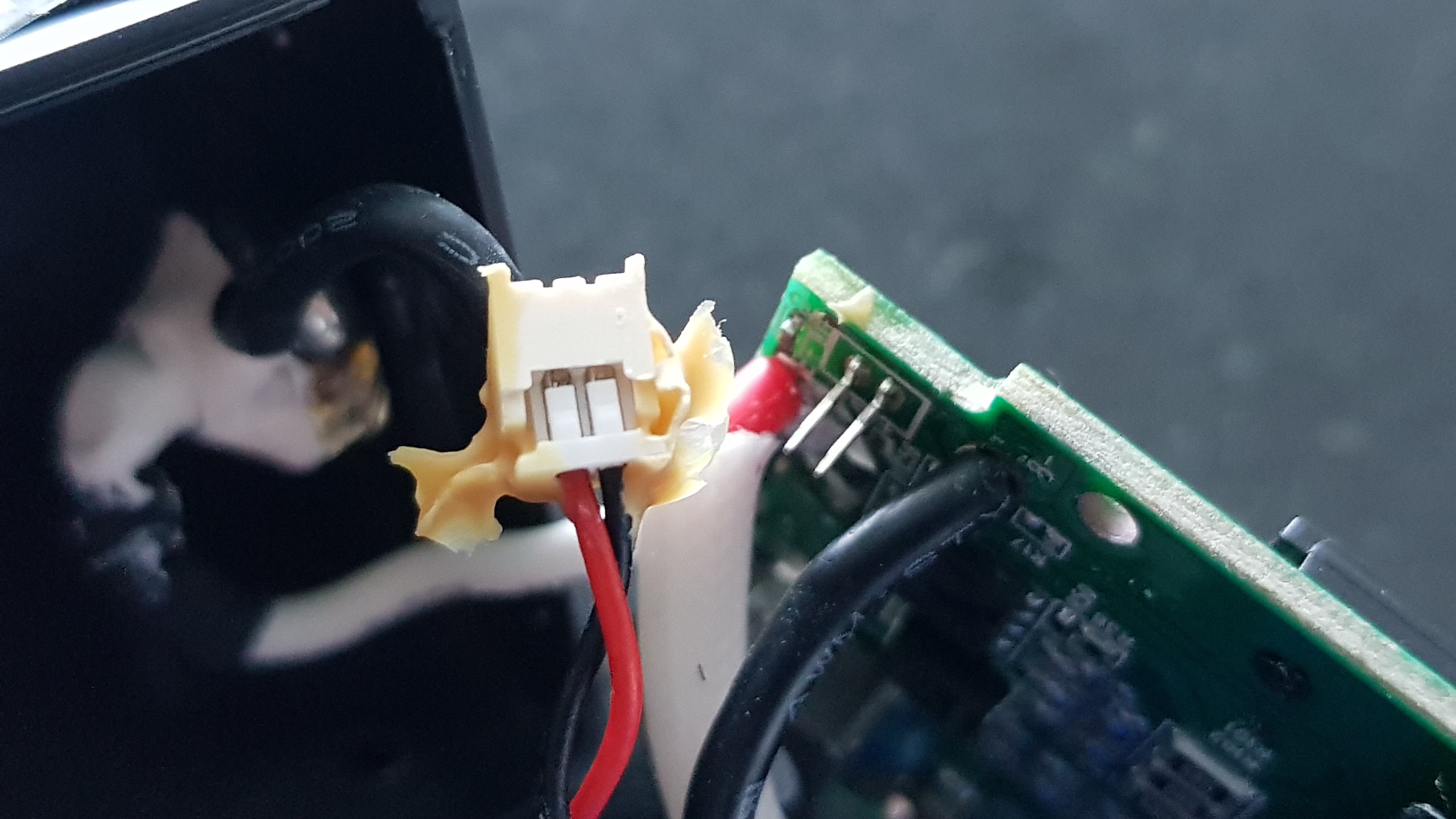

Okay mate, but the connector is so small. For example, I can not see the metal parts on the white plastic plug. How to jumpstart it?

You have to use your imagination!.
Push wires into connector?
Hold wires to bottom of connector on pcb?
Remove a bit of wire insulation and make your connections?
Remove battery heat shrink to get to connections?
Push pin headers on connector?
Many many ways.

What are the wires going from battery to the PCB (soldered on PCB)?

Ok but they are soldered Martin. How do I do this? Do I touch the solders from the back side of PCB?

But doesn't this burn the PCB?
No, you will only be one second.
Attach wires to your power source then have a wire in each hand. Hold one wire with your thumb, pressing it on the pcb connection. Then with your other hand touch the other wire to the other connection.
The adapter may work. I have never tried. I always have other tool batteries available.
No reason why it shouldn’t though. Make sure you get the polarity correct.

It is like jump starting a bloody car!
Every time I am doing, it is increasing a bit. Using 9V battery.
From 6.85 I went to 7.08. Yes I tested many times before, never seen over 6.85.
No sparks. I do 10 secs each time now.

Whatever you do, short of blowing the innards, will do nothing to revive a lithium cell which has discharged below a set level.
The cells obviously have internal damage which will only be exaserbated by exposing to unregulated high current /voltages.
