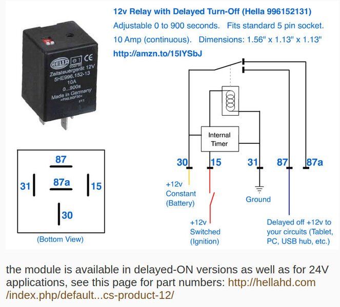

On a New Farm Telehandler the Revesing Bleeper is pulse Bleeped via the wiring ok.
all CANBUS so i believe.
I would like a trigger feed to activate a sep Relay to power Reversing Lights as such
yes it doesnt have any.
Is there such a circuit or box available that i could add in somehow to be switched to a perm live state
when the bleeper circuit is live & pulsing & when the pulsing stops it switches the Box off?
Many Thanks

I will try to explain with words so I don't have to draw a diagram: Is your machine 12 or 24 volts? That linked timer says 120 or 240 volts AC, so you might have to look for a different timer. A timer needs its power voltage and a trigger voltage. The trigger voltage (from the beeper) is probably sharing a common ground with the power voltage,
Retriggerable is definitely what you need, that means you can trigger the timer (turn it on) again before the initial countdown is finished. So the intermittent beeper pulse keeps the timer on, then the timer will turn off a few seconds after the last beep. Once you have the timer voltage and beeper pulse voltage figured, then you look at the output relay contacts on the timer. The NO normally open contact is just like a light switch ... it turns ON and OFF whatever is wired in line with it, So you take tap off your power voltage, run it through the output contact, then on to the lights. Of course you will add a fuse in the power circuit.
Find a timer with the correct supply voltage, and read the instructions fully. Find the drawing that matches your needs, then re-draw it to match your setup exactly. Plan your locations and wiring. Maybe put together a test circuit and see if the pulse actuates the output relay. If the beeper goes once per second, then set the timer for 2 seconds. Be sure the timer is set for DELAY-OFF operation. That way it turns ON when triggered, and turns OFF after the trigger is gone. Good luck!

Hi My Machine a MERLO Telehandler is all 12v
is there no such thing i can buy thats made to do this task without having a electronics A Level degree to make something from scratch
i can solder & stuff but my limited knowledge of building a complex circuit is beyond me !

The canbus is the digital signals talking between the various modules. It is the module that puts out the "beep signal" to the beeper. We want to use the 12 volt signal that goes to the beeper, nothing to do with the canbus. As you learned, any light connected across the beeper will flash whenever the beeper beeps. What the timer does is keep that voltage going long enough to light a bulb.
This timer https://www.amazon.com/Altronix-6062-Digital-Timer/dp/B0006TZEDS is all you need. They are versatile timers that can do just about anything. I have used them many times. As I have said it has a trigger input, a relay contact output, and a supply voltage to power the timer. It is basically 5 wires, a couple of setting switches, and a turn control for the number of seconds. On the vehicle you need access to the beeper wire, a hot-on-ignition wire, and a ground point on body or frame. I can draw a diagram once you have the timer and checked a couple of things on the vehicle.
If you know a local alarm installer or electrician, they could probably do the job right away. Or check back here once you have the timer. It is no more difficult than loosening your power steering pump and changing the valve cover gasket. Except it's electronical... haha.

The Hella 996152131 timer relay would be a good choice, provided the beeper has a constant ground.
The beeper would have to have the positive pulsed to work with this relay. Won't work if the beeper negative is pulsed.
See diagram below.
30 - fused 12v battery or ignition supply
31 - ground
15 - pulsed positive to beeper
87 - output to reverse lights
Operation.
When the beeper is pulsed on, the relay will latch on connecting 30 to 87. This will turn the reverse lights on.
The relay will remain on when the beeper pulses off. Reverse lights stay on.
The relay delay time will be reset when the beeper is pulsed on again.
The reverse lights will remain on as the beeper pulses on and off.
The relay delay time setting just has to be set slightly longer than the beeper off time.
Once the beeper stops beeping, the relay will time out and the reverse lights will go off.
hella2-jpg.1715597745
A "cheap and dirty" option might be to connect a capacitor across the coil of a standard mini relay.
The coil would be connected across the beeper through a diode(1N 4007).
Would be trial and error to find the correct size capacitor to get the desired time delay.

Hi there sorry not been on here for what seems ages its about a year
anyhow i did get around to getting what i thought was that relay you mentioned above however its a slight diff part no.
I got the Hella 8996152151 one & it deffo doesnt do the job so it must be 100% the one you kindly mentioned above yeah?
Hella - 996152131 TIMER CONTROL 12V 5PIN 0-900S DELAY OFF
mine is this one
Hella - 996152151 TIMER CONTROL 12V 5PIN 0-900S DELAY ON
it just flashes on lowest time setting this one & does nothing if you increase the time.
So if i order the 131 version will that do the trick? Finally
ive added the lights since thru a standard 4pin relay & all they do is flash on/off with the bleeper but its better than nothing.

Updates folks if anyone is watching this thread
I finally got the correct Relay ending in 131 & hey presto its like voodoo magic
All working perfect for one day until today i noticed the led lights ive installed now staying on after selecting neutral or forward?
I also at the same time put a kill switch on the +Live side of the dreaded bleeper & alll that was working fine UNTIL !!
today i jumped out the machine only to find the led lights all still on & it wasnt in reverse.
If i switch the bleepers + line back on it kills the leds
WTF is going on??
HELP
