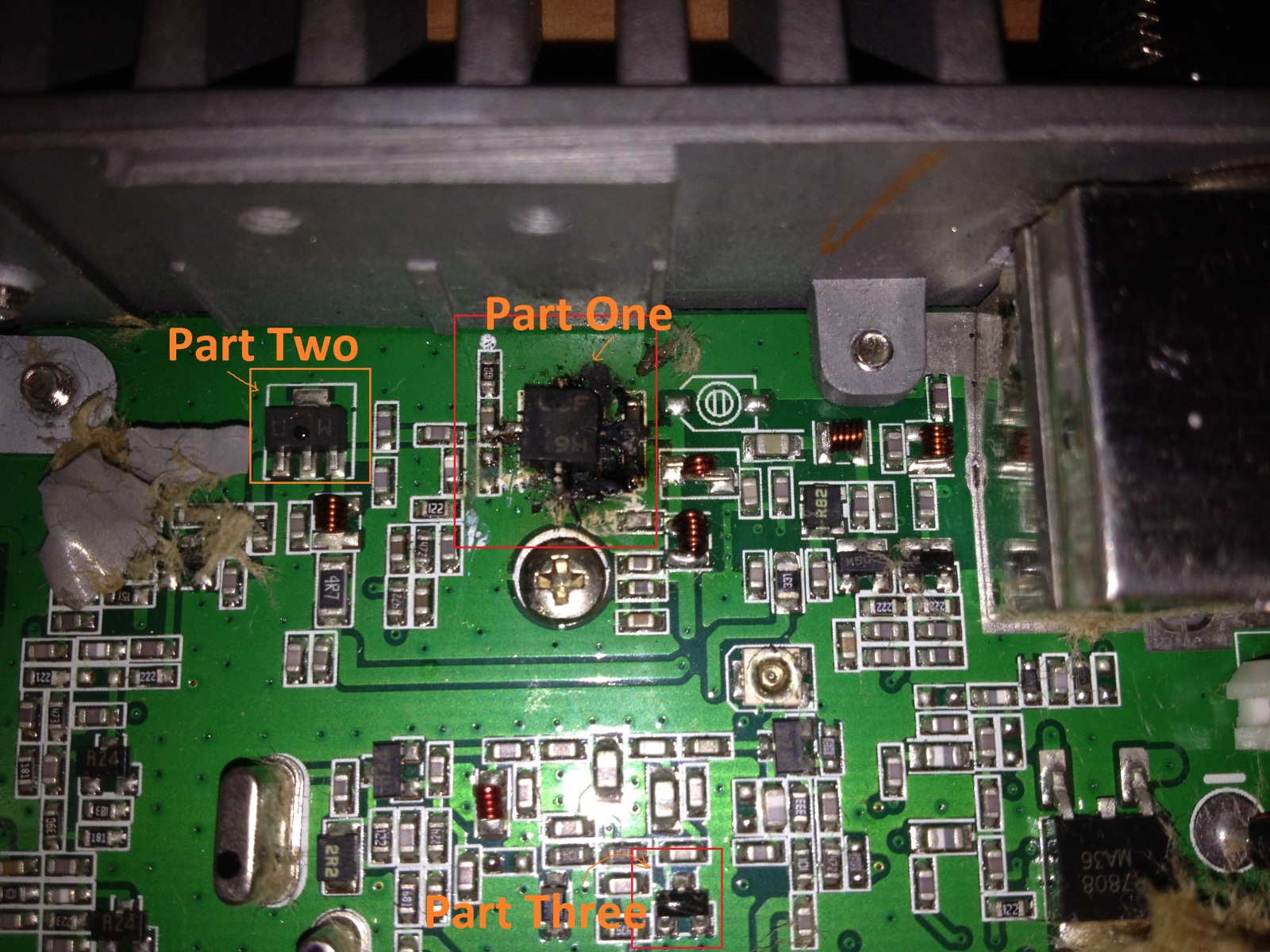

Parts 1, 2 and 3 - I'm mostly interested in part one here as it's obviously got to be replaced and I don't have the foggiest clue (maybe a regulator). It is screwed (using the one next to it) to the metal of the heatsink at the top of the photo so I'm guessing on a linear voltage regulator of some sort.
As for part two - is that little bubble in the centre normal? It otherwise looks okay.
Part three - haha some misc. little SOT23. Good luck chaps! I'm guessing the strangely bubbled up plastic isn't normal? Hopefully I'm wrong and sometimes they're just made like that.

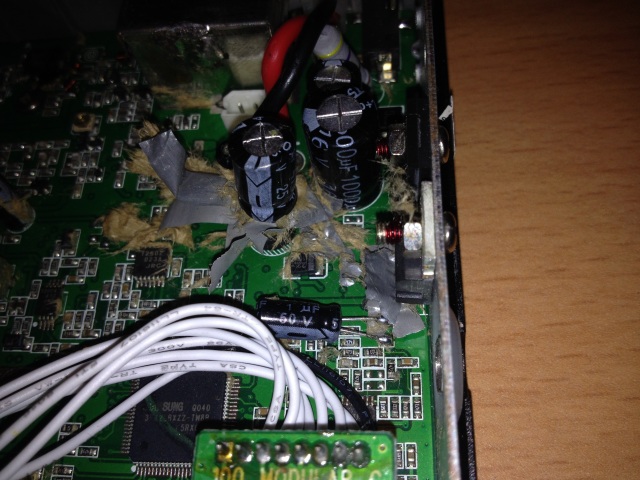

Now for the offending capacitor - I'm guessing either a result of that "regulator" failing and/or being connected in reverse polarity. The vent never broke, the whole body just popped up. They are all "ISHK" brand (I think). Heard of them? No, I didn't think so...

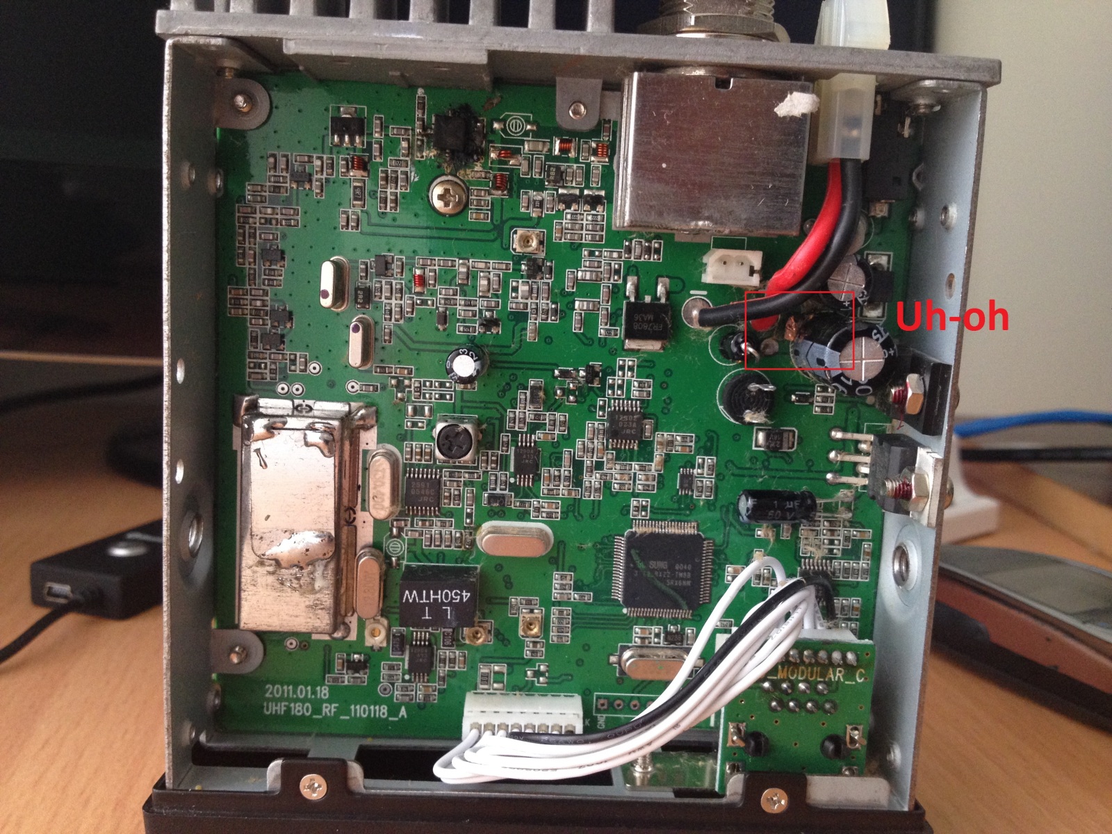

By the way, here is an overall view of the circuit board. It is a two-sided board and doesn't appear to be multi-layered.

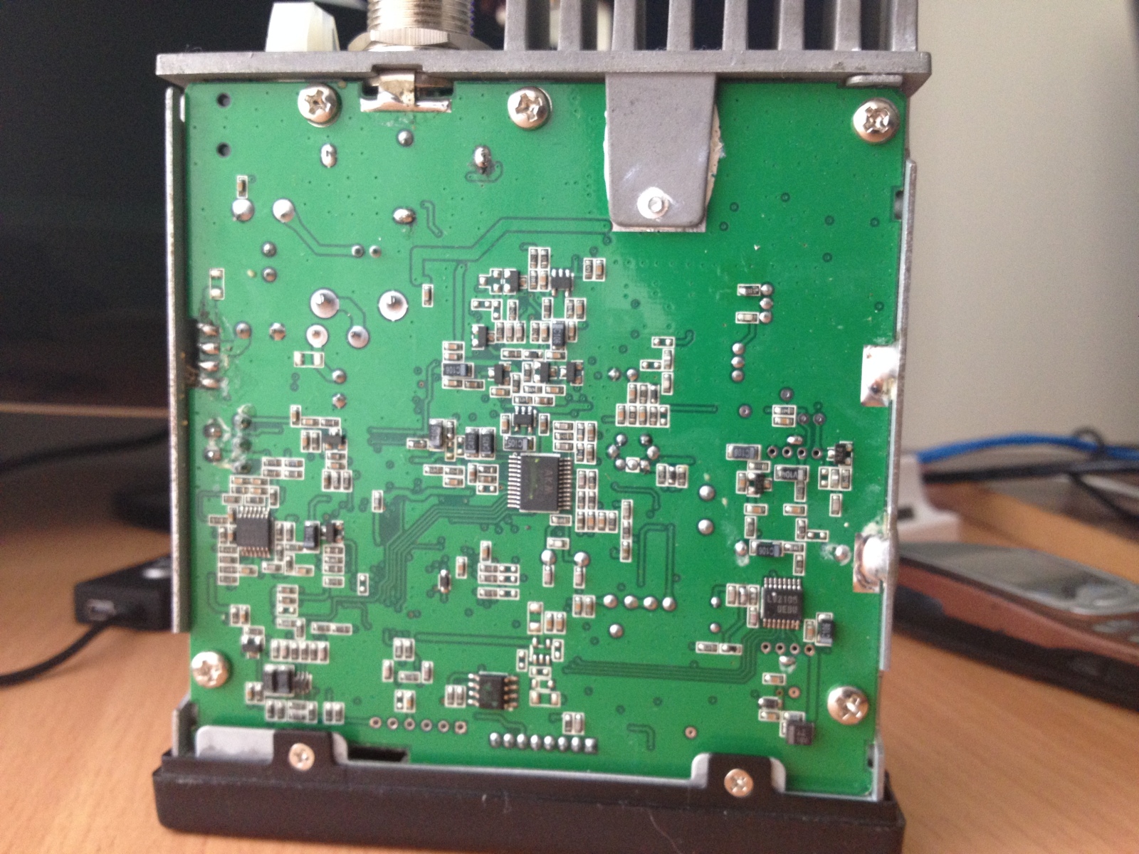

Here is the bottom side (no visible damage aside from what looks like messy flux):

The "uh-oh" is a lifted trace for the main 12v positive in, in case you can't see it clearly, by the way. Not a big deal to fix, but that there was enough current to do it is what worries me!

To be honest, I don't have a clue what that little four pin quad pack is. It's not near the power circuit so it's not what I thought yet it needs the heatsink connection underneath it?

OK thanks for that,
that 4 pin device you circled as part one in the first pic is the final output transistor ... part two is the driver
I would day there's a pretty high chance that the damage done to all was because of the power being reversed
the capacitor, circuit track are a high indication of this. The final transistor will have its DC supply direct from the 12(13.8)V input
hence its demise
could it be fixed ... with circuit info .... YES, without info on part types, very difficult to impossible

Never mind :rolleyes: They replied with the PCB layouts and circuit diagrams eight minutes after I emailed them...
The transistor is 2sk3476 and I'm yet to look up the other bits but now I've got to track them down. What do you think is the best source for one-off components? Believe it or not, but the 2sk3476 is on eBay hahaha (for $6.81 from Hong Kong...) Can you suggest a better place?

Part one is 2sk3476
Part two is 2SK3078
Part three is KDV804S

Oh, never mind about part two and three. The "melted" case just had some stray flux on them. It scratched right off... :oops:
I feel like a bit of a git now...
So, to recap:
-Repair trace
-Replace cap
-Replace output transistor
-Replace shunt diode (I assume)
What might be the likelihood that that's the extent of the damage do you think?

a good chance that's all
its worth a try and see if it works .... the cap you probably could use something like a 1000uF 25V
the shunt diode ... if its faulty ... yup replace ... you could use something like a 1N5404
looks like you will have some circuit track repair/cleanup around the output transistor once its removed
initially leaving the output transistor out of circuit, and not pushing the TX button, you could at least see if it receives any local signals :)

I have had success with repairing the radio to a point where the RX appears to be working perfectly and I am now waiting on a replacement output transistor from Hong Kong to repair the TX side.
The repairs simply consisted of repairing the lifted and split trace, replacing the two input caps, replacing the shunt diode and replacing the link cable from the radio to the head display (had some breaks and I needed to use up that old CAT5 and now it's much longer ;) ).
Now for the bad news. Despite using very low heat and air volume the pads popped straight off the board with the old transistor. I get the impression that no matter how careful I was, that was going to happen regardless. Hopefully it won't be a problem, but there isn't a huge area to solder it to. The bare board is present under it and it is also a multi-layer board after all as well. Seeing as it is the output transistor I obviously don't want a bad joint on it either so that will be fun when it comes to it. I'll upload a photo later if anyone is interested.
