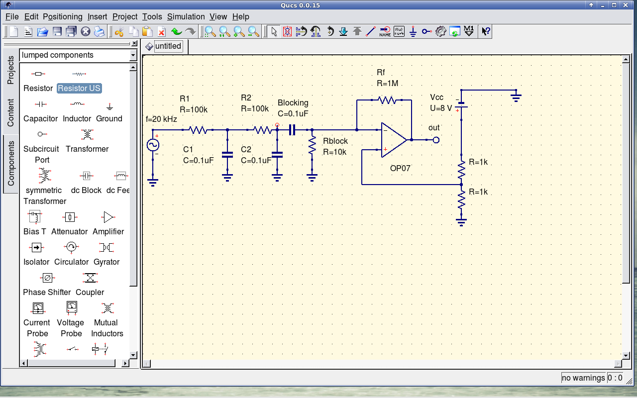

It appears that I'm stuck with this again...
I've attached a schematic...
The input is actually a photo-diode with op-amp for gain. I'm sending a PWM
20kHz carrier via 650 nm laser diode. The photo-diode receives this pulse, which has a lot of chatter in it, and gets sent to the filters.
To keep the schematic simple, I just put an AC voltage source in.
I'd like to not use a negative voltage source. I'm using an OP07 op amp, and wondering if I should be using uni-polar op-amps....
I've got the circuit working when using a negative supple and no voltage divider.
I don't see why I need a negative supply though.
Thanks again,
wbg

I totally forgot about setting all the f_3dB points...I was taught how to bias a transistor in school...the application note I posted covers it.
I got the circuit to work with a single positive supply....and it wasn't worth it...
too many more parts and a total PITA...two batteries is not such a big deal....
However, I did try pushing more current through my laser module, 30mA, and it now
has a small instability...or the Rx has an issue...
Not sure but I broke my circuit...while making it better...:confused:
Now I've got something to do all weekend...
