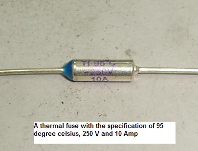

Sir lightening (sic) slinger . . . . . . .
" This involved probably about 20 hours total but not continuous usage of a Crockpot "
Too late for you to tell now, if you no longer have the WHOLE unit, but my money would have been bet on a thermal fuse that is mounted in thermal contact with the HOT area and is in series with the heating element.
So when you test the heating element , that open thernal fuse (replaceable for a buck or two ) makes you think that the heating elemnt is the at fault unit.
It'sa a look-a like-a this :
73's de Edd
