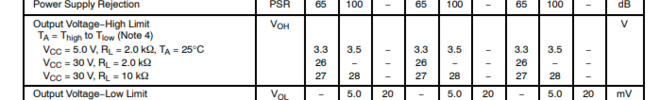

At 5 V supply, the max. output High voltage of the LM358 is ~ 3.5 V:
That means the buzzer is supplied by ~1.5 V (5 V supply - 3.5 V output of the opamp). That may be enough to make it buzzzzzzzzzzzzzzz.
You could
  1. use another opamp with rail-to-rail output that goes all the way up to 5 V.
  2. use a zener diode in series between the opamp and the buzzer. Something around 1.6 V or so. Additionally use a resistor in parallel to the buzzer , [imath]1 k\Omega[/imath] or so. The absolute value is not critial. This resistor helps to bypass the leackage current through the zener diode.
You could

What op amp would you recommend?
Here's a selection of so called rail-to-rail (r2R) opams.
The zener diodes I have are 4.3v. That ok?
No. That is way to much. The buzzer will "see" only 700 mV when the output of the opamp is low. 300 mV are insufficient for proper operation of the buzzer.
Instead of a 1.6 V zener diode you can use 3 run-of-the-mill diodes, e.g. 1N4148, in series. These will drop +1.8 V ...2.1 V. Good enough for this application.
