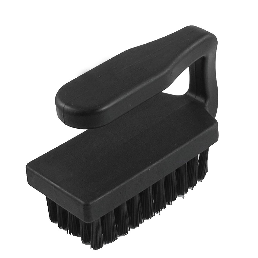

Yikes! Look at the size of this one - 2.8"x1.3" that is one large PCB. We use this for cleaning tub and showers!!

I have used denatured alcohol and acid brush with metal handle as well. It works pretty well, but the hairs are a little to flexible to get some stubborn flux off. The link provided has some really good solution if the bristles are stiffer.
