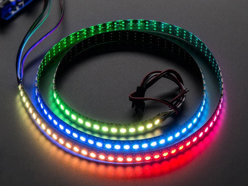

I’m having problems with illuminating more than 31 addressable LEDs.
The above code has numPix=16.
I have changed it to 4 and 8 with no problems. 16 to 24 without issues too. But it’s stuck at 31. I can parallel more strips and even two 8x8 matrix with only 31 illuminating on each.
At first, I thought it was my power supply 9V 1.5A.
So tried another external power supply for the LEDs 5V 6A. Same problem. I then injected voltage at the last strip to no avail.
I’m not sure what is causing this issue.
Any help would be appreciated.
PS, I am using arduino nano clone.

Harald Kapp
Nov 17, 2011
14,317
Nov 17, 2011
14,317
The Github repository for the Adafruit_Neopixel library lists the compatible controllers. The Arduino Nano is not (officially) among them.
However, the library basically seems to work - at least up to 31 pixels in your case.
C++:
    ledStrip.fill(color, 8, 4);
    ledStrip.show();
    delay(random(flashOffsetMin, flashOffsetMax));
    ledStrip.fill(color, 4, 4);
    ledStrip.show();
    ledStrip.fill(color, 9, 14);
In this section of code you fill different sections of the LED strip with color, but only up to LED #23 (last instruction, start at 9, fill 14). Did you update these numbers when changing the number of pixels?

No I didn’t. I didn’t understand that section of code.
This evening I will //comment them and see exactly what they do. Afterwards I’ll play with the numbers.

Here's a more detailed explanation. Note: from my interpretation of the Neopixel library only. Untested.
If you comment this section in your code, the LEDs will show nothing.
C++:
ledStrip.fill(color, 8, 4); //fill the buffer for LEDs 8,9,10 and 11 (start with 8, then fill 4 LEDs) with "color"
ledStrip.show();                                //output the buffer to the LED strip
ledStrip.fill(color, 4, 4);                    //fill the buffer for LEDs 4, 5, 6 and 7 (start with 4, then fill 4 LEDs) with "color"
ledStrip.fill(color, 9, 14);     //fill the buffer for LEDs 9 ... 23 (start with 9, then fill 14 LEDs) with "color"
