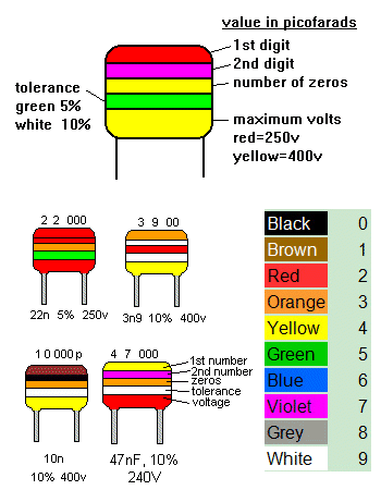

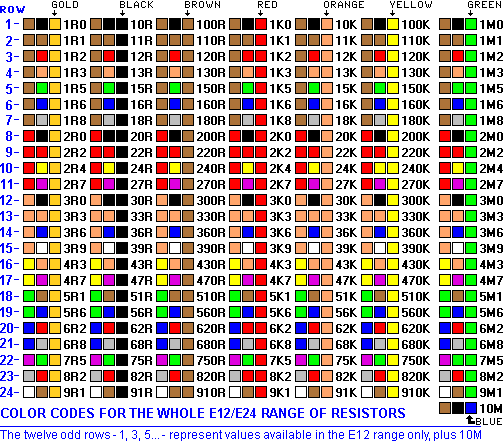

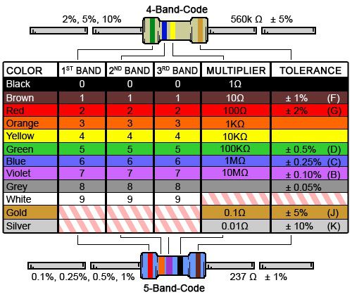

Resistor Colour Codes
Capacitor Colour Codes

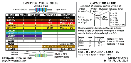

Inductor Colour Codes
Capacitor Marking Codes

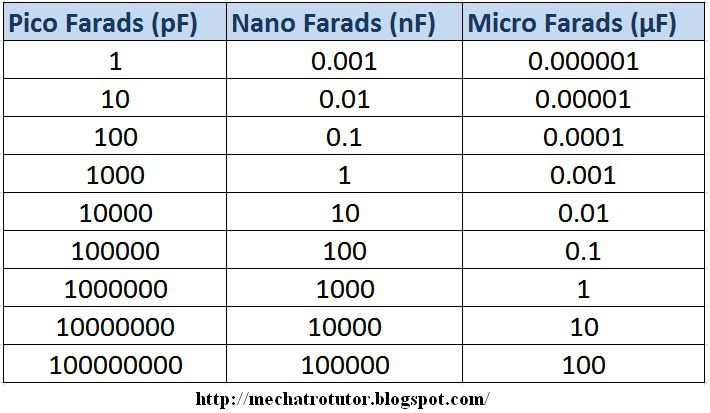

Capacitor Value conversion

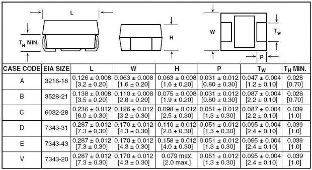

Surface Mount Tantalum Capacitor Case Codes

It might be useful to add inductor colour codes too.
(*steve*)
¡sǝpodᴉʇuɐ ǝɥʇ ɹɐǝɥd
Jan 21, 2010
25,510
Jan 21, 2010
25,510
you're right, I must have scrolled right past it.
