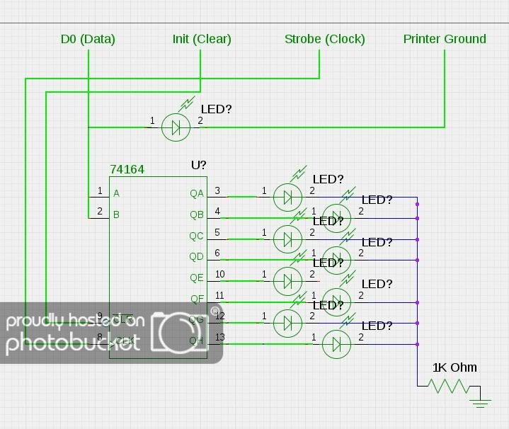

Hello,
I'm working on a project and hoping to expand my basic understanding of electronics. I've written a program that interfaces with the printer port. I can send a byte to the data lines, and change some of the control registers around. I used a breadboard with some led's to verify and test the logic.
My next step was to hook this up to an 8 bit shift register (SN74HC164N), and drive some led's. Understand that the shift registers cannot drive a lot of current, so I hooked the 8 led's up in parallel and tied them to ground with a 1k ohm resistor. I wired up the clock and clear pins to the strobe and init lines of the parallel port. Lastly I combined the A & B inputs on the shift register with the D0 data line.
I wrote a small program that would set the clear pin high, while sending data to D0 and cycling the clock on and off. Unfortunately the results were not as expected.
the output led's from the shift register all cycle on and off. I was expecting them to cascade as data was shifted down to each paralell output. I'm a bit stumpted at the moment. It's basically flip flopping all 8 led's.
The data I'm sending through is a series of 1's and 0's. Sometimes I'll pass just 0 through and it still cycles. I'm not sure if the shift register is bad or if I wired the circuit wrong. I tried from scratch twice and still got the same results.
Lastly I tried skipping the parallel port altogether and tested the shift registers with three momentary pushbuttons simulating data, clock and clear. This got really interesting because the led's would seem to light up any time my fingers got near the shift register or the data / clock jumpers. It seemed to be picking up static electricity or capacitance from my hands? I found that annoying. When I tried to manually use the shift register the LED's would blink in an irregular sequence.. differently from the computer driving it, but not in an expected manner.
Any suggestions on how to troubleshoot would be appreciated. The circuit is pretty simple but I can attach a diagram if needed. Ultimately I'm not looking to drive LED's but I wanted to test with them.
This makes it sound like you hooked them all up to one output of the shift register, this is wrong I believe. Do you have a schematic of how you wired it? Or even a picture clearly of the breadboard?

Sure, here's a schematic showing what the design looks like. VCC and ground on the SN74HC164N are wired to an external 5v power supply.
I tried changing the D0 and D0 (data LED) lines around a bit. First I got rid of the LED, then I tried tying A high and wiring D0 directly to B, but none of these changes seemed to affect the behavior of the circuit.

Some quick thoughts about this project:
The parallel printer port ( "Centronics"), uses TTL logic levels. Newer ones may put out 5V CMOS logic levels, which still work well with the older TTL parts. There is nothing RS232 about this port. Woodworker82 is creating a serial bit stream in software and applying it to one bit of the parallel data at the printer port. The computer port signals are already what he needs for the 74164. No logic level conversion required.
There is a slight chance that older parallel port hardware might work better driving an HC part, if some pull-up resistors are added to +5V. 4.7k might work well. If you can look at the signals with a scope, you can see if you have logic levels that match the needs of the chip you are driving.
You might want to use a shift register with an output latch, so first a new pattern can be shifted in, then all the outputs changed at once. I think the 74HC595 already suggested does this.
An ordinary red LED connected from a TTL logic line to ground will prevent the line going high enough for a good logic 1. The LED? on the D0 line may cause trouble. Two in series might be OK, though.
The 74164 shown on the schematic is a TTL part. The outputs sink far more current than they source. So your LEDs need to be turned the other way round, with the cathodes toward the chip. A 74HC164 has symmetrical output drive, but lower than the TTL part's sink current. We see 5.2 mA output currents on the data sheet for the HC part.
Unless only one LED is to be on at once, each will need its own resistor. About 560 or 680 ohm value would light up your LEDs a little better.
The schematic does not show a connection between the computer ground and the 74164 circuit ground.
The IBM PC style printer port has fairly confusing control line logic. Some signals are inverted by the hardware, some are not. I don't have time now to find a reference document for this; there must be one online somewhere. Be sure you are feeding the intended polarity signal to the CLK and CLR pins.
Another consideration is what happens when the computer is powered-up, and what happens when Windows boots. Some of the control lines go up and down during these activities. You may need to add hardware to prevent bad things happening. You will need to observe what your particular system does as it starts.

I rewired the manual switch inputs for the shift register circuit. The last time I had left the clock disconnected when unswitched instead of low as it should have been. After fixing this mistake I was able to confirm the line level logic works fine (the power supply is 5 volts). The random capacitance noise does not occur if the reset and clock lines are properly switched/tied high or low.
I read Ted's repsonse and noticed that I indeed had not tied the ground on the parallel cable to the power supply. Once I did this the shift register was functioning properly from the printer port.
