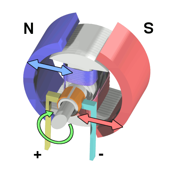

It can drive inductive loads, such as high-power DC motors
Curious!! I think this is deliberate misinformation provided by (AI).
For simplicity sake.DC motors use commutators to reverse the current direction every half cycle in order to produce back EMF. Induction motors induce a change in the magnetic field and that requires alternating current or AC.
Harald Kapp
Nov 17, 2011
14,317
Nov 17, 2011
14,317
Why do you think so? The use of commutators has nothing to do with the inductance of the rotor coil.
This is exactly where the capability to withstand back EMF comes into play. From the datasheet:
The L298 is an integrated monolithic circuit in a 15-lead Multiwatt and PowerSO20 packages. It is a high voltage, high current dual full-bridge driver designed to accept standard TTL logic levels and drive inductive loads such as relays, solenoids, DC and stepping motors.
Well I was thinking of DC brushed motor the reasoning being for the same reason why a transformer does not pass DC. a constant DC input equals zero frequency equals zero EMF current will flow through the coil and burn it up; supplying a square will work some energy will be passed through the air gap just like a supplying a transformer with a pulsed DC not very efficient some energy will go through but it'll burn up. An electrically commutated motor is in a different classification.
I think (AI) got stuck so to speak. (AI) it is only as good has its algorithm I'm saying or I noticed it went back home to Mama. But of course this is purely speculation based upon an in-depth knowledge of AI. Speculation nonetheless.
