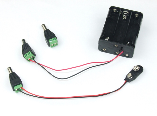

Hi,
I had taken an electronics common core course about 13 years ago. Lately, I have been wanting to get back into learning, as I have some free time due to the "planned-demic".
Anyway, over the years, I have needed to replace my 9V battery for my multimeter, about every 3 years or so. Not happy about it, considering how long I've actually used the multimeter, during a 3 year period.
I would like to buy this adapter (AC/DC Adapter - 9VDC 0.6A) and splice the end with a 9v batter terminal adapter:
https://www.rpelectronics.com/rpr-09600-p5-ac-dc-adapter-9vdc-0-6a.html
Is this ok, or should I be weary of anything? I really don't want to start any fires. Any insight is greatly appreciated.

Should be ok.
If you use an adaptor, you could avoid the need to splice anything.
Get one the size to fit your power adaptor plug.
Just watch and test polarity "before" plugging in.

Ty for your response.
That part would be cool, does it have a specific name? I can't seem to locate it with my searches (power adapter adapter?!?).
EDIT:
Ok, I tineye'd the photo you uploaded and found out it is called 'Female DC Power adapter - 2.1mm jack to screw terminal block' (size may vary).

I'm astonished that replacing a battery every 3 years causes you problems.
If I were you, I wouldn't cut any wires to the meter.
Instead, make a 'fly lead' from the DC female jack and the connector from the 9V battery. (the battery itself).
Cut the battery connector away from the battery and join it to the DC connector. Bottom example in picture below.
Now you can use the battery when away from the bench and the mains adapter when at the bench.
Best of both worlds.. A DIY battery eliminator.. Or buy the lead already made..
