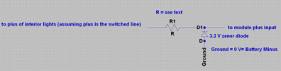

2: buy a relay module like this one. It will work from 3.3 V onwards. To limit the input current add a resistor and a zener diode:
The ad doesn't state the input current of this module, but typically 5 mA i a good assumption. R needs to be designed to supply 5 mA at 3.3 V with a max. voltage drop of 0.5 V (a ballpark figure, may need some experiments to get a better value). Therefore R = 0.5 V / 5 mA = 100 Ohm.
At 12 V, this resistor will dissipate some power: P = (12V - 3.3V)2/100 Ohm = 1.3 W.
3: One could design a constant current source to drive the relay regardless of the control voltage, but that requires more design effort.
The simplest solution is imho #2.

Right, that's why I added a resistor and zener diode to limit the input voltage to ~ 3V.
What I didn't recognize is that the module needs an additional Vcc input of 3.3 V. You are absolutely right that this will not work on 12 V.
I beg to excuse my oversight.
