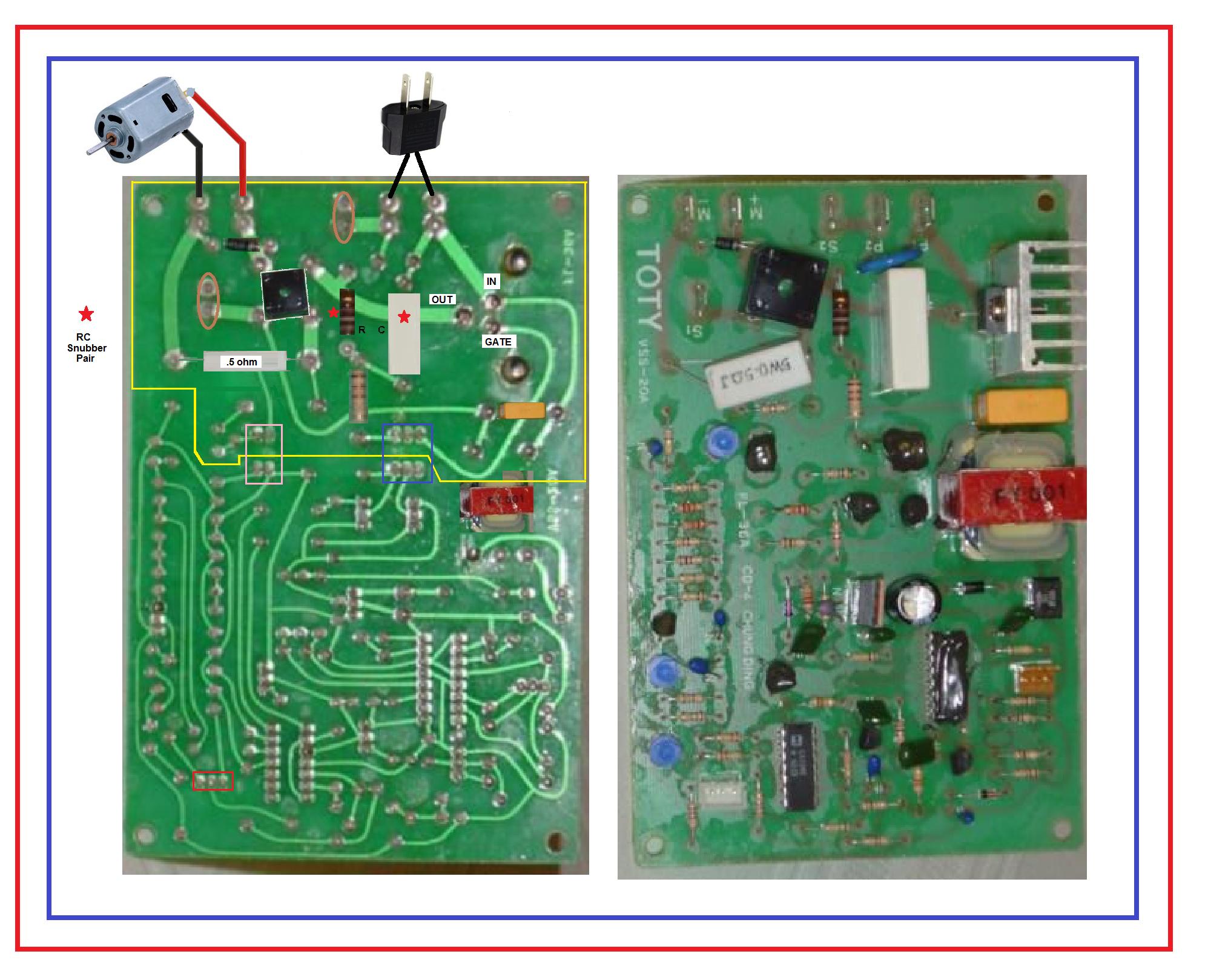

Hi guys, I have scroll saw that had variable speed now it only operates on high rpm.
The switch is ok.
Is there something specific I should be looking at testing on the board?
I checked the triac and it's good.
Thanks.
Kevin.

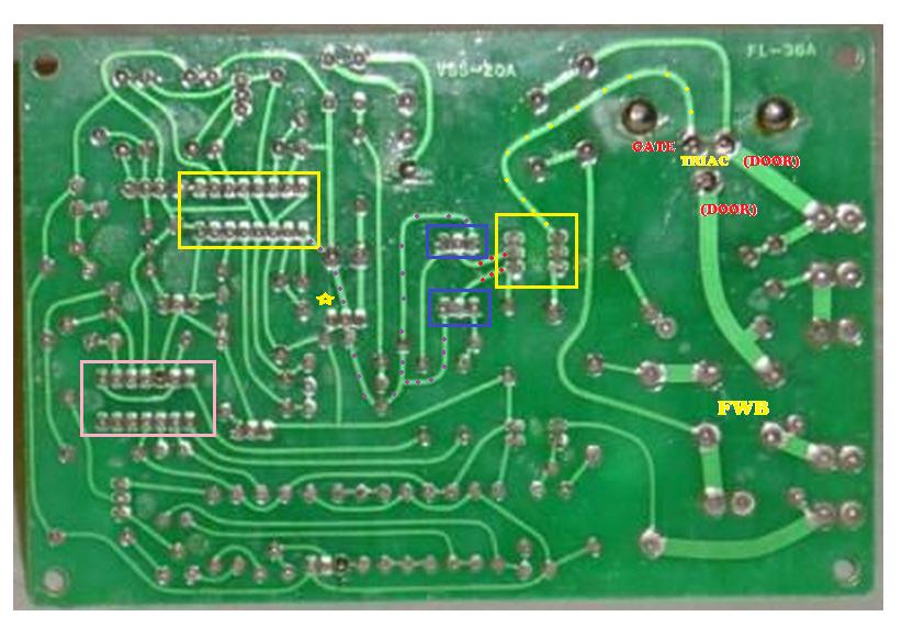

Sir KTW . . . . .
Use velly-velly Bright light and MAGNIFIER, check VEWY-VEWY cwosely (a la Elmer Fudd ) for dry or floating soldered component connections.
Looks like there is LIBERAL use of piles of "black pookie" to seal adjustments , hide components and keep their PROPRIETARY secrets of components . . . by the most honnable . . . . Chung Ding Co.
Looks like you might be able to provide us the ID on the run of the mill Eye Cee within the PINK outline.
My small right YELLOW boxed component will probably be an Opo-to-trif-o-cal Isolater-er-er, if you can dig thru all the pookie on its top.
The BLUE boxed items will probably be vertically mounted trimpots, for setting the threshold ranges into the O.I.'s activating diode/emitter.
Is the item just Southeast of the JELLO star being another vertically mounted trimpot or a TO-220 cased semi ?
Take metering in hand and check across my two marked connections up the RED DOT path from the two trim pots to the input of the O.I. to see . . . IF . . . there is being a voltage change/transition when you power up and try speed changes.
Then move to the O.I.'s secondary and read across that portion as AC. It then follows the YELLOW DOT road up to the TRIACS gate. Does that vary, if the primary was varying ?
Looks like the initiation of drive might actually originate at the corner pin of the 16 pin LARGE YELLOW BOX ENCLOSURE via the PURPLE DOT path.
Any chance you will able to reveal its top numbering ID , unless it has been wet and dry . . . sanded OFF.
Plus . . . . . did you lift the gate in the testing of the TRIAC ?
I stand by now, while you get your hands, fingers and clothes VEWY-VEWY dirty.
324E amplifier
Heavily pookied but I'll see what I can do.
They pookie these components then discontinue the controller.
These look like transistors.
AN7805 voltage regulator.
This is how I tested the triac

In accordance with the Chenglish writings of Dr. Edd above, likely point(s) of failure are triac and/or optocoupler.

I powered it up and I have 120volts from the triac and everything along the red and violet dotted lines remain a constant 5.1 volts over to the optocoupler, if that's what it is.
There is no change in voltage when turning the switch.

Sir KTW . . . . . . .
Am I catching some Philippines tagalog dialog . . . . but with it still having its all CRITICAL "open" and "good" "bad," being in Englee . . . . and coming thru.
One caveat that is relevant to this mode of testing, is that he is using an old school analog meter PLUS his ohms function is being switched just enough upwards
in that mode, such, that the HIGHER internal battery voltage is being used.
He finds one unit which has totally crashed from MT1-MT2, another which has a non responding GATE and the third one is being good.
However, the testing procedure, is being dependent of the polarity of the leads and the bridging of one MT terminal to the GATE to fully turn on the unit,
from its MT1 to MT2.
Did your testing FULLY fulfill those parameters ?
I did not see that you fed back testing info as to your voltage measuring on the input(left) side of the 6 pin optical isolator and its right AC side, that couples in GATE drive.
The OI's left side should reflect a voltage change, as the speed adjustment is varied from min to max.
I would test that triac by solder sucking ALL solder from either the solder land AT the triacs gate or BACK at its feed point at the pin at the OI.
Do a very VERY light touch probing between the gate terminal and its now supposedly "floating land" that t WAS soldered to for CONFIRMED open circuit.
Then test to see if the motor is not running.
By the way I APPLAUD your info and answering technique of cutting relevant snippets and answering them just below.
That way nothing is overlooked ('cept the non forthcoming info on the OI voltages and their variance or no variance with adjustments).
Your valuable info defines the "pink" IC as being a quad op amp . . .or how you clazee Amellicans say . . . a four section operation amplifier
that can operate from a single ended supply.
The left, also YELLOW enclosed item, is NOT an optical isolator, only the right YELLOW enclosed item is the units sole OI.
Your feed back on the JELLO starred TO-220 cased unit and with a 7805 having a center terminal grounding now makes the PURPLE DOT
path be a ground buss.
One grounding path is upwards to the YELLOW IC, it grounds that corner pin, on its path to the right, it branches apart and provides emitter grounding of the
two OI bi polar driver xstrs (BLUE BOXES).
BTW can you determine , underneath the pookie, are those being just common sized TO-92 cased plastic xstrs ? Or . .unjustifiably ! . . some
big ole TO-220 encased units ?
Their collectors then feed the RED DOT path to the OI's internal emitter diode.
The 2 xstrs bases copper traces drop straight down to a set of series current limiting/isolation resistors and their drive is being received fron the LM324 at
the two foil paths entering at its right bottom corner.
Question:
On the PINK IC, top right corner, third pin to the left .
And referencing with my JELLO star, drop straight down the board to the almost bottom and see the one shiny pad and notice just beside it to the right.
They look blackened, is this just being optical deteris, or did some QC go-go girl mark them with a black Sharpie, after an initial inspection after the production lines
board flow soldering.
She then sent them to a rework station for solder touch up, then the BLACK markings was her final inspections mark of approval/and evidence.
Question probably already answered . . .
On the "BLACK POOKIE" . . .I was expecting all the way from BLACK silicone rubber blobs, actual blobs of tar or your hardest for removal, being the rock hard Jay Bee Weld Epoxy.
I am on laptop now, ripping off at a blazing 100 wpm + (so there may be errata). . . . when I get back to home base, I can use a 42 in monitor to overlay and place the boards F&B sides side by side.
PLUS I will amend the drawing to current circuit finds.
Recolor the left IC's outline (NOT another OI)
Can you pass on the average resistor values clustered around and in and outing from that units pins.
High ohmmic resistor values versus lower ones would differentiate between it being CMOS versus TTL family.
Also check pins for the highest DC voltage on a terminal.
I am suspecting this IC to be the "pulse width brains" for the unit, to feed into the 324, which we also already see as fulfilling predriver functions with two of its sections.
Can you find the speed controller pot and find its center rotor terminal, and see how it indirectly connects (via resistor) into a pin of the mystery IC .
I am suspecting , pending further facts, for that ? IC unit to be circuit configured as a dual series schmitt triggered function.
( My gut feeling . . . .I still tinks youse done gots yerselfs a " buggy/leaky " gate on the Triac)
Back later with amended drawing . . . but still in need of any of your research findings.

I'm pulling out my redraw of the pcb with its foil side and the component side to its right . . . . . and that was being at the ready months ago.
I transferred a couple of components across the board, for referencing as a visual overlay, in comparison of the foil side .
Boards Initial . . . . POINTS OF INTEREST:
At the very top of the board are the AC power input and the jig saws universal motor.
The YELLOW line bordering is indicating the AC power line “ HOT “ portion of the board, while the lower portion of the board is AC
line isolated, by use of the RED power transformer.
The BLUE rectangle is the drive signal optical isolator which feeds the gate of the POWER control semi mounted on the heat sink.
Its bottom half contains the driven LED while the top half contains the photo detection portion.
To the left is a smaller rectangular PINK 4 pin optical isolator.
