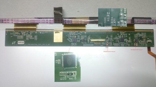

i have picture but no back light , like the brightness of the screen is set to 1 or 0
i upload the picture
i found 3 capacitors that both sides are shorted to ground ...when i removed from the board i test it and it was working fine giving me 4+ for capacitors measure...but it's place on the board both sides are still shorted to the ground.
the B1 and B4 both sides are shorted to each other but not to the ground. dunno if it's fuse or what
any idea what would be the failure that cause the shorted of capacitor's connectors to the ground

Another component parallel to the capacitors.
That component could be e.g. a zener diode (used for overvoltage protection), a rectifier diode from a switch mode regulator, the lighting fixture itself.

that made sense
on the picture could you show me what or where to check and how to define smd zener and smd rectifier diode

**** How many brands of laptops are there X( TIMES)X How many different models of laptops are there X (TIMES) X how many different years have they been made . . . . . and you expect us to work with what is probably only the units unpopulated / raw circuit board number of . . . LTN140KT04_201_V0_1 HF visible .
And maybe ? a fancy LG logo to the left .
Come on now . . . . .! . . . . . with decent information forthcoming.
Especially BRAND and MODEL . . . .
**** Closest estimation . . . .97,613 ± 2 %.
Working . . . . . totally in the blind . . . .
Looks like power comes in at the bottom right connector as ? CON 10 ?, then passes to the left to a sub power supply with its 24 pin IC1 ? 7 ? and its associated 6.8 uh ringing inductor WHICH should have its associated ultrafast ringing rectifier placed very NEARBY.
So that might be the very close by, BLACK ? D1? just below the IC numbering.
If that is shorted that would account for your RED CIRCLED E filter just below the 6.8 unit reading as being shorted also.
What is its marked capacitance and voltage rating ? . . . . . considering it to be an aluninum mini canned filter mounted on the opposite side of the board.

I then TOOK that ALL important brand and model number and related to all of its manual and an additional 42 pages of schematic connection flow paths .
Ending up at the point where the display was connected into the system.
Guess what ? . . . that whole display is being a drop in from Samsung under that LTN140KT04 number that I initially referred to.
So Dell is providing ZERO info relatable to the display unit. I am now hunting up Samsung info and can initially see that the principal power for the display comes in from a 40 pin connector at the center of the board, which your pic only shows an edge, as being visible .
Your pic shows two sets of ceramic block filter caps being pulled and off the board,which you show in your added RED mark ups.
NOW what you want to do is check across their pads for a short STILL being present and if so, then carefully disconnect the 40 pin connection so that we can then see if the short is ON the display board or OFF in the circuitry associated with the other side of the 40 pin connector.
that's what i exactly did before posting this topic and the short is on the display board
now what i'm really looking for is what other component that might cause that short
i also watched this
and also this one
they test component in diode/continuously mode
but my issue the shorted is in the board not in the capacitor it self
need to find what cause that short

does anyone know what B1,B2,B4 are?
their both sides are shorted to each other but not to the ground. dunno if it's fuse or what

A fuse is usually labeled Fxxx. Bxxx doesn't fit in the standard nomenclature (Where B would be used for a battery).
These could be SMD jumpers (also called bridges, which would explain the "B") or 0 Ω resistors which are often used to configure circuits for different features or chips using one and the same PCB. These measuring 0 Ω would be perfectly fine then.

Look up the chip number for the specs, look for what options are available on those pins and it might give some insight.
Suspect a bridge though as previously quoted.
Photo is out of focus so cannot do here.
davenn
Sep 5, 2009
14,487
Sep 5, 2009
14,487
well figured out that this is the chip number .... LAU5211X08-E1
but I cannot find a datasheet for it :(
