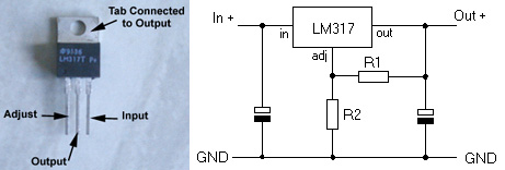

Please Help me understand the Circuit
Ok here in the circuit, we have two CAPS and one end connected to GND, which mean negative terminal of battery, right?
And R2 is again connected to GND. So this means, as per the circuit image, both positive and negative must be connected to these points if I Want to run a LED?

You said earlier that you got it working. So why are you asking this now?
Also, why do you keep ignoring my advice that you want a current regulator and not a voltage regulator to drive LEDs?
I do not understand your question. The LED would go between the ground and the Out+, but you will need a resistor to limit the current if you insist on using a voltage source instead of a current source.
