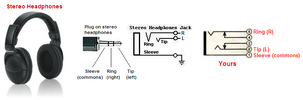

bluesparky
Apr 10, 2009
1
Apr 10, 2009
1
Thanks for the info, Hero.
Sorry, i've got a couple of questions to ask.
Is this the right way to wire the stereo headphone? (Kindly see attachment)
Secondly, there is whining sound when i am using a headphone (with and without the mic attached). When i touched or moved my hand near the potentiometer, the whining sound became softer or disappeared.  Any idea what is the cause for it? (I am testing it on a breadboard)
Thanks, sparky
audioguru2
Apr 6, 2004
12,026
Apr 6, 2004
12,026
Yes.
Short the left and right channels together so both ears play in mono.
The long jumper wires of a breadboard pickup all kinds of interference and might cause the circuit to oscillate.
Use a compact stripboard layout or a compact pcb layout instead.
