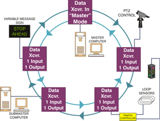

I would look into the various fiber optic network topologies also, they are well
documented and understood and can be summarized in a diagram and a page of text.
I would look into Mil-Std-1553 data bus for communications and it's fiber optic cousin
Mil-Std-1773. Another keyword for review would be FDDI (Fiber Distributed Data
Interface.

Self-healing Ring Topology ..........................................................................Star Network Topology ........................................Bus Network with Backbone
