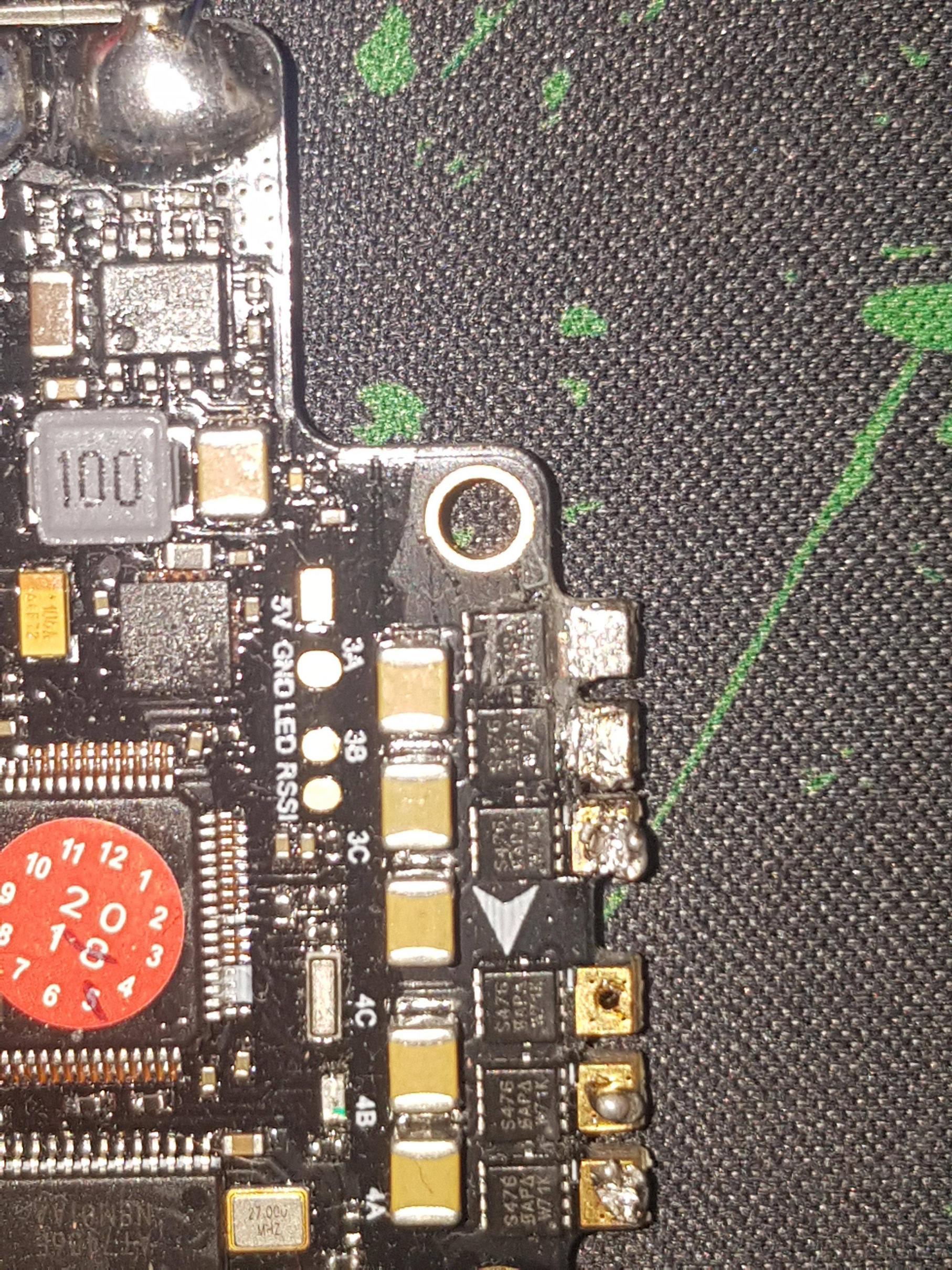

Im new here so hey guys first of all.
Ive been working lately on building a quadcopter, with unfortunatly ended up with 2 ruined mosfets.
Now im trying to find an equivalent fets that will go with my flight controller and im not really sure about what specs i should regard to
This is the datasheet for my ruined fets:
https://www.google.com/url?sa=t&sou...FjAAegQIAxAB&usg=AOvVaw0R8PWy9m7YrUYh1PHnavat
Model is sis476dn
If anyone can please help me ill be thankful, have a nice day

Hey thanks for replying, I havnt seen the smoke actually, i ruind them by soldering and shortening their legs by mistake and improffesionality.
Ill deffinatly try to use some flux and save them but i wanted to have some extra just in case.
Basically those are connected to my drone's motors and they sit on the flight controller.
The problem is that i live in Israel and shipping from those sites you mentioned will cost me 100$, so i thought on buying fets that can fit properlly but i dont know what specs to look at.
Is the only options is to buy the same model?
There is a pic of the fets what do you think?

These MOSFETs have extremely low RDS(on) resistance at reasonable Vgs drive levels. Take a look at this DigiKey link for some possible substitutions with different VDS(max) and ID(max) specifications. Note that DigiKey offers FREE shipping to Israel for orders totaling more than $100... presumably that's US dollars. You might want to budget a couple hundred dollars for replacements and/or substitutes. Or try surfing the Asian market (AliBaba, etc.) sellers, but beware that there are a lot of counterfeit devices being sold there... caveat emptor.

Hey hevans and thanks again for your detailed and helpful reply.
Unfortunatly couple hundred are way beyond my budget (poor engineering student lol) as a new controller would probably cost me around 60$ and I can keep mine for replacement.
but I was searching at the Asian market as you mentioned and i actually found the same model on ebay:
https://rover.ebay.com/rover/0/0/0?mpre=https://www.ebay.com/ulk/itm/192833548552
Although it says unbranded specs and model are same as mine, also total price for 5 pcs is quoted for around 10$ which is not bad so I might go with this one.
Just for some general knowledge and curiosity, did you linked those fets based only for the fact that they are low resistance on the ds junction?
Does it mean it allows more current flow?
And why Vds and Id do not have to be exactly same value? Are those just limits?

Yeah, at that price I would take the risk, for a buy of a few of them, that they are in fact "the real deal" and will work as advertised. But they are probably "clones," perhaps counterfeits if not licensed to be manufactured by a foreign fab, but not likely not. Wouldn't matter to me, if I were to purchase for hobby use, as long as they worked to specification. Not everything manufactured in China is junk parts with zero quality control, but you can only find that out by trial and error buying.

I ran across that linked page by accident. I was searching for something else, but forget exactly what my search string was and that page popped up. I didn't want to confuse you, but this looked like a reasonable selection to pick from, all the same series from the same manufacturer. That way you get to compare apples to apples and oranges to oranges.
And, yes, I was looking for MOSFETs with very low RDS(on). This is a parameter that it is absolutely essential to minimize for quadcopter and other battery-operated brushless DC motor applications. Lower RDS(on) does mean more current flow is allowed. And, just so you know, there is no such thing as a "ds junction" in a MOSFET. There is a parasitic "body diode" present in every MOSFET manufactured, but it is an inescapable consequence of how the MOSFET is made. Suggest you Google this to come up to speed. This body diode is often used in lieu of an external diode to help suppress back emf generated from collapsing magnetic fields in motors.
... And why Vds and Id do not have to be exactly same value? Are those just limits? ...
VDS(max) and ID(max) cannot ever be exactly the same value because they are measurements of two different things. VDS(max) is the maximum voltage you can apply between the drain and source of a MOSFET without electrical breakdown occurring, leading usually to instant "death" of the device. ID(max) is the maximum current you can draw through the drain terminal from the source terminal. This produces heating in the conduction channel equal to ID2 multiplied by RDS(on). The MOSFET usually fails slowly as the current approaches the maximum, and may recover and operate normally if the current in the conduction channel is reduced.
I try to avoid operating semiconductor devices close to the their published maximum values for any parameter. The hassle of replacing a damaged part, and whatever else it took with it to the grave, requires way more time to troubleshoot, find, replace, and test the repair than the cost of the part... usually. I don't want to have to go through that process more than once because the replacement part was in any way marginal in its performance, and itself required replacement. However, "basket cases" either go directly to the re-cycle bin or are returned, un-diagnosed and un-repaired, to the customer.
