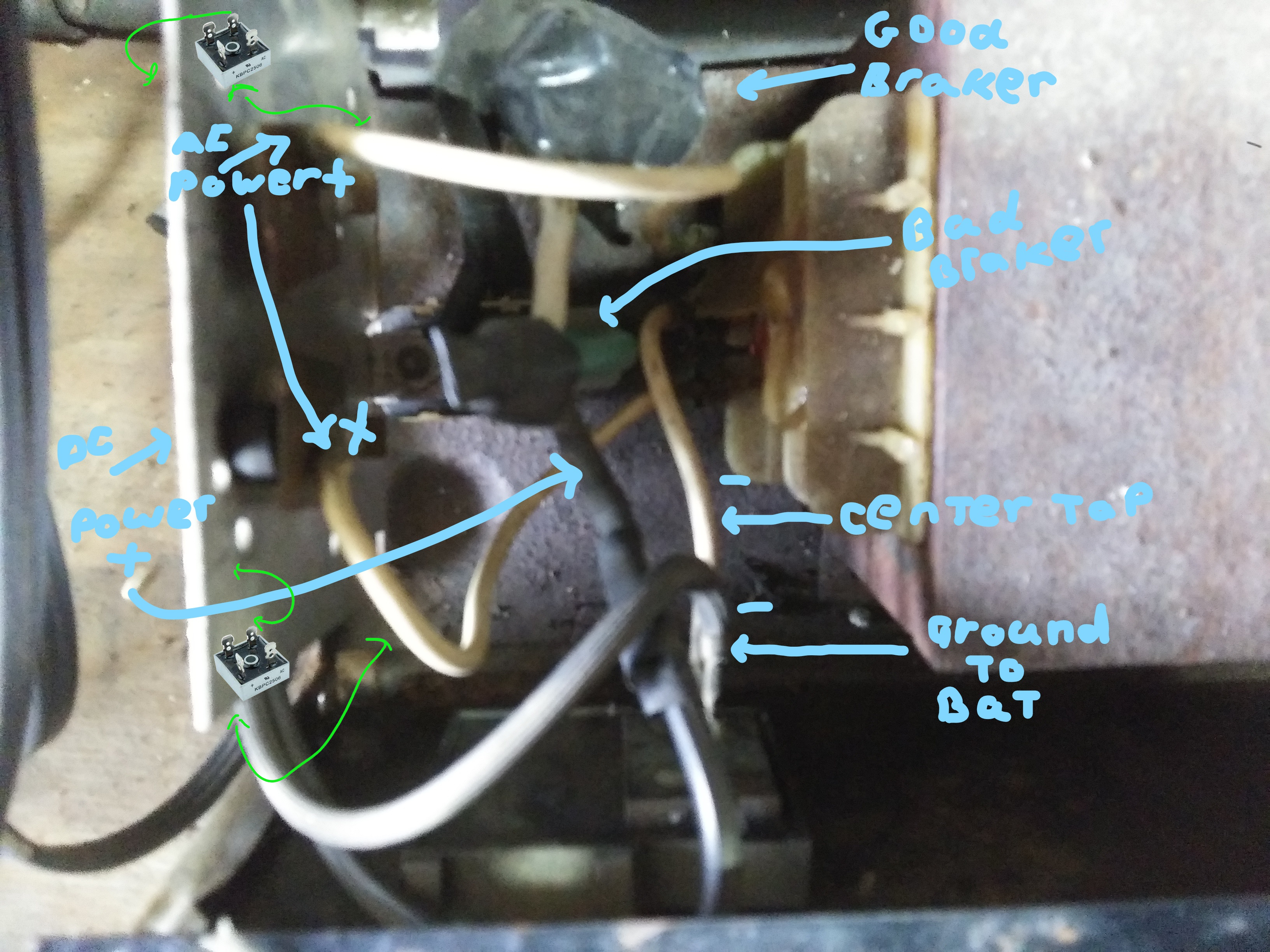

OK I just received my two 50A 1000V Metal Case Single Phases Diode Bridge Rectifier KBPC5010SNHV hm
Now I need to figure out how to hook them up. I was thinking plus to one of the hot wires on the transformer and the ac- to the plate and not use the two dc but I don't no if that is right
The transformer has two power wires and a ground. I am guessing that is a center tap.the center wire goes to the amp gauge then the other side of the gauge is where the ground
wire with clamp is connected. I attached a picture showing what I was thinking of doing

The 2 AC points are the input to the rectifier. '+' and '-' are the output:
Your picture is not clear enough to see all the connections. Try to draw a diagram of the connections and componnets.

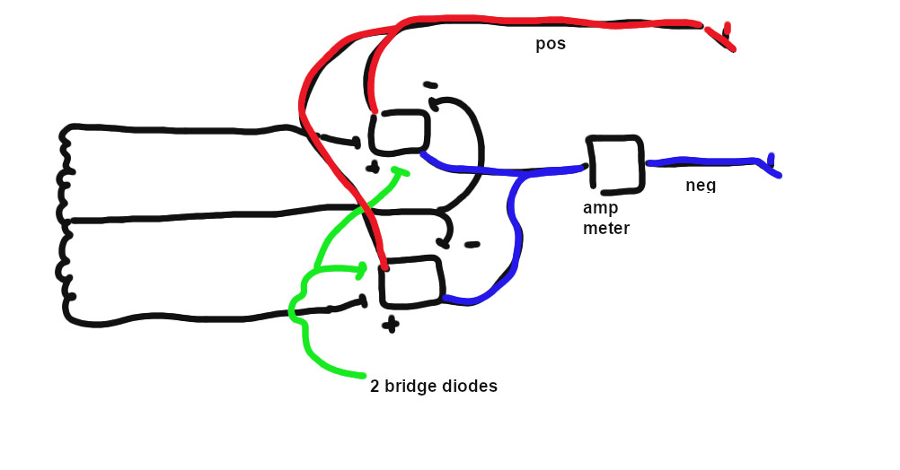

chipdj
May 29, 2021
12
May 29, 2021
12

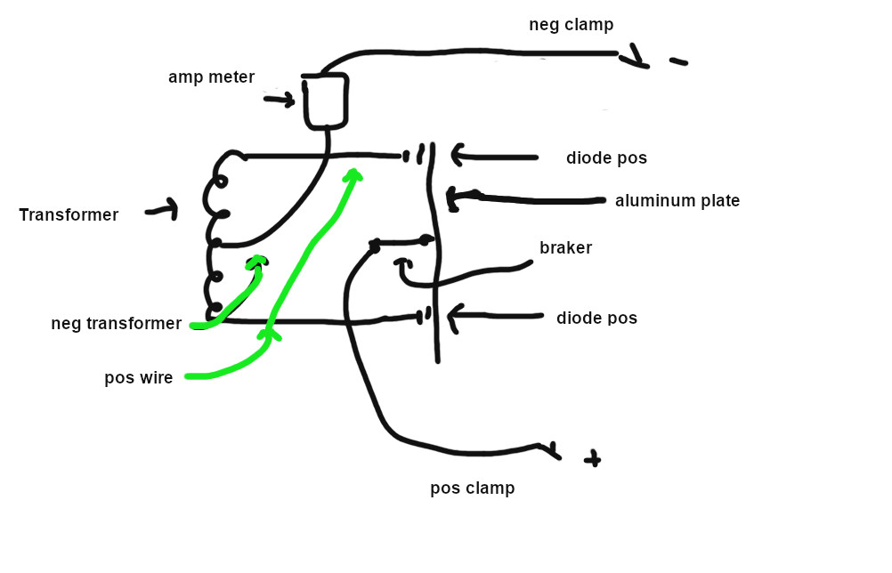

How is this? Bad I no! the diodes are bad I want to change it to bridge rectifier. so would I connect the neg trans

Hello,
If you want to have a similar arangement as in the old situation, use half the bridge:

OK so ac pos out lines to d1 and d2 and should I use the dc pos out for the pos dc? d3
Huh? Sorry, I do not understand what you ean here.
D1...D4 are only placeholders for the diodes within the bridge rectifier. What you see on the retifer is the symbols
1 × '+'
1 × '-'
2 × '~'
You connect the two outer wires from the transformer to the two inputs of the rectifier labeled '~'. Connect the output labeled '+' to the charger. This will be your DC output. Leave the output labled '-' unused.
Just as @bertus has shown in his modification of my schematic.

Hello,
As @Harald Kapp said, the pins have symbols next to them.
( I see them printed on the side of the rectifier ).
The ~ pins are in inputs from the transformer.
The + pin is the positive output.
The - pin is not used.
Bertus
