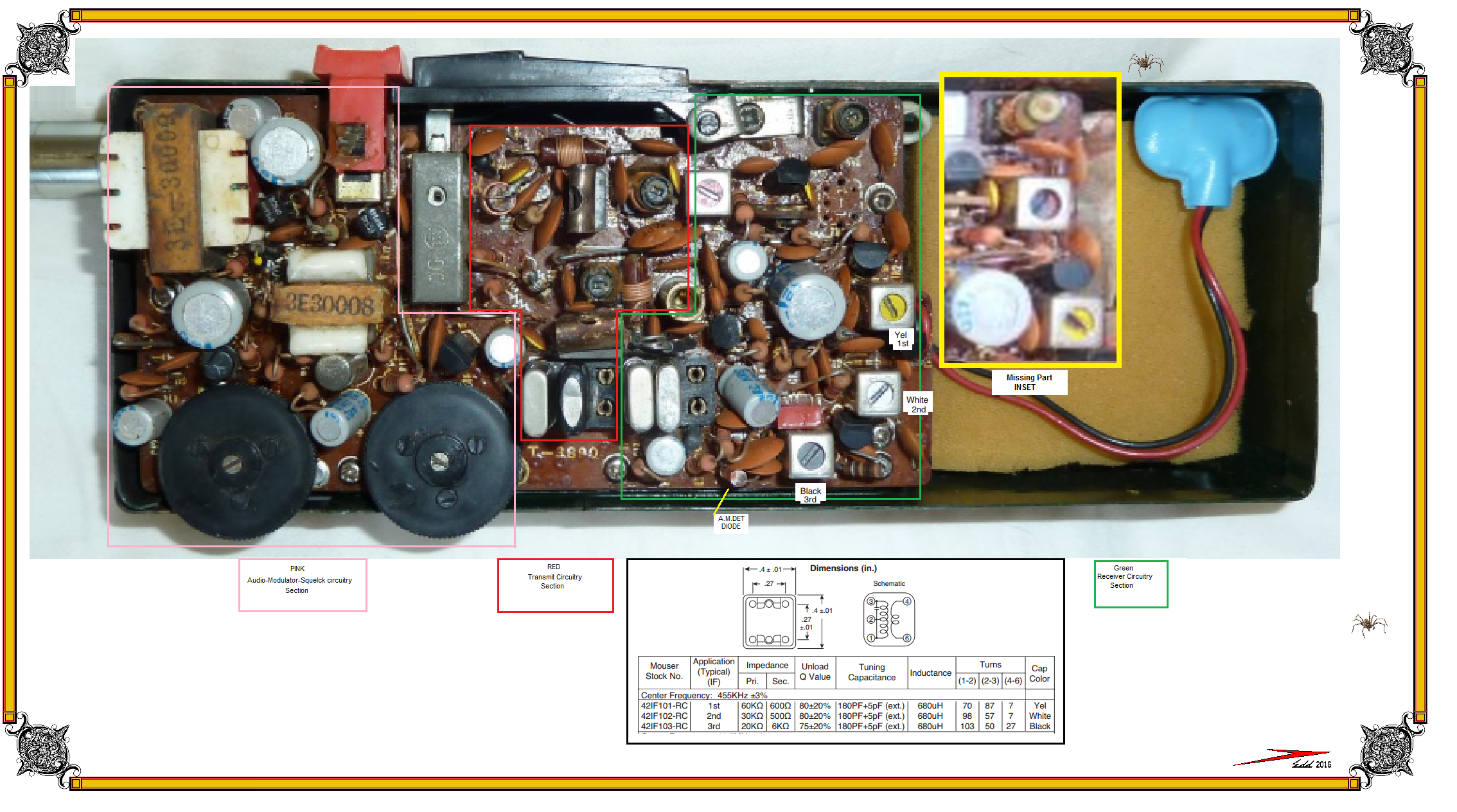

Hope someone here can help me out on fixing this old two way radio I have. It is a Midland 13-723.
One of the variable filter coils needs replacing. On the metal housing it says 450 something blue colour. The rest is smeared out. There are other similar coils on the pcb with different colours(yellow, black, white, pink). Most of them I am able to read what is written on the housing and they say
2E
480(1 or l or I)
3DCT
They are from Mitsumi.
I have tried to find schematics but couldnt. I have contacted Midland, but they just say that this is a unit that they no longer sell and cant support.
I cant find any blue mitsumi coils and I am not sure if the colour even matters.
Does the 480(1 or l or I) mean frequency?

Here they are

Sir ATA . . . . . . .
You got answers . . . I got some GOOD questions . . . . . in order to fine tune my design analysis.
Is / was there ever a CB band in Denmark ?
What is the significance of this unit ?
Is it nostalgic to you, or once a possession of a passed on relative ?
Or possibly, you are being a collector of old electronics . . .as this one dates to being back from the seventies.
Are you familiar enough with electronics and repair to be able to handle the job / repair ?
Do you have a companion unit . . as they are used in pairs.
OR . . .in reality . . . . are you equipped with a receiver that can receive the CB / AM radio spectrum up around 26-27 Mhz ?
I just took an initial cursory look and gave you an analysis of the photo which you supplied, along with the
Edd-u-cation, being supplied just below.
My immediate thought was that the "absentee" was being a dirt common 455 IF transformer from that era.
Then I see that ALL three are being present . . .see my markup . . . by their layout path on the PCB and their VERY COMMON casing / slug color coding.
The top right corner of the board is looking to be the converter area of the receiver.
That would be where 27 Mhz incoming signal is converted down to a replicating signal, but being at 455 Khz . . . . or possibly they double converted down to an intermediate 1750Khz and then converted on down to 455.
This is just a 3 channel crystal controlled unit .
There are capabilities of 3 transmit crystals to the left and 3 receiver crystals to the right for the 6 sockets.
If you pass me the frequencies marked on all of the crystals, I might THEN be able to then confirm the receiver portions single/ versus/ double conversion design quandry.
The marked up PINK audio-modulator and squelch area should not be of interest to us now.

One more thing. I n have discovered that transistor C1018 next to the pink coil is getting really hot.
My resolution of the "blowup" of the photo is not definitively letting me pick out the "pink" coil
/ or / coil shield / or / even adjustment slug.
BUT I think that I certainly am seeing TWO of those 2SC1018 transistors being utilized in your unit .
In the RED LINED transmit section, there are two axial coils . . .probably serving as RF chokes and 3 RF coils that are arranged in a triad.
With my educated guess, that the top left unit might show a splash of PINK on it.
The power output 2SC1018 is at the top and between that RF output tank coil to the top left corner and the other right top corner coil is the tuned circuit feeding that transistors base.
At the area just above the crystal bank, we are seeing the other 2SC1018 used as the driver of that just mentioned RF power output 2SC1018.
It seems like, in consideration of limiting the sticking up of the heat sink tab, that they reformed and coiled the tab up into a circle to limit its vertical extension profile.
This case uses a TO-202 profile with the somewhat thin heat sink tab coming out of the side of the plastic case.
One might compare it to a TO-220 case . . . . but you would never form one of those THICKER TO-220 tabs, in the manner such as these have been.
As for the heating of the final transistor , I HEAVILY suspect that is probably due to 40 + year old electrolytics and, in this specific case, PARTICULARLY the last one that is on the DC supply line that feeds the RF final transistor .
It is not properly bypassing and the RF final transistor is being over stressed due to that condition..

Behold all of your relevant repair data for that unit , plus I added the E-cap page, in consideration of all of the the old ones in that unit.
As making that the very final feat.
If being my unit to repair, I would be using this transformer . . . as Midland specifies L3 to be peaked at 27.085 . . basically midband. . . and this unit can swing from 25-30 mhz.
http://www.ebay.ie/itm/TOKO-MKXCS-K...553151?hash=item2a6951297f:g:DN8AAOxyrx5TlfQb
Otherwise, you would be having to find yourself a 10.7 Mhz 3rd IF transformer and be taking off about 2/3 of its turns to resonate on up to 27 Mhz.
