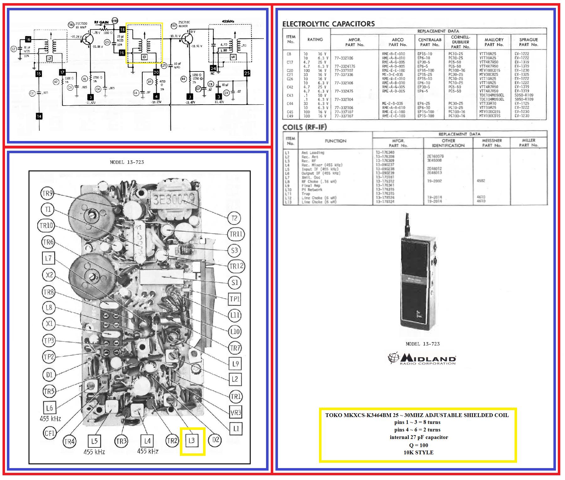

Finally the coil arrived. It is too big to fit but extended the legs and got it fitted on the board. Well, Allthrough the volume is turned way up, I can only slightly hear a transmitted signal. But ok, it's there.
The big problem is that when transmitting it is creating a very loud and schrilling noise along with the speak.
There was no problet at all before the coil was inserted. So why is this coil affecting the trnasmitting signal?
p1030690-jpg.26790
You can see the involved feed thru holes of the transformer.
Three associated with the primary and two associated with the secondary.
Now refer to post # 19's schematic.
You can see TR1 27Mhz RF amplifier and using what I like to call upside down and backwards circuitry.
Most commonly you see an NPN amplifiers being fed with + voltage.
In this case it is being positive but having to be referenced to the - 11v found on the emitter.
Also take note that this transformer uses a matching tap just up from the cold (lower) terminal of the transformer primary.
Your new transformers offering, does NOT have that matching tap on it, so you are going to have to place a small jumper wire between that terminal and the lower cold connection.
I would be using a single strand of fine copper wire from AC line cord wire.
THEN you will be getting DC power to that stage, in order for it to now work.
With the great amount of RF gain occurring in that stage, you can negate the non use of a tap of the winding.
Since you WILL have plenty of gain from that stage, and as you can see, there is even provision for diminishing that stages gain, via the use of the 1k trim pot.

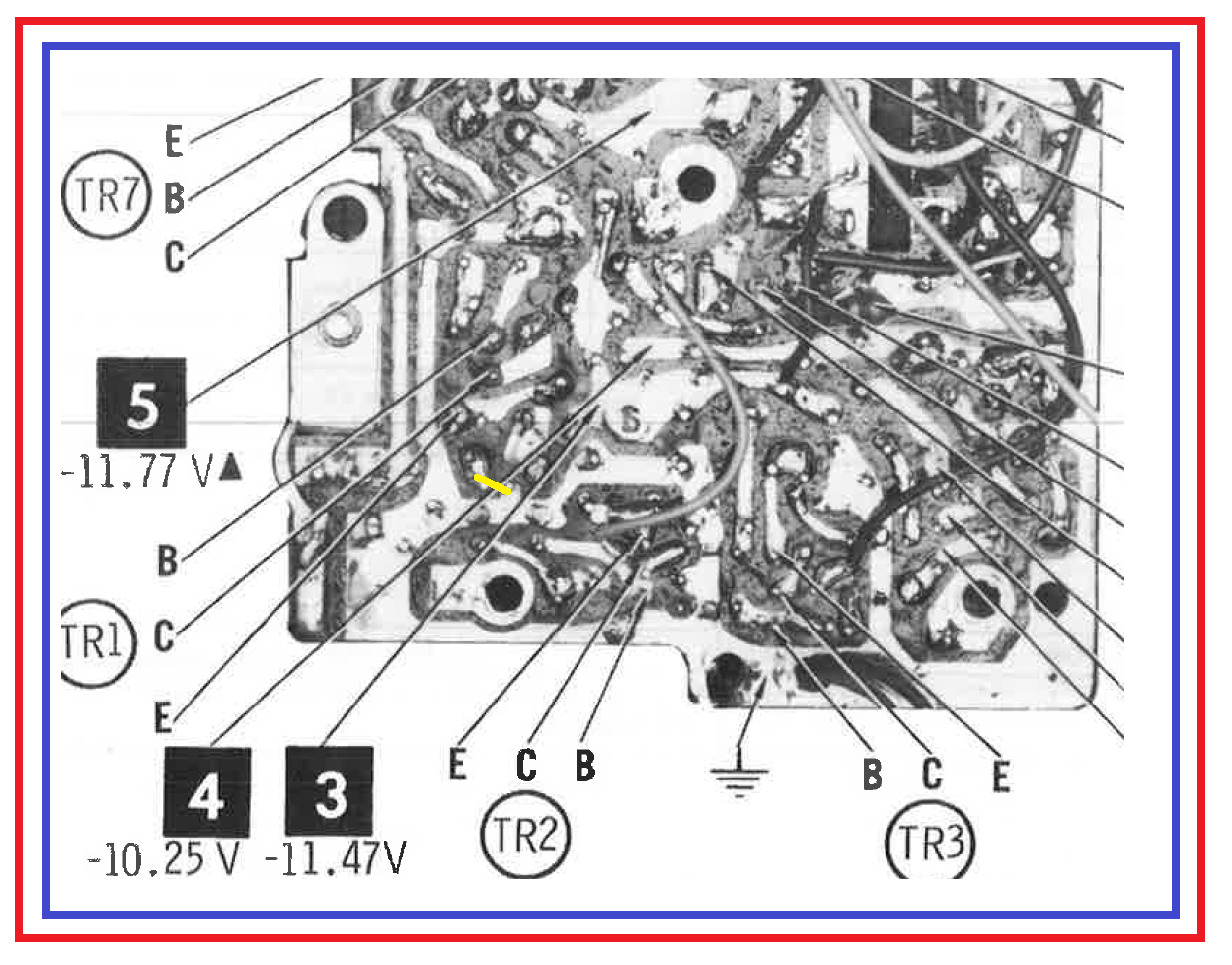

As I said, all that I see that you need to do is confirm that the now floating, corner pcb foil which is being cold terminal (#19 on the Sams schematic above).
No power is getting to the new transformer until that connection is made, which is actually being ground..

Related PCB FOIL Layout:
YELLOW is where the jumper is being needed.
