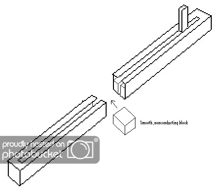

What about instead of a circuit to do this, go for a mechanical solution.
Get a hold of a couple slider-style var pots.
Tear apart one end of each open, so that the slider can come out. Discard one slider, and attach them so that the remaining slider can glide from one track to the other. You'll have to bridge the tracks, too. I think there would be a low resistance stip(metal) and a high resistance strip(maybe carbon) and you'll have to build an insulating block for the slider to ride on as it jumps from ine to the other.
Then your schematic is real real simple:
I know it looks like the two var pots and two batteries make a complete circuit, but they don't. When the slider is in the upper track, the "B" connection is broken, and when the slider moves to the lower track, the "A" connection is lost. You would want a short gap where the slider is insulated from both tracks in the middle, so that both "A" and "B" disconnect.
I know this doesn't lend itself very well for going wireless. For that you might take a look at the way r/c cars work. I can't imagine they have a whole seperate control for reverse. Maybe they have a switch or something. I don't know.
