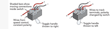

For reverse feature, The switch should have 6 terminals DPDT, (image IMG_ 4824.jpg)
The -/+ power goes to centre two the motor is fed from one end or the other, a connection is made from the remaining two bur crossed over,
see pic

In all probability the switch would go after the speed controller
Or at least the pair of motor side leads

Harald Kapp
Nov 17, 2011
14,317
Nov 17, 2011
14,317
The switch goes between controller and motor, like so:
You don't have to physically cut the wires as indicated. Simply unscrew from the controller's terminals.
