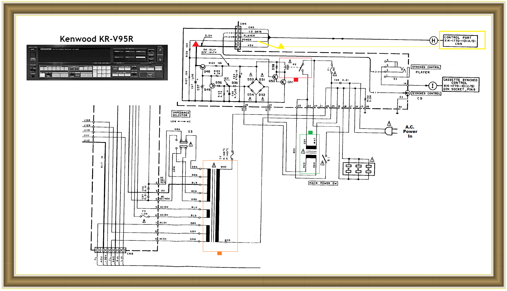

Sir Quahlity . . . . .
I now THIRD the uber-high supposition / and / probability, of there being an initial misanalysis . . . . . on your part.
Schematic referencing of the design of that unit , reveals it being of circa 1980's vintage, and is using a V...E...R...Y . . . . . .S . . .L . . .O . . .W . . . 60 ~ up and down roller coaster ride , linear design type (LONG - life) of power supply for its + and - 71V supplies for the AUDIO POWER AMPLIFIER section.
Likewise, with the C46 and the +20 sub supply that it yields . . . . with it then begetting . . . two more + 13.5 and + 5.5 sub supplies , which will probably also be good.
In the interim time, awaiting for the arrival of your covid 19 laced "care package" from the FAR EAST you will have adequate time to have zeroed in on the units ACTUAL problem / fault(s) .
now . . . . . . . .HOWTODITOITINTHEDARKDEEPBACKWOODS . . . . . .
RELEVANT KENWOOD REFERENCING SCHEMATIC SNIPPETS . . . . .
After confirming all fuses being good . . . . and not having any being blowed-ed-ed.
AC power comes in at the right center and routes thru, a hopefully fully turned on switch S1, to the GREEN flagged standby transformer.
It supplies AC to the FWB- E-filter caps and regulator transistors above it and outputs +5.5 VDC frrom the final reg pass transistor of Q48. That RED TRIANGLE flagged 5.5 VDC feeds to the right to the YELLOW control board and if all is well when you attempt to turn on the unit, a small turn on voltage comes back down the YELLOW TRIANGLE line and into the base circuit of Q50 to 51 to activate RED flagged main power relay K2.
The power relay contacts of RED FLAGGED K2 then routes main AC power to the ORANGE flagged main power transformers RED and WHITE primary winding.
Now if all is well, one then checks the secondary windings and derived voltages from the secondary of the main power transformer.
UNLESS there is being a catastrophic failure present in the audio power output transistors section, or its power supply . . . . .in which case the control circuitry will respond by dropping that relay on voltage in an instant of the control circuitry having detected an overload fault .
Then you make a more in depth troubleshooting for shorted AUDIO output transistors, shorted power supply diodes , etc.
Thaaaaaaassssit . . . . .for now . . . .
73's de Edd . . . . .

73's de Edd, That is a much better schematic than what I was working with, except it's not the right one. Would you happen to have the 'Power Amplifier unit' schematic? I have the parts list at least. The unit does have standby power, which this schematic shows. There are two power buttons, one which is a true power switch (S1), and the other is a power request button that activates the relay (K2) and powers the rest. This much of it is working, as I can hear the relay click and the 'Power Stand by' light is lit. Sorry I wasn't more clear about that before.
