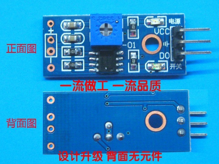

I have a temperature sensor module and i want to use it to activate a relay
the 3v coin battery on the temp sensor works great, the output turns on when the selected temperature is reached
when the 3v coin battery is used on the relay works great and feeds through 70mA roughly
when i join both together there is only 10mA going through the relay from the temp sensor
the relay wont fire at this amount and i need to figure out how to amplify it
i am a beginner at components but i have tried a transistor and got it up to 50mA but it refuses to go higher
I have attempted to draw out the circuit, please advise : D

It would be useful to get some information about the "temperature switch". The circuit you've drawn *may* be ok, but since it doesn't work there's more we need to know.
Avondale
Sep 4, 2016
19
Sep 4, 2016
19
sure!
(missing the actual temp sensor on the end)
works great, outputs 3v when temp resistance is more than adjusted resistance (i believe that's how it works)

Do you want the relay energized when the led on that module is on or off?
Avondale
Sep 4, 2016
19
Sep 4, 2016
19
it seems to go off when the temperature goes above setting, which is when i would like the relay to activate

The LM393 is open collector logic. This means it can't source current. Because of this your base drive current will be totally dependent upon the value of the pullup resistor connected to "DO". Since the output LED lights when 393's output pin goes low (not high) I would think that you should be using a PNP transistor with its Emitter connected to Vcc and the relay coil connected between the collector and GND. You will still need a series connected base resistor to limit base current.

Here's a schematic of what I described in my last post. I do have a question that i don't think anyone asked you. What's the operating Voltage and Current rating of your relay. Relays under 5V are not common.
