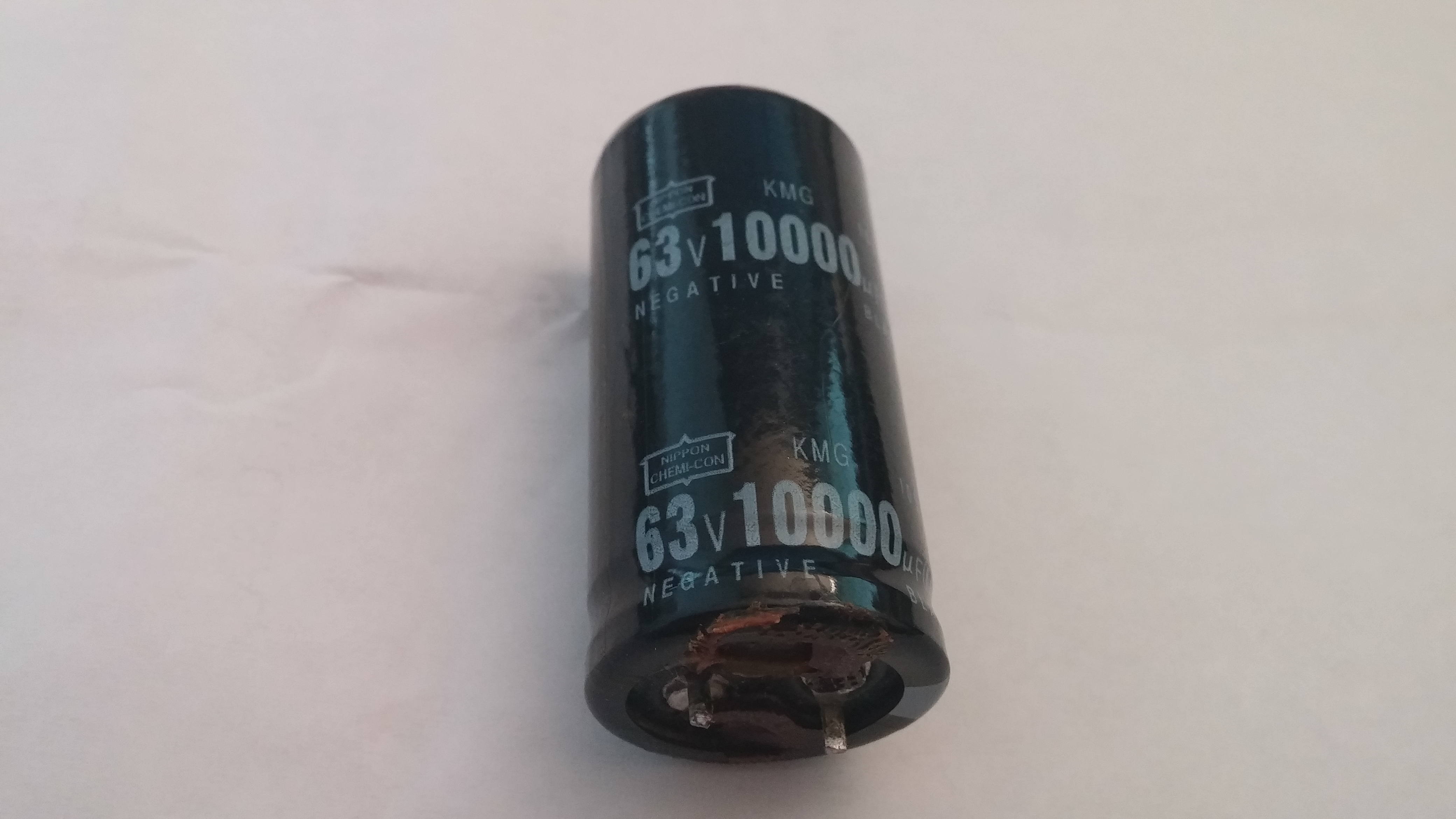

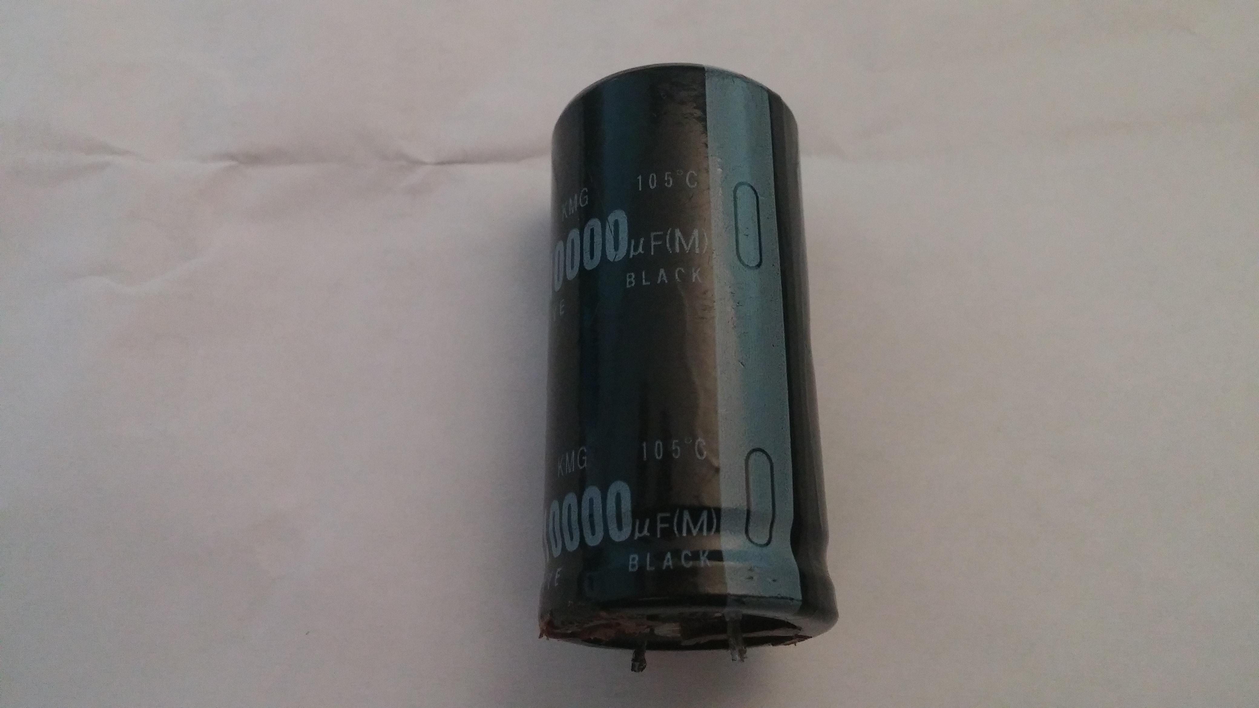

The capacitors are 63 V, 10,000uF, rated for 105 C. Standard Radial Solder Lead style, aluminum electrolytic.
They are made by Nippon Chemi-Con, and they are KMG Series capacitors (their general purpose series).

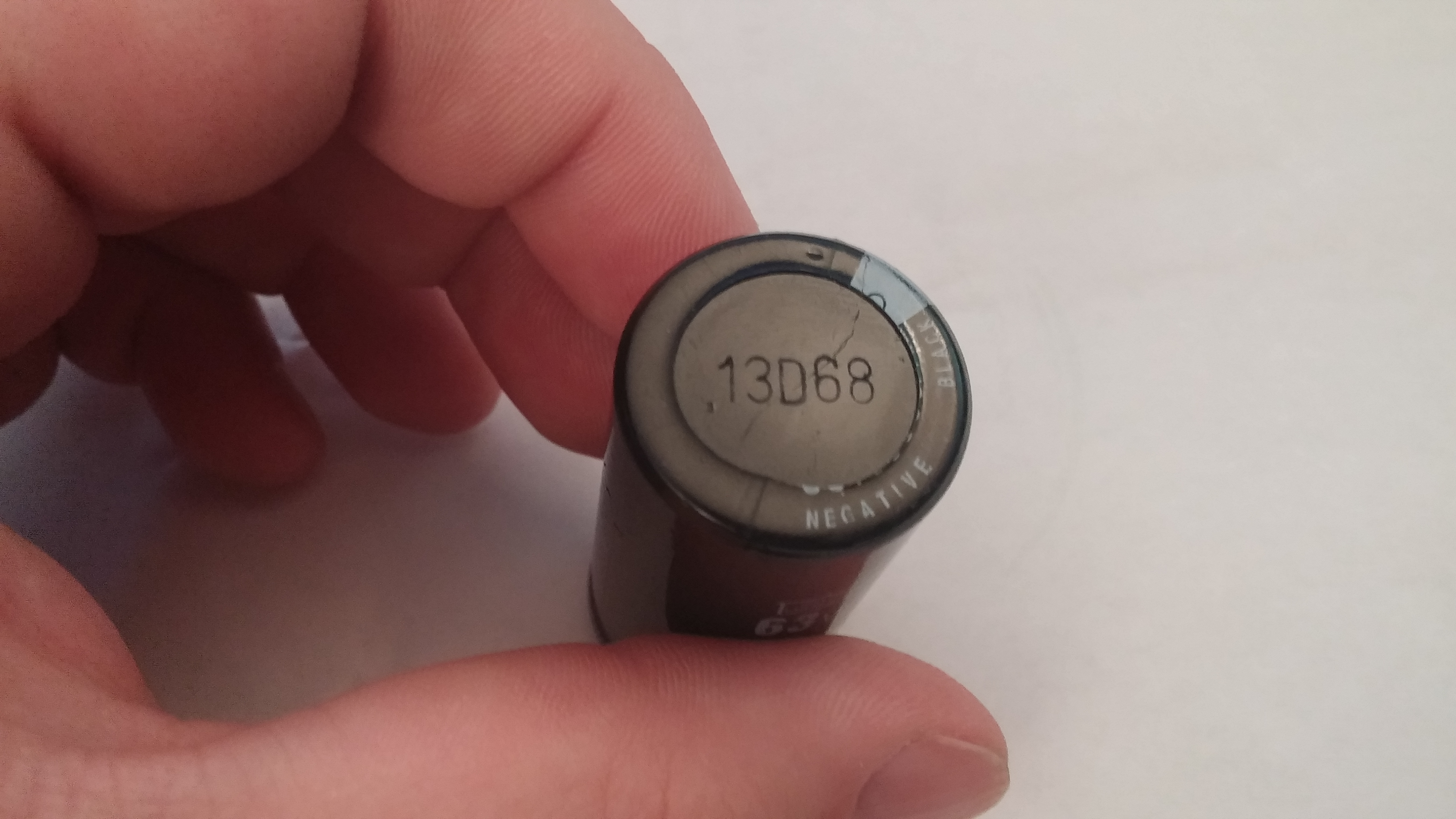

The plastic disc at the top of the cap is embossed wtih "13D68" - perhaps a date code?

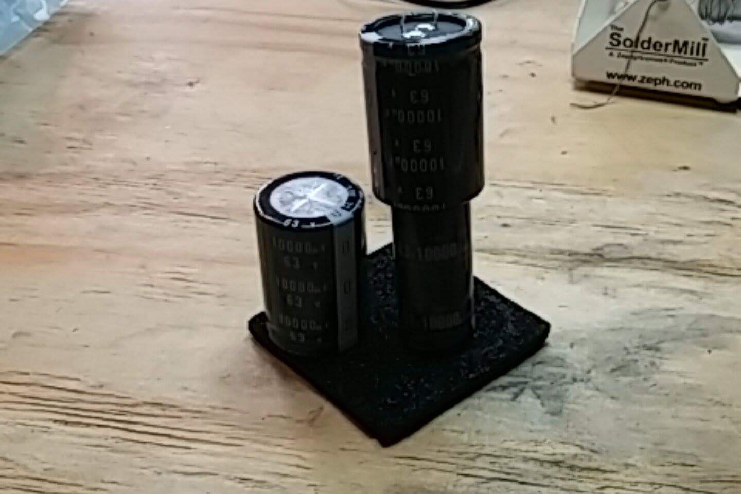

The special thing about these capacitors is their width. They are approx 25.7mm wide (and 50.5mm tall, which is common height). I have not found any other capacitors with the 63 V, 10,000 uF rating, in this width - looking for alternatives on digikey and elsewhere. All of them are either 30mm or 35mm wide. And looking at the pics I'm attaching below - I don't have room for a 30mm wide cap. I bought high quality (low ESR, higher operating hours, etc) replacement caps without even thinking about the package size, and they were 35 mm wide. You can see how much wider they are in a picture below.

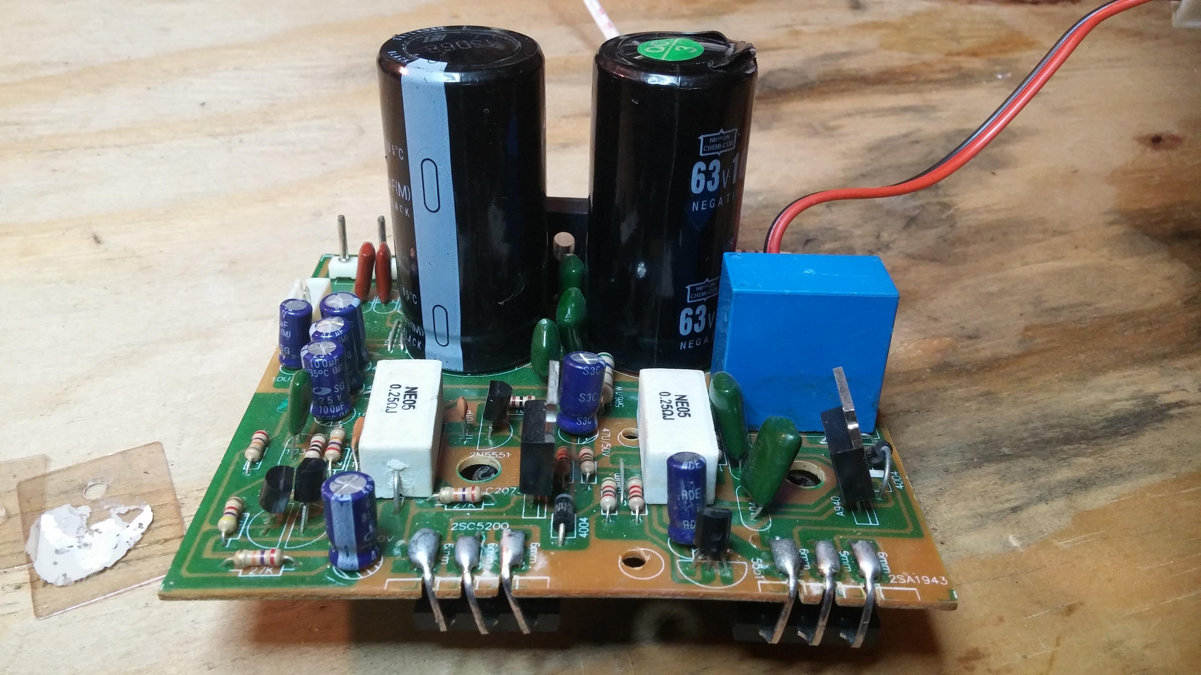

These caps are out of an amplifier board, from a SoundBridge brand 12" powered subwoofer that's about 10 years old. I have two of these amplifier boards - both of them had cap failure on these 2 caps - so I'd prefer to get better quality replacements. This sub was only sold in very low quantity and pretty much put on clearance immediately thru Woot.com - you can read a little about it here: http://www.woot.com/forums/viewpost.aspx?postid=360217&pageindex=1

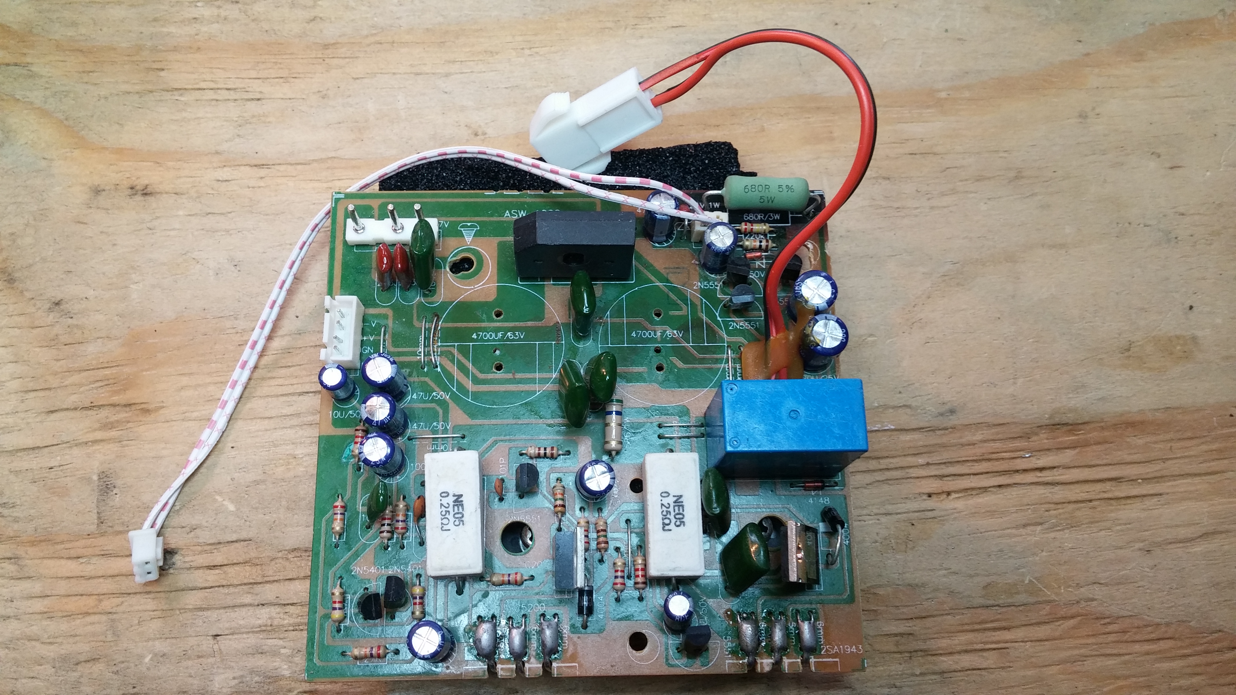

An interesting note is that printed underneath all the components on these boards is the value of the component soldered there. As you'll see on these boards, underneath the caps after I desoldered them, it said they should be 63 V, 4,700 uF ? That might be a clue here?

How the board looked to start (you can see one of the caps is swollen enough at the top to tear the plastic jacket on it):
Caps desoldered, showing the 4,700 uF rating underneath:
Cap pic 1:
Cap pic 2:
Cap pic 3:
Comparison of new replacement caps, being 1 CM wider than the old ones (the old one is in the lower right!)

An interesting addendum to the story, I have two of these amps, so 4 of these caps. I recently picked up an Peak ESR70, so I could start measuring ESR (and capacitance) for checking boards for failing caps. I decided to try it on the old caps, the "10,000" uF ones.
The visibly failed cap, the one that was bulging, measured at only 3,600 uF, which is certainly low. It was certainly bad.
The other 3 caps though, that looked OK? All 3 of them measured within 10% of 4,700 uF! I think it's no coincidence, particularly since the board itself was marked with 4,700 uF. Which would mean that all of these caps were badly mislabeled (they claimed to be 10,000 uF)!
