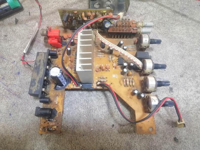

help fixing audio amplifier no sound out
pharaon
Oct 28, 2014
458
Oct 28, 2014
458
it's USB reader and FM radio as well YT-326A
no sound out
it have TDA7057AQ IC
how can i check if IC TDA7057AQ is malfunction with multimeter?

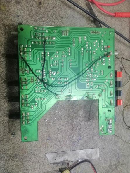

I would suggest a good cleaning of the board and it looks like the solder needs a good going over as well. Then see what is and is not working.

Looks to me like a parts board.

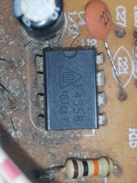

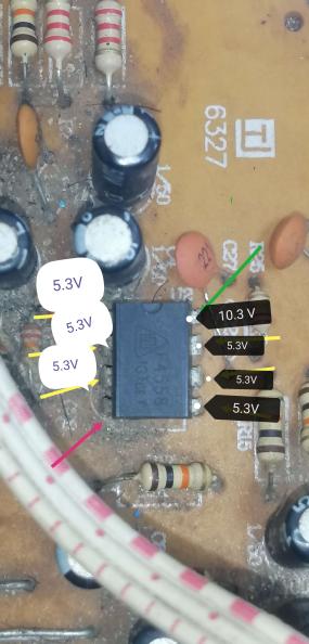

Reference data sheet TDA7057AQ provided below.
Check supply voltage Vp, pin# 4
For the dual operational amplifier 4558
Check supply voltage VCC+, pin# 8
