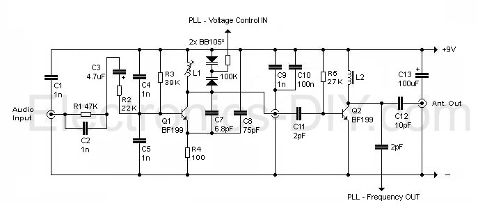

Hello there, this circuit seems interesting and I wanted to simulate and construct it, but the problem is I do not know what do the 3 symbols in the circuit represent (1 in audio input, 1 in the middle, and 1 at the antenna). I have never come across with these symbols before.
Can someone lend a little help here ? appreciate that :)

The symbol on the input and output is a coaxial connector... Not sure why they have one in the middle, unless there is a secondary tap for some reason...

Yes, in the middle part, the wire shouldn't be connecting to the ground. Middle part confuses me a lot :(

It's not, IMO it's showing that another 'connector' or take off could be installed at that point for some reason... If you do not require that take off, just consider it a non-connection like this...

The one in the middle might indicate a feedthrough through a metal shield wall between the two parts of the circuit.

very common in RF circuits to stop feedback. They have just represented it poorely

The circuit is probably meant to be constructed in a metal (steel) box or rectangular tube. The metal is the circuit ground. You place a steel sheet with a hole in it between the two sections of the circuit, and solder it to the metal on three sides (the fourth side is formed by the clip-on steel cover), and feed the signal through the hole, using insulation, or a ceramic tube, to insulate the wire so it can't make contact with the plate.
You can also get complete feedthrough components that you solder to the hole, which have a connection on each side. Open up a TV tuner or modulator; you may see something similar.
I haven't ever seen coax cable used for the feedthrough.

yeah, .... more commonly its just a semicircular notch cut out of the metal shiels so that the PCB track passes though
