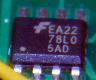

I cant find this anywhere ? what is this IC ?, A custom made one ?

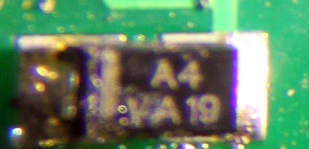

This is not much clear, sorry about that, it says "A4 VA19", is this a some kind of SMD Diode ?

The first IC looks like a Fairchild 78L05 in a SOIC-8 package. See https://www.fairchildsemi.com/datasheets/LM/LM78L05A.pdf.
The LM358A and LM358N have the same pinout. The A suffix indicates tighter specifications than the version without the A; the N suffix indicates a DIP-8 (through-hole) package.
The "A4 VA19" I'm not sure about. It could be an SMT tantalum capacitor or a diode. Someone else here will know.
This seems to be a 5V voltage regulator. Check out the datasheet below
http://www.ti.com/lit/ds/symlink/lm78l05.pdf
My circuit simulator has the IC LM358N, but this is LM358A, I guess the pin numbers are different ?
That's a dual - op amp:
LM358A is just a slightly improved version of LM358, I don't know the changes at the top of my head, but will have to check online.
https://www.fairchildsemi.com/datasheets/LM/LM358.pdf

Yes that seems to be a diode, though I can't find details. Any idea which section of the circuit this is contained in? Also what does the PCB/product do?

Thank you very much for your prompt reply, normally 78L05 has 3 pins, this SOIC-8 package has 8 pins, and there are three GNDs I guess these GNDs are all connected inside. So, it is the same three pin component in a different format right ?

Yes, the 78L05 in an 8-pin package is the same as the 3-pin part with the extra pins just commoned up.
