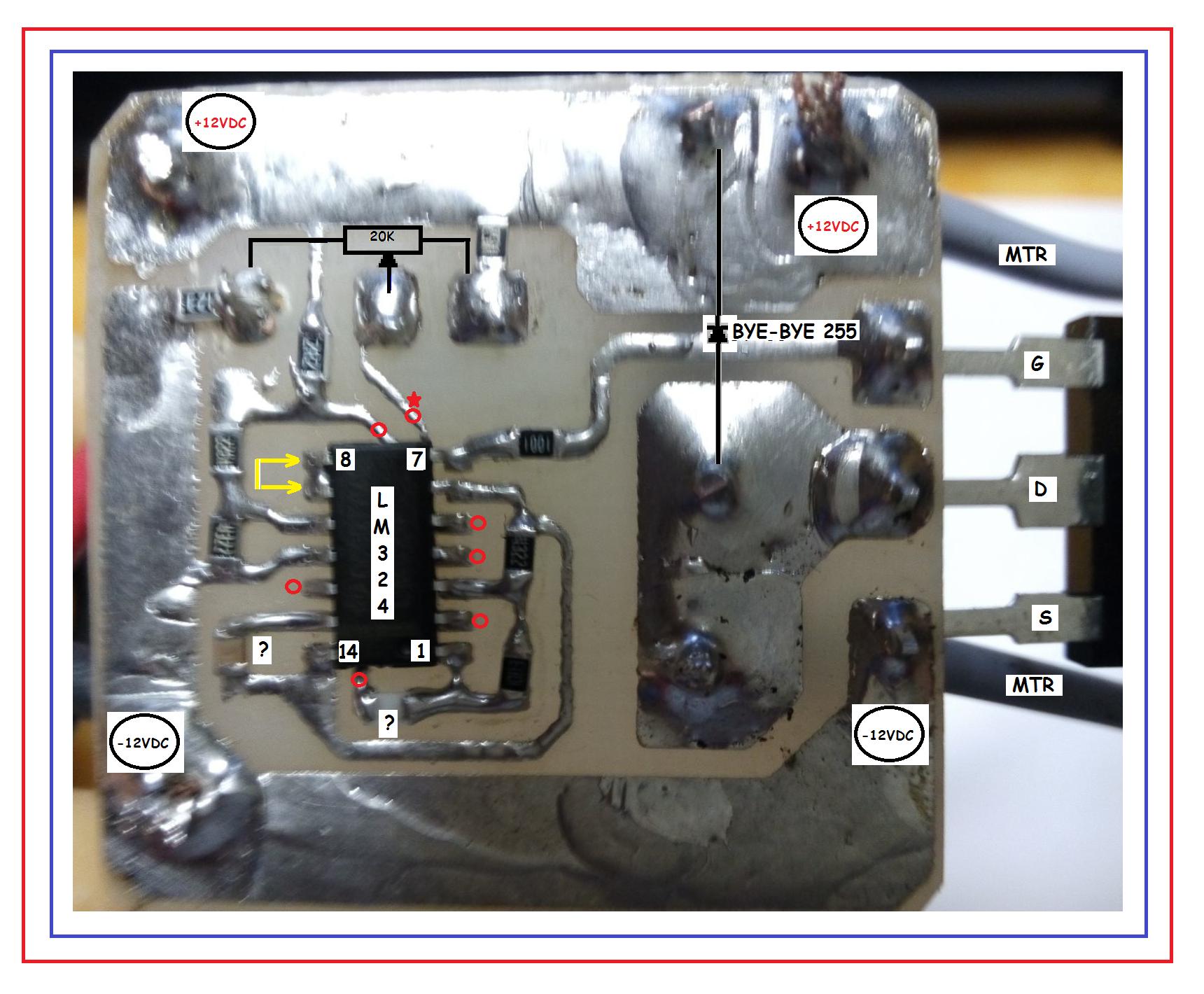

Hello,
Some time ago I made me build the attached circuit. It's a speed controller for 12 V dc motor. The problem is that I want to rebuild it for another project but there are some part of the circuit I don't understand. Can you please help me drawing a diagram for it? The only things I know are: the pot resistance 20K, the diode is a By255, the mosfet transistor is irfp054 and the IC is a lm324. IMG-20151202-WA0002.jpg IMG-20151202-WA0004.jpg wp_ss_20151206_0002.jpg

You don't neccesarily need to know how it works if you accurately reverse engineer it this entails drawing out a schematic by very carefully following every connection.
Post what you have here and it can be looked over and checked.
There does not seem that many components.

Sir mosfet66 . . . . . .
I tell you whuts . . . . .since your fotie-grafs definition/focus was being somewhat less than perfect on the reeee-sis-tom-er-fers marked values.
But . . .HEY . . .I CAN make out the series drive resistor to the Mosfet gate as being 1 K.
However . . . . . . since YOU are able to see ALL of its parts . .you will be able to fill us in..
This would be the first stage towards generating a schematic for your circuitry . . . . .
Get an ohmmeter and check out Zero ohm paths of the "hidden" foil paths under the LM324 of the red circled points.
The Red Star looks like it connects to pin 7, but does it connect to any other LM324 pin also ?
Plus also check every pin of the LM324 to see if there also might also be OTHER hidden interconnects to other pins on it, to be sure.
Seeing my yellow arrows and the fact that the output of an LM324 op amp OUTPUT section is being directly connected to its NON INVERTING input,
with pins 8 to 9 tells me that particular section is being used for a voltage referencing or halving function.
The left mystery ceramic ? capacitor is probably used as a summing function and is up in the 10-47 nf range and is VERY likely unmarked.
While the right ? is probably the frequency determining C portion of a R/C oscillator and you just might find its value marked on its other hidden side.
(Or that COULD possibly be a like film reee-sistor, that just got mounted upside down ? )
You seem to have the speed pot connected with 4 wires, do I have it correct, with one wire possibly being a redundant connection ?
Plus, with it having trim resistors on either end of it, is suggestive of an optimally "sweet spot adjustment range".
Give some feedback on that requested info . . . . .

Thank you for the answer, i'll test the missing resistances as soon as i can (I'm at the university in this period). Hope to give you soon further informations.
