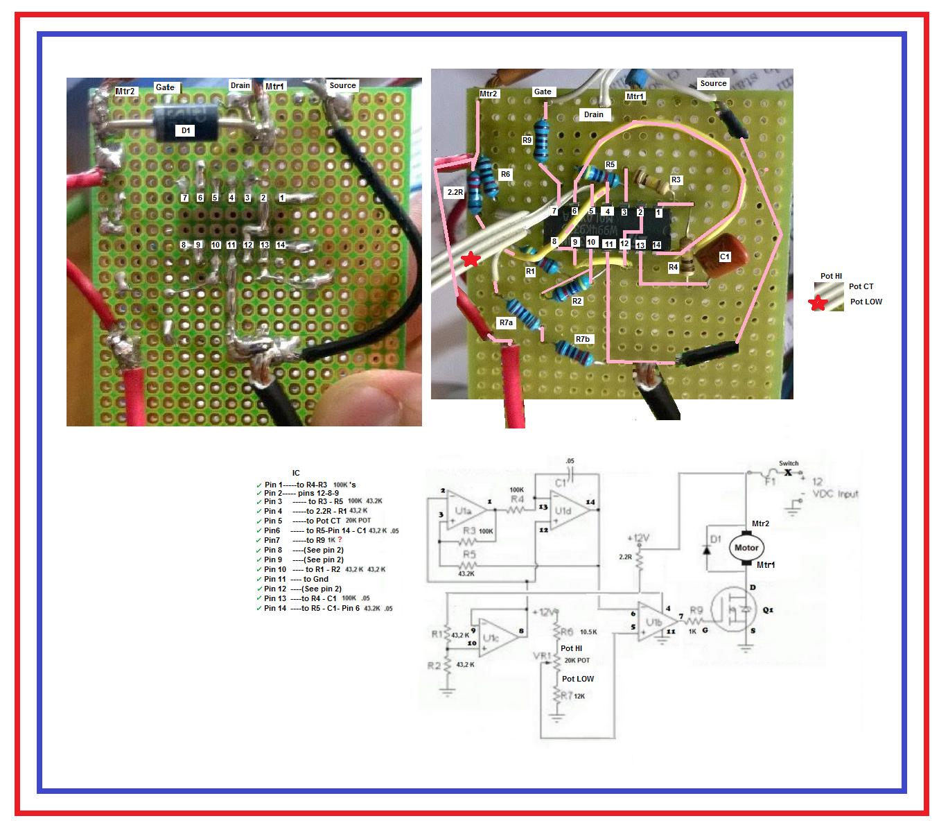

Help me draw this circuit's diagram

Sir mosfet66 . . . . . .
I tell you whuts . . . . .since your fotie-grafs definition/focus was being somewhat less than perfect on the reeee-sis-tom-er-fers marked values.
But . . .HEY . . .I CAN make out the series drive resistor to the Mosfet gate as being 1 K.
However . . . . . . since YOU are able to see ALL of its parts . .you will be able to fill us in..
This would be the first stage towards generating a schematic for your circuitry . . . . .
Get an ohmmeter and check out Zero ohm paths of the "hidden" foil paths under the LM324 of the red circled points.
The Red Star looks like it connects to pin 7, but does it connect to any other LM324 pin also ?
Plus also check every pin of the LM324 to see if there also might also be OTHER hidden interconnects to other pins on it, to be sure.
Seeing my yellow arrows and the fact that the output of an LM324 op amp OUTPUT section is being directly connected to its NON INVERTING input,
with pins 8 to 9 tells me that particular section is being used for a voltage referencing or halving function.
The left mystery ceramic ? capacitor is probably used as a summing function and is up in the 10-47 nf range and is VERY likely unmarked.
While the right ? is probably the frequency determining C portion of a R/C oscillator and you just might find its value marked on its other hidden side.
(Or that COULD possibly be a like film reee-sistor, that just got mounted upside down ? )
You seem to have the speed pot connected with 4 wires, do I have it correct, with one wire possibly being a redundant connection ?
Plus, with it having trim resistors on either end of it, is suggestive of an optimally "sweet spot adjustment range".
Give some feedback on that requested info . . . . .
Your reference . . . . . . .Marked up:
73's de Edd

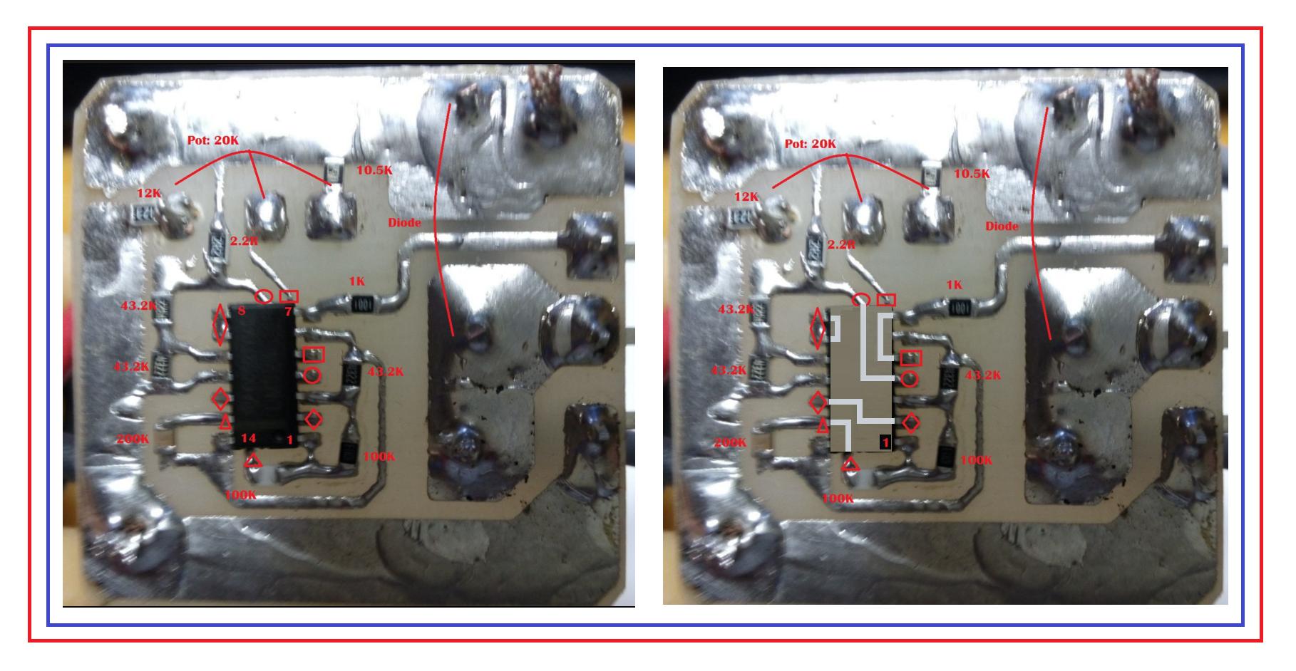

I'm finally here, i solved the circuit by testing it, the problem i've now is you told me that the left ? could be a capacitor, but testing with the ohmeter i received a 200K value, so could it be just a resistor? Same thing with the right ? that gave me a 100K value instead.
The ohmmic test needs to be performed with the caps out of circuit, as you probably are receiving "phantom" resistance shunts produced from within the IC or adjunct components circuitry.
To fully interpret this units design, we also need to know any and all inter connections that are being obscured by the presence of the flat pack I.C. sitting right on top of their foil paths and hiding them.
Plus, as mentioned, just about all of the resistors values are too blurred, so as to be read.
73's de Edd
Here's a new pic with values and paths updated

I managed to test the capacitor on the left side, and as you can see I wrote the value in the pic. The problem is I now don't know what the ? is in the circuit. I tested it as a resistor and obtained a 100Kohm Value and testing as a cap I received a value of 5.7nF (?) , but to me it doesn't seem a resistor at all. What it can be? Furthermore, if they are both caps, how can I find their polarity?
I think it will be a universal "given" that the brownish/grey component to the left is going to be a layered ceramic SMD, but the center bottom one and and its white ceramic substrate is going to be a bit more " iffy" in its confirmation .
I was just going to rely in its circuit design positioning between pins BUT . . . .see ***.
Take a look at my add on of the "hidden" paths of the foils being covered under the IC and confirm, even better, take ohmmeter and connect to pin one and use the other probe to check to ALL of the other pins sequence for a short . . . eg . . . .direct connection.
Then step up to make reference to pin 2 and the same continuity testing . . . . then 3,4,5,6,7,8,9,10,11,12,13 and 14 . . . . .whew . . . (but, hey, at least the possibilities diminish towards the end !)
THE OTHER quirk now, is that the definite fact that the driver output from the IC is feeding via a 1K resistor to the power FET gate.
Now this IC is definitely not the common 555 with its mere 8 pins, needing to make it a 556 dual unit with a proper 14 pins complement.
THAT then makes the 1K input resistor be connected to a / either pin 7 or 14 power rail connection of the 556 IC, even if you flip the IC pin indexing around 180 degrees .
Soooooooo, this IC used, must NOT be the suspected 556, which would connect to the 1K gate drive input thru either a pin 9 or a pin 5 interfacing.
About 8 other 14 pin possibilities are coming from off the top of my head, but none of them would interface the required pin 7 output, even shifting across to single and dual one shots, hex inverters or arrayed gates, of which, their 7 and 14 power pins rule out them from being a possibility..
Inspect the I.C. top to see if its part number is visible . . . .or if they have wet sanded it off . . . for "proprietary" info reasons.
Lastly look for the I.C. indexing dot to see if I have made proper pin indexing assignments.
Thats it for now . . . . .

Techno addenda:
Whoooooooa Nellie,
I just checked back to your second photo and found out that I could definitely detect the pin 1 divot marking in the N case, with there even being an additional banded end marking.
Using some " NASSER" image enhancing techniques I then come up with LM 324 with a " new old stock code date" and the marking of Sally Jean Johnson of the
3rd shift of "Tejas Instrumentations" as having done the final marking and QC test of the unit.
I wasn't yet considering in a quad op amp IC in the game plan, but its second op amp output is a pin 7.
Will see how they are using it now.
73's de Edd

I tested all the pins and this is the result. I've also made a prototype, but, obviously, it doesn't work (I mean it doesn't decrease the speed of the motor). The prototype was made using two caps one of 8.2nF and one of 5.6nF.

It's not factory made, it's handmade by a technician in my town.

Ah, that's why some of the traces are not exactly running at right angles. The board was probably not made from a CAD.
Take a look at what I found. There are two of them on the page. I believe one of them is yours! ;)
http://solorb.com/elect/pwm/pwm2/

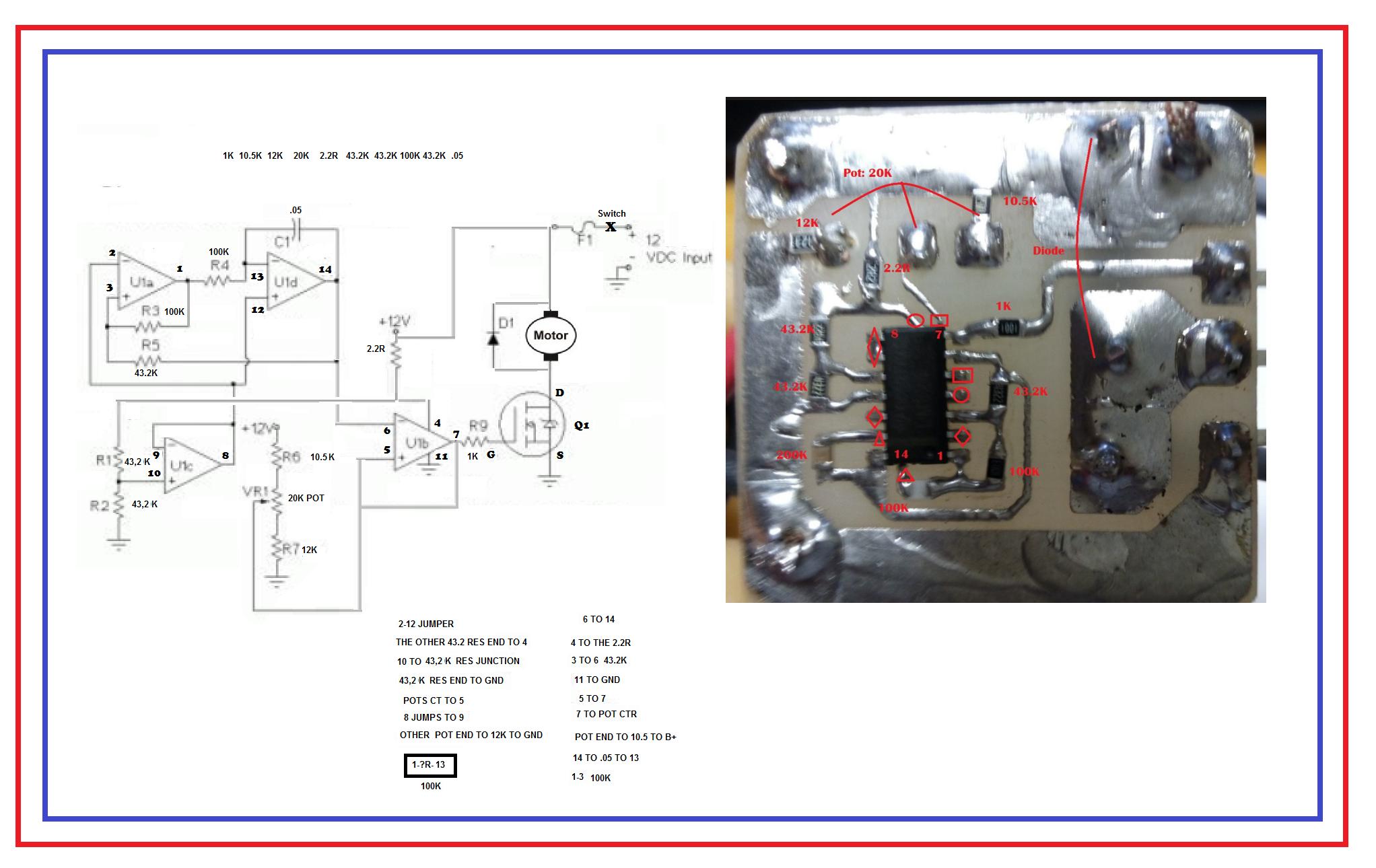

Sir Marco . . . . .
Hmmmmmmmmm . . . .I guess that I got off on the LM556 path since it had been so long since the topic was initiated.
But I do see that my original mark up had LM 324 clearly placed upon it and I cleared its area in my later drawing to create the blank PCB proper
such that I could show the hidden traces below the IC body.
I am now placing my INITIAL " rough" draft of the circuits schematic for you to compare point by point.
Now, by circuit assimilation, I can see that the "second mystery white capacitor" is, in actuality, an upside down mounted 100K resistor R4 (as you measured) that is DC coupling from an output of U1A op amp section to an input of U1D.
U1C section is taking current sampling referencing of any power supply rail voltage loading "sag" and compensating for motor speed correction.
The very bottom "doodling" is just the statement of all of the parts interconnects on the PCB.
Now . . .check it out for any initial schematic errors . . . . versus the PCB proper .
73's de Edd

Edd, after seeing the schematic you drew it only confirms the comments I made regarding the circuit link I posted.
RE SMD resistor mounted upside down. There should be a law!
RE the 2.2Ω Vcc decoupling resistor. I don't think it does much. Heck, it doesn't even have a bypass cap associated with it.

Ok, comparing the schematic with the pcb, it looks perfect except for the connection between 7 and 5 that is wrong, this is the correct schematic i edited... The only problem now is that i made a prototype that unfortunately doesn't work. I checked every connection, but the motor doesn't start at all. attached you'll find also pics of the prototype.eqM3zos.jpg 12467821_10208490058158628_434809712_n.jpg 12483733_10208490057478611_1482532061_n.jpg

Where's the MOSFET?

Sir mosfet66 . . . . . . . .
I made two 1X side by side dupes of your circuits component and foil sides and placed the guesstimated schema just below them .
Your component interconnects, I have marked up in PINK lines.
I checked out your perfboard creation . . . . . and by my green check offs of the pins of the IC . . . . . seems like all connections agree.
My view of the area under the RED star was a bit iffy, so I mainly depended on the foil side for that area for connections and routing confirmation.
