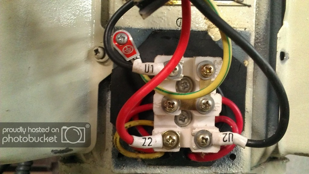

What I need to know is where to put the wires on the switch to make it work
Machine needs to go in: Forward - Stop - Reverse
I have the 2 power wires that need to be hooked into switch the ones coming from the outlet (2 hot wires)
Then out of the switch I have 3 wires going straight to motor, they are:
Black wire labeled - U1
Black wire labeled - U2
Red wire labeled - Z2 (which I am guess make the motor reverse)

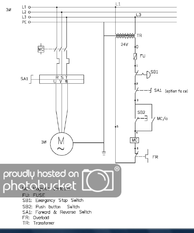

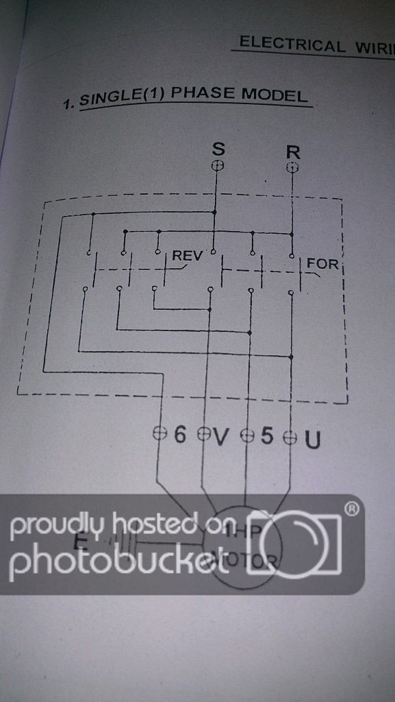

Picture of schematic of switch that needs to be put in
john monks
Mar 9, 2012
685
Mar 9, 2012
685
Not enough information.
Do you have the make and model number of the milling machine?
Do you have the part number or any number from both switches?
You might have to get the old switch working well enough to ohm it out and match up the new switch pin by pin.

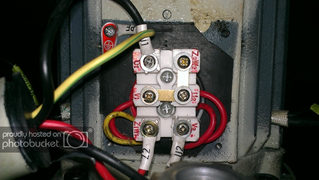

The old switch has no markings and the some of the contacts fell out and its not in time anymore with where its supposed to be since the limiting cog fell out that limited the switch to 45 degree's and it spun and that can be put back in several different ways, so a meter on it wont work since its not anywhere as it was when working.
Picture on front of motor ... make/model of machine unknown
Motor terminal block just under plate above
john monks
Mar 9, 2012
685
Mar 9, 2012
685
Now things are clear.
When the switch is in forward U is connected to R, 5 is connected to R, V is connected to S, and 6 is connected to S.
When the switch is in reverse U is connected to S, 5 is connected to R, V is connected to S, and 6 is connected to S.
The R and S are the 220 VAC line.
The U, 5, V, 6 are marked on the terminal block just under the plate on the motor.
You still may have to ohm out your new switch.

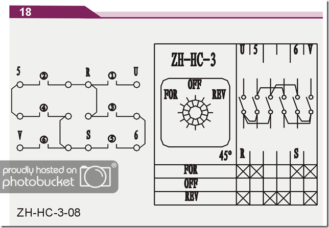

I got slightly different readings with a meter on the switch as to your reverse connections:
Here's what I metered new switch at:
Forward: S – connects to .....6 & V
R- connects to ..... 5 & U
Reverse: S- connects to ...... 5 & V
R- connects to ...... 6 & U
Off: does not connect S or R to anything

Looks like you're in luck.
The only discrepancy is that your S and R are reversed in the reverse direction from what I got. That makes no difference to the motor.
This also may explain why the manufacturer went with a different switch, that is to keep the hot line, S, from being applied to the motor when the switch is in the OFF position.
So hook it up and see what happens after you plug it in...

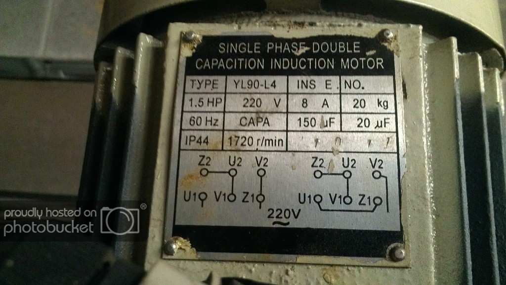

No mine is a clone of a RF45 (Rong Fu 45) ... its a PM45 the problem is they are all wired differently
Mine is second on this list, but no wiring diagrams for it exsist, these are all basically the same exact machine in looks, I pulled those 2 diagrams from a few of these machines
YL90-L4 is the motor model as seen in the picture of the motor plate, this from what i can tell is a heavily used motor on tons of these machines

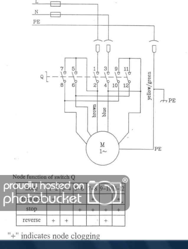

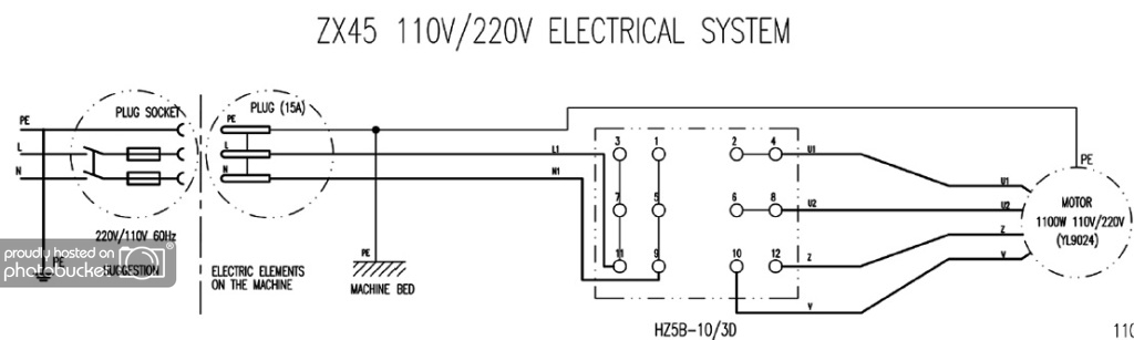

Notice page 9 on this pdf, this looks exact same as mine but the problem is this one uses one more wire going to motor block
http://www.boltonhardware.com/images/pdf/zx45.pdf

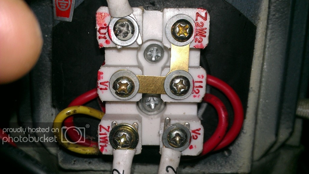

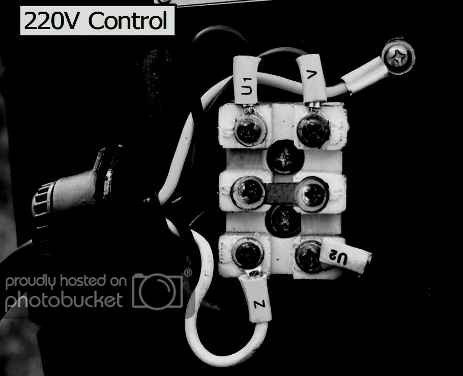

Here's a picture of my motor, there are raised labels next to the lugs on the motor, I just dragged a red marker over them so they could be seen.

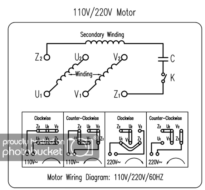

Here's some pictures from the above PDF of that other mill, the one with 1 more wire to make it easier for you to look at rather than going to PDF file above, the motor block looks like its identically labeled, I played with the contrast on it to make it easier to see the lug labels
Other mill wiring motor diagram from above PDF
Switch schemtaic from other mills PDF

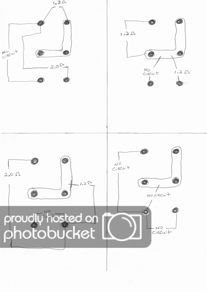

Below is motor lug box in same orientation as above pictures
Tested with meter set to: 200 ohm setting
All wires are removed from motor lugs for this testing
As you will see below there are only 3 results, they are either: 2.0 ohms, 1.2 ohms or No Circuit

Your in luck.
You have two stator windings. One between U1 and V1 and another between U2 and V2.
V1 and U2 are lugged together for 220VAC operation.
Each winding is designed for 110VAC operation.
They can be connected in series for 220VAC operation as in your case.
There is another circuit, a coil and some capacitance that is connected to Z1 and Z2.
This circuit is designed to run off 110VAC. This is done by connected it in parallel with one of the stator windings.
The direction the motor turns is controlled by the phase of the 110VAC that is applied to Z!W1 and Z2W2.
In your case Z2W2 is connected to V1. And Z1W1 goes to your forward/reverse switch. This connects it either to U1 or V2, U1 for one direction and V2 for the other direction.
So what you want to check for is that your line cord connects directly to U1 and V2, and that Z1W1 is conned to U1 or V2.
If this checks then the next thing to do is plug the machine in and see if it works.
If you have 220VAC across U1 and V2 and Z1W1 is at the same potential as U! or V2 and the motor doesn't turn then something is wrong with the motor. This is unlikely because the numbers you gave back seem reasonable.

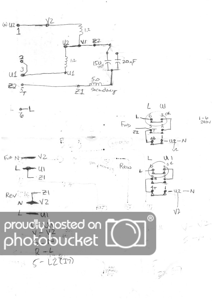

I had an electrical engineer come over and hook this up, it now works as before, he did note that the centrifugal switch never allows the start capacitor to work kick in, which is why I had to give the spindle a flick to get it to spin at full speed most of the time even before the switch went bad, its starting only on the run cap side.
But I am happy to say the new switch is in and works as before, thanks for all your help John I really appreciate everything you did.
He left this diagram behind I figured I would post it in case this could help someone else in the future.
Please rephrase this statement as I'm not sure what you're saying. I will tell you what I know to be true about Split Phase Capacitor Start/Capacitor Run Induction motors. I have a 1954 Logan 920 Lathe and a 1966 South Bend Heavy 10.
(1) The Start winding along with its series connected start capacitor are switched out of the circuit by the centrifugal switch when the motor RPM reaches about 65% of run speed.
(2) The Run Cap is connected in series with the Run windings and is never switched out of the circuit.
(3) The direction of rotation is determined by the Start winding's phase relationship to the Run winding only at Startup. Once the motor is running at > 65% of speed the Start winding and series Start cap are switched out by the centrifugal switch and has no effect any longer. If You quickly switch the motor from forward to reverse nothing should happen. It won't change direction unless the motor RPM fell below the centrifugal switch's dropout speed.
(4) If the Start winding is disconnected and you power the motor it should hum loudly until you manually spin the Stator shaft. It will run in either direction depending on which direction you spun it.
(5) If the motor will not run without manually spinning it by hand then either the Start winding, Start Cap or Centrifugal switch is bad or not wired correctly. The Start cap fails (leaky) far more often than Start windings or centrifugal switches fail.
(6) The wiring diagrams always seem to be more complicated than they need to be! :D
