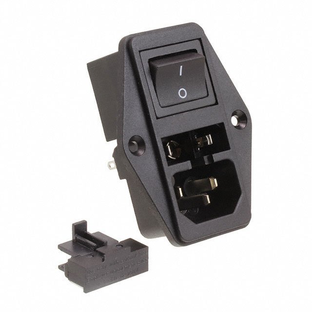

Hi
I need some help wiring up this Schurter 6765 power receptacle it has two fuses, one for Phase and one for Null
Electronics is not my strong side, so if someone could 'draw me a picture' it would be very helpful
Thanks in advance

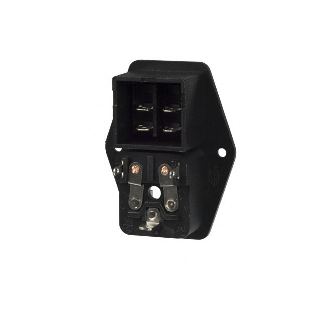

Live and Neutral INPUT to the top two connectors.
Live and Neutral OUTPUT from the bottom two connectors go to the lower solder tabs.
Earth connects to the lowest (middle) solder tab.
kellys_eye
Jun 25, 2010
6,512
Jun 25, 2010
6,512
Re earth wiring..... connect it anyway. You never know.....
