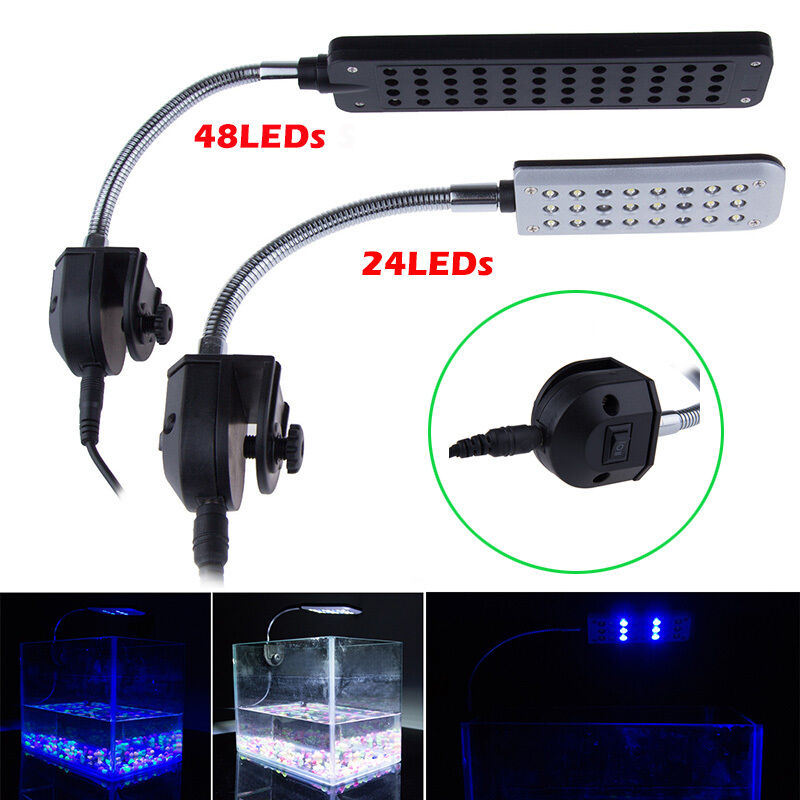

Hi all,
I am a beginner in this world and would like support in developing a project that I have in mind and what I will explain.
I want to replace the normal 12v aquarium led switch ON(Blue + White) – OFF – (Blue) into a light sensor system. Imagine ON(Blue + White) during the morning until there is enough light, OFF during the day and ON(Blue) during the night. Can you help me out on building a diagram and what to buy in order to setup this project?

Hi ak,
Thanks for the the quick reply,
This is the led that I have:
This led lamp is a 12v dc.
My intention is to use the top of the lamp to acomodate the new logic board and the LDR to control the system.
I am very confortable to disassemble and make the necessary changes, however I don't know what controllers should I use.
Thanks and regards
AnalogKid
Jun 10, 2015
3,058
Jun 10, 2015
3,058
It looks like a 3-position switch. Yes?
It looks like the 12 V source plugs into the bottom of the switch/mounting module. Yes?
If yes, yes, then there are a couple of ways to approach this. With the circuit mounted on the back (top side) of the light assembly, wires can run down the gooseneck and into the switch module. Or you can go directly into the light assembly, and leave the switch module untouched as a simple on/off device. Either way, the light sensor has to be somewhere where it will not be fooled by the aquarium lights it is controlling. One way to do this is to remote the sensor on a few feet of wire.
ak
Hi again AK,
Yes and Yes. The idea is to drill a hole on the top lamp platform to accommodate the ldr. The rest of the circuit can be near the switch. Can you point me out what do I need to buy? And help me with a diagram?

What is the output current rating on the power supply. This gives a clue to the kind of switch part to use.

A simple light sensor circuit is, well, simple. It doesn't know the difference between faint morning light and faint evening light. With one sensor and two comparators, a full cycle would go like this:
night - blue
morning - blue + white
day - off
evening - blue + white
night - blue
Preliminary parts list:
1 - LM358 dual opamp
2 - power MOSFETs
1 - LDR (light dependent resistor
misc. resistors and capacitors
Unlike a comparator with an open-collector output, an opamp output can drive a MOSFET gate directly without needing a pull up resistor. The two MOSFETs are in series, forming a combo AND gate.
What kinds of electronic components do you have access to, and what is your experience with wiring a small circuit on perf board?
