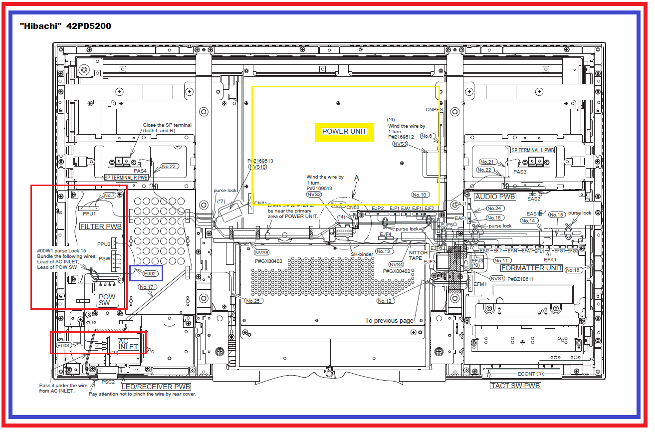

Sir portishead. . . . . . .
Do any power designating LEDS on the sets front light up?
Track down the AC line cord path going to a shielded line filter network and it exits as E902 connector which connects into a small PCB silk screened as . . . . ."FILTER".
See if that boards F952 10amp/250 v fuse is blown.
Thereby . . . . . ascertaining if you have had a "HARD" failure . . .or hopefully not . . .and thereby a "soft" failure .
If not, then the next area of inspection will be the power supply board . . . ."Power Unit" :

Ok, so the green power light comes on when I turn the set on. It continues to stay on after it turns it self off.
I have found a fuse as in the picture attached. But it's marked differently if you'd take look...

That's good on the GREEN LED . . .that means that the units standby power is operative . . . .and that also might tell us that the remote section and a hunk of its associative u/p circuitry is operative, if you can turn on the set with your remote.
And yes . . .your Flag tells me you have 220V AC power . . .while mine tells me 120V AC power . . . . half the supply level . . .thereby . . . your unit is using but a 6.3 A white ceramic fuse.
It will be good . . .because your standby power supply is downstream from it. . . . .HOWEVER, there are 4 others power levels being produced on that PS board.
On that e bay kit that you referenced us to, the 10 ohm fusing / resistors are at the top left of that Power board and you can ohm them out . . .but I feel that they will also be good.
See if you can find those referenced . . . . two (2S) K2843's mounted on your power board . . .probably mounted on a heat sink . . . . and of the same numbering, considering that they did not sub in different new parts numbers.
