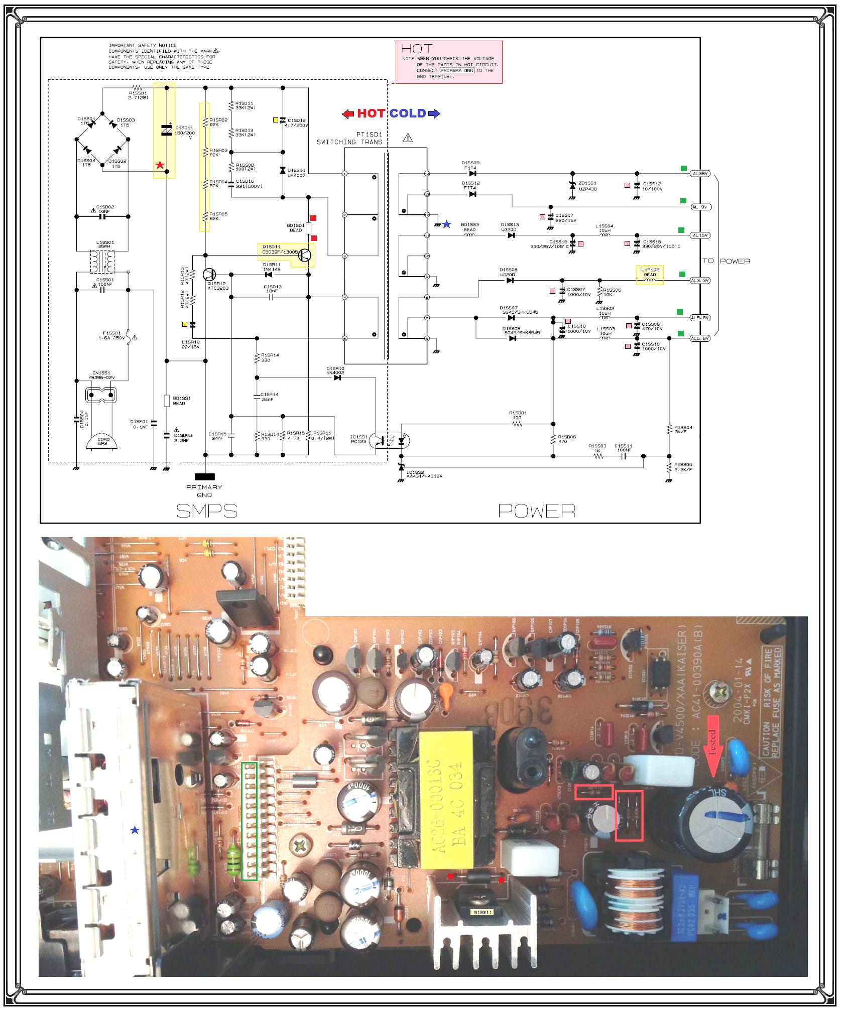

Greetings! I am new to the forums and hopeful that someone can assist me in repairing a couple of old VCR's.
The first VHS/VCR is a Samsung DVD-V4600 unit I purchased at a thrift store. I happily brought it home and plugged it in to find that it had no power whatsoever. No lights, no blips, nadda. Dead. Now I'm not so happy. I unplugged the unit, took off the lid and did a visual inspection. The unit, to my surprise, looks pretty clean. I examined the components and I do not see any visual indicators as to the issue. No bulging or leaky capacitors, no burn marks, etc. The fuse is not blown. I plugged the unit in and noticed a buzzing/humming noise coming from the power supply area. (Naturally I googled "buzzing smps" thinking this would lead me in the right direction. Sadly, unlike on television, google was utterly useless). Determined not to give up I spent hours googling and reading about switch mode power supplies. I bought a capacitance meter and discharged the big main capacitor and measured it. It seems fine. I then tested what I believe to be the "startup" resistors. I removed one leg from the board first. These measured fine also. Next I considered testing the mosfet but the transformer is blocking my screwdriver making it difficult to remove. I'm hoping someone can give me advice on what to try next... Photos of the power supply are below (I've indicated the capacitor and resistors I tested in the second photo). Any questions please let me know and thank you in advance for any help you can provide!
Summary:
No visual signs of defects (bulging, leaking capacitors, etc.)
Buzzing noise coming from power supply
Tested large capacitor and startup resistors = ok
Fuse is not blown
I was able to find the service manual online. Here

I'm no expert, but I'll warn you that a Smps can be very difficult to repair due to their complexity.
Also beware that dangerous high voltages are present that can knock you on your arse (or worse).
I'd start by checking diodes and mosfets.
You may want to pull out a component in series with the ps incase there is a downstream short dragging voltage down. Then put a light resistive load across (parallel) the power supply sized less than the ps rating. This will isolate wither its the ps or something downstream shorting it out.
If ps voltage doesn't come up, opto isolator, transformers, or the ic controller could be bad.

The 'buzzing' tells me that the supply is constantly cycling through boot-up - and failing due to a problem on the SECONDARY side.
If you can remove the PSU as a module and test it with just an AC mains input (appropriate precautions to be taken of course) you might find it boots properly and you'd then be looking for problems elsewhere in the unit.

I was able to pull out the power supply board. I plugged it in and the buzzing/humming noise is still there.
I'll do some testing of the individual parts today. The schematic is included in the service manual (linked to above). Is there any other way to narrow down the testing or should I basically remove and test every component possible (sounds fun!) ;) There are quite a few electrolytic capacitors and even more diodes etc.

I was finally able to get the MOS transistor out of the circuit for testing. I'm a little confused when trying to test this. I tried testing using my multi-meter using hfe (see photo). I believe I have it placed correctly (NPN and legs in the correct order of BCE) but please double check, I have been known to make mistakes. I seem to get no reading other than an occasional - sign. I then poked at it with the multi-meter in diode/continuity mode. You can see the results in this 17 second video. VIDEO
I also decided to pull one leg of one of the zener diodes. The test on that, in Diode mode, seems to indicate a bad part. I get a low reading in both directions. See the attached photo's.
Is the transistor bad, or am I doing something incorrectly?
Is the diode bad, as I suspect, and in need of replacing?
What should I check next now that we have this info?
Thanks again.

You can't test a MOSFET in a standard transistor socket.....
The zener diode check looks to be dodgy - assuming the meter is being used correctly (have you checked the user manual for the correct operation of that mode?)
You can use the diode check mode to test the MOSFET - check between all lead combinations of the MOSFET and report back with the results.

What is the actual part number on that 'transistor'?
I believe the service manual refers to this PART (The link to the service manual is in my first post in case that helps. It contains schematics and part numbers for everything). Attached is a photo of the front of the mosfet so you can see all the numbers.

Sir WyluliWolf . . . . . .
I think what you may have yourself, there, is being a " soft " failure.
Should it have been a HARD failure, fully expect a blown line fuse-Rectifiers- and that Power transistor.
The final fault analysis should probably reveal either a time evolved onset of "atrophy " of one or some E-caps
in the unit.
Or . . . . there could be a shorted or high leakage of one or more of the diodes that rectify each of the secondary transformer windings to create their specific voltage supply output.
Or . . . there could be an atrophied / weak E-cap (s) on one or more of those secondary supplies.
Procedure: . . . . .
I believe that your zener is OK and you are actually reading the inits common junction voltage of 700mv, by virtue of the MANNER of its polarity, in which you are now testing it, wherein you are also not reaching the zener threshold with your test voltage level.
Put the PS all back together as it was and then refer to my marked up dupe of your photo.
I have dropped its contrast, to let otherwise obscured / darkened parts now being shown up visibly.
At the top schematic . . . . .points of interest, being . . . . The YELLOW C1SD11 is the main B+ electroltyic for the AC line derived HOT power supply.
The arrangement of a series of 82k resistors are done in that way, to physically string them out for voltage versus mechanical physical isolation considerations.
Their function is to initially supply a bit of start up bias to the Q1SD11 power osc transistor and Q1SR12 driver transistor AT THE INSTANT THAT YOU PLUG IN THE AC POWER LINE CORD.
ALL TIMES AFTER THAT . . . the power supply either runs at a standby reduced power mode or at full operational power mode when the unit is turned on at front panel or timer, or by remote control.
They would only come into play, if unplugged or having a line power disruption.
The only other immediate considerations on the LEFT half of the supply which is AC line POWER HOT, is the need to use the RED STAR ( or any of the 6 other direct part tie ins to it ) for any metered readings for your meters black ground lead.
Looking over to the BLUE . . .COLD . . . side of the supply, it is being isolated from the AC power line by the transformer.
Metering can use the BLUE STAR or any of the like symbols for negative meter lead.
The far right GREEN SQUARES are relating to different derived supply voltages . Moving to the left are the PINK E-caps related to filtering those different supply voltages.
Just to the capacitors left, would be the specific diodes which created those DC supply voltages .
HOW THIS SPECIFIC UNIT WORKS . . . .
With YOUR unit not having blown the 1.6 A fuse, just inline after AC line power input, we can run power up to the discrete 4 diode full wave bridge at the top left corner and derive DC voltage to charge up he YELLOW . . . .C1SD11S . . .MAIN E-cap and it then directs its stored power to the right thru the terms 1 & 3 top winding of the primary of the power transformer and then it passes to the left to the collector of Q1SD11.
The simultaneous voltage bump from the start up resistor string, keyed the base of the power transistor to create a pulse at the aforementioned primary winding. The then collapsing magnetic field from the primary , magnetically induces the secondary 4 &5 winding to create a voltage output pulse which feeds to base of Q1SR12 driver transistor. .
The collector of Q1SR12 then correspondingly, kicks out a drive pulse to the base of Q1SD11, so that it will then repeat that pulse output up at the collector.
Now you have yourself a self running power oscillator, but is being able to vary its output level by modification of the base drive of the Q1SR12 driver transistor.
That is being accomplished by the circuitry just below that transistor pair, which is being correctively fed by the varying output of the IC1SS1 , optical isolator, located just below the power transformer .
The use of an optical isolator also keeps the HOT AC Line operated circuitry at the left, electrically isolated form the safe low voltage secondaries on the cold side of the power supply.
Look to the right half of the IC1SS1 optical isolator and you will see that its internal LED is receiving a sampling of the +5.8VDC supply as is established by any turning on of the is sampling the IC1SS2 PRECISION REFERENCE ZENER
If the whole right half of cold supply voltages pull down under loading demands , the +5.8 supply also pulls down and varies the established brightness of the OI's internal LED , which alters the OI's other sides phototransistor to change the drive level to the power transistor to up its output to meet the altered power demands.
C1SR12 and adjunct resistances maintain a speed of response and recovery time , for stable compensatory power transitions .
HOWTODOITTOIT . . . . . .
HOT SIDE
Get DC metering set up between RED STAR ground and probe into the bare wire on either side of RED SQUARE sides of parasitic suppression ferrite bead at the front of Q1SD11 power transistor.
Be SURE that your probe pierces any clear lacquer coating that might be on the bare buss wires.
Then HOPE that your meters response time will let you make out some voltage peaks after you have plugged in and powered up the system. If you happen to have an old analog . . .needle . . .meter it would excel in this particular testing, vice a digital unit, since I see that your meter does not additionally, have any LCD hash mark "analog scaling"..
If you then detect any cyclic up and down voltage swings, one might consider the secondary "COLD" circuitry, and that a diode of a supply line might have dead shorted or its electrolytic that it supplies, might have DRASTICALLY reduced in capacitance with time.
This is particularly true of the + 5.8 VDC supply since it is used for feedback referencing of power control.
In metering the COLD supply, if you look at the marked up photo , it looks like you can see bare buss wires passing up to the WHITE connector I have marked with a GREEN RECTANGLE.
That would be easy access for meter probing with you using COLD ground meter referencing to the BLUE STAR of the metal housing to the left of the WHITE connector.
If you then DC meter those voltages, expect very low voltages that fluctuate in rhythm just like the HOT side voltage did.
The 26VDC supply would vary the most, and lower voltages , proportionately less, especially the 3.3..
If one does not vary at all, it might be due to its supply diode being shorted.
On the other situation, place your metering in AC mode and probe each supply, a high reading on a supply there would be indicative of a pooped capacitor that has lost its capacitance.
Now . . .go makee- testee-testee and feed back or initiate further querys.
MARKED ON PHOTO AND MARKED UP REFERENCE SCHEMATIC . . . . . .
73's de Edd . . . . . .
