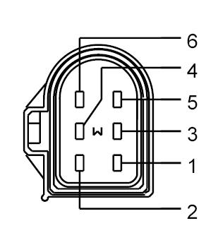

As the valve opens and closes with power to it's coil from the ECU, the pot sends a valve position signal back to ECU on pin 6. The more the valve opens the higher it is.
I think I'm dealing with two basic circuits at the valve.
1-Coil (pins 1, 5) 8 Ohms, operated with 5v max I think.
2-Potentiometer (pins 1, 6, 4 ) 6 being the wiper.
Total resistance at pins 2, 4 should be 3k7 Ohms. 5v
THE key is that the ECU needs the pin 6 feedback voltage ranging from under 1v volt to 3v or more (the pot is fed with 5v)

Summing up the connections:
Solenoid:
Pin 1: Controlled Ground (0-5V less than B+)
Pin 5: Power Supply (on board voltage) / Battery Voltage (+12V)
Potentiometer:
Pin 2: Power Supply Voltage (+5V)
Pin 4: Ground
Pin 6: Wiper signal (1-3V)

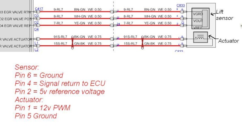

Here is a typical EGR circuit

Usually the ECU takes no reference from the actuator (pins 1 and 5) this is only an output from the ecu. When starting from cold you should have a closed valve from about 1-2mins then a 50% valve then a 75% open the around a 98% open valve then settle back down to around 65% when engine at normal operating temperature. During driving the valve will fluctuate between 50% and 90% depending on driving and engine load etc. When not accelerating and car is rolling valve will close. When clutch dipped the valve will open again. Anything above 2000rpm you don't want the egr valve open because the turbo kicks in you you need total clean air and fuel for power. The engine is contantly measuring pin 4 as its signal return. It uses the 5 volts as a reference and as the resistance changes in the lift sensor so the voltage back to the ecu changes. You cannot put 5v on the signal return because the ecu see's this as a fault. Probably around 4.8v is the max. Also you can't put 0v back as the ecu thinks you have an open circuit, hense the 0.6v when valve is fully closed.
As a side note here is how the egr valve works....
Most people think the egr valve just reburns exhaust gases to lower emissions although this is true its not how it works. The egr valve cools the engine!!! Supprised?? Well its true,, by returning exhaust gases into the cylinder reduces the amount of oxygen that can fill the cylinder. Less oxygen equals a cooler burn and a better burn. More of the mixture is burnt so the emissions are lowered. BUT anything above 200rpm is when we want power!!! More power equals and bigger explosion in the cylinder. How can we achieve this?? Add more oxygen to the mixture burns hotter so we don't want egr so we close the valve.
Knowing all this you have to produce a circuit that can stay off from cold for 1-2mins then gradually increase in voltage. Then above 2000rpm it has to produce 0.6 volts. Anything other than that then the ecu sill see a problem and the engine management light will be on and/or even go into limp home mode.
By rewriting the software in the ECU we take away the ECU's ability to look for the egr.
Hope all that helps.

If the ECU interprets both 0V & 5V as a fault then you'll have to include a couple of diodes to narrow the voltage swing by 0.6V either way. Use 1N4148's.
The transistor can be any (universal/ general purpose) small-signal NPN; BC546-BC550, 2N2222, 2N3904, 2N4401, 2SC945, etc.
Get a 47k resistor and a 1µF capacitor too while you're at it, just in case better output filtering is needed.
When you measure 4.5V at the solenoid, is that across the coil, or at pin 6 with reference to engine ground? What was the thing about reverse polarity?
I'd expect the mechanical travel to be substantially narrower than the electrical travel of the potentiometer. TPS pot's behave this way too.
The ECU surely tracks the min & max values encountered and calculates the % valve opening between these two extremes.
I notice a discrepancy between the EGR document you first linked to (P1 = +12V, P5 = Sw. GND) and the one you posted last (P1 = 12V PWM, P5 = GND).
You may want to measure the voltages on those pins (relative to engine ground) to verify what it really is like.

1-Got some 1N4001 are they any good?
2-" and the one you posted last (P1 = 12V PWM, P5 = GND)"
I think that was posted markm, not me
3- Yep, across the coil, i noticed that my multimeter showed the - minus sign (Inverted) polarity while measuring coil and pin 6 (if reversing probes then it would dissapear, tried with a 1.5 dc battery to see if the tester was wrong, but worked normal, puzzled.:confused:
