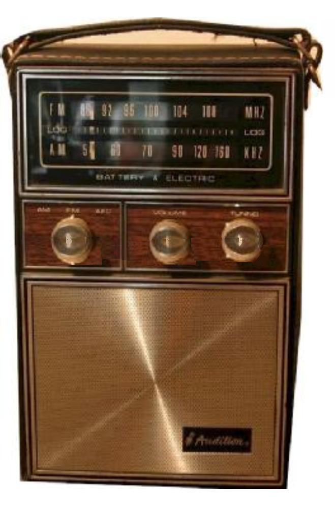

Here's the "Audition" radio

Mme Soulwyvern84 . . . . . . . . . . . .
Since plastic warps and bends due to the tensioning exerted by spring loaded batteries . . . .you can still get replacement holders .
or you could also have a problem with caustic eroded contacts . . . . damaged beyond easy repair.
So look and find your battery clusters configuration.
Battery holders :
https://images.search.yahoo.com/sea...p=AA+battery+holders&fr=yfp-t-201&fr2=piv-web
The number given is the valid and complete Audition model number .
The Audition . . .is battery powered only, thereby having no AC provision.
73's de Edd
