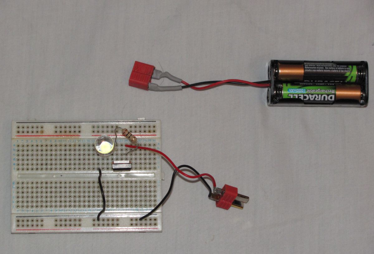

I made a simple circuit using the LM317T to regulate the current going through an LED. The voltage drop between ADJ and Vout is supposed to be 1.25V and the current is limited based on a resistor placed between the adj and output terminals where current out = 1.25/Resistance;
http://www.instructables.com/id/Super-simple-high-power-LED-driver/
But when i measure the voltage across the output pins of the LM317 I get 0.73 between the ADJ and Vout and 2.35 volts dropped across the LM317 in total meaning my LED isn't getting enough volts to light up as brightly as it should. The supply is 5.3 volts and the LED is only seeing 2.8 volts across it when i measure it using my multimeter, the rest being dropped across the LM317T. The LED is specified for 3.5 volts and should be a lot brighter than it is. Also when i measure the current out of the LM317 i get 125mA as i should based on the fomula, until i connect up the LED then it drops to 50mA.
Can anyone offer any suggestions as to what i'm doing wrong? Thanks.

You don't have enough "headroom" for an LM317. Replace the battery with a 9 volt battery!

Gonzo - after further tinkering and some help from elsewhere it turns out you are exactly right. Good to have confirmation though. I've got it working properly now (i think), thanks.
The reason i'm using the lm317 is that it should allow me to power LEDs up to about 3 watts and will allow me to use PWM for dimming. I've made basic LED torches before using just a resistor but wanted to do something a bit more involved with this project. I'm making an LED table lamp with a dimmer.

To expand on GonzoEngineer's explanation, the LM317 does indeed maintain a voltage difference between the output and adj pin of around 1.25V, but it also requires about 2V between the in and the out pins to allow it to operate.
When connected as a current limit, the 1.25V sets the current limit (by selecting a resistor which will drop 1.25V at the required current, and the excess voltage is dropped across the in and out pins of the regulator.
However, when the voltage differential across the in and out pins gets to about 2 volts (the actual value depends on current, temperature, and random variation between devices) the voltage across the resistor cannot be maintained, and the current falls.
To put it simply, you need about 3.25 (say 3.5) volts MORE from your supply than the maximum voltage across your load.
So to light your LED at the full current (assuming it will have about 3.2 volts across it, you would need a power supply of at least 3.5 + 3.2 = 6.7 volts.

edit: ah! high power LED. Yes, constant current source is good. But consider switchmode devices. For 1 LED the regulator will dissipate almost 50% of the power used by your circuit, and this will get worse as the input voltage rises (although it will improve as you add more LEDs in series)
I will look for a 7 to 8 volt battery pack and / or wall adapter i can use, thanks.
