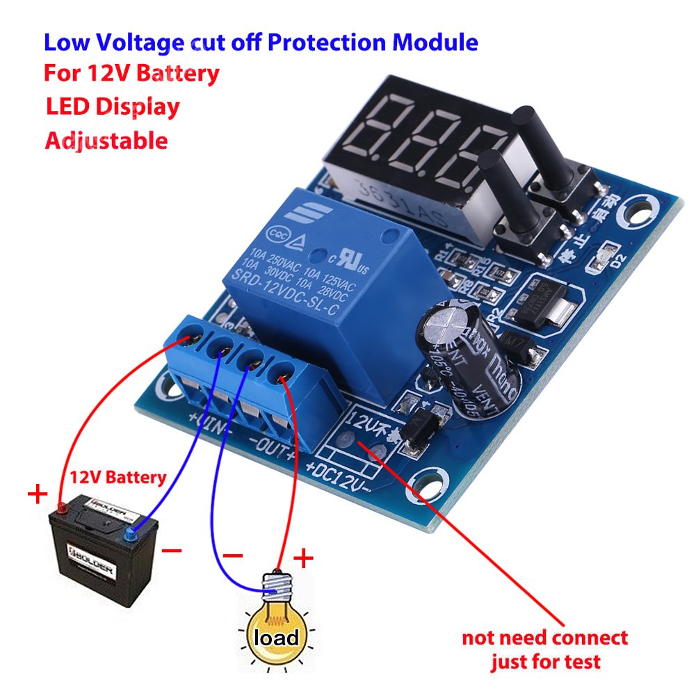

Well I thought I created a pretty comprehensive, thoughtful post, certainly not deserving a snarky patronizing response--but theres always a couple of you on every forum, so I wont take it personally. I did include a photo of the relay and its programming instructions, I dont know why it is not showing, but a relay is a relay, and since you missed it, its 12v in and 12v out, or whatever volts i want (another relay) out, depending on the best solution to the problem
If you dont have experience with inverters, esp. pertaining to 12v rv/boat systems, maybe just pass my post by, but I will break it down, its pretty simple-- I just left it out in the interest of not covering ground that electronics buffs would probably consider basic.
Inverter converts 12vdc to 110vac. I want said inverter to shut off or turn on when battery voltage reaches set voltage, controlled by programmable relay. The problem is the inverter and its remote on/off switch(your "hand controller"(?), are both momentary "soft-latching" type switches, where as a relay is a basic open or closed, contact or no contact type switch.
I want to control the inverters on/off power with a relay. The problem is I cant do it with its power supply, because the inverter powers up in the "off" state, i.e. the momentary soft latch mosfet switch. As opposed to a toggle switch.
This is where I need someone with more experience who may know the pinout of the rj11 jack of the remote switch, or knows how to convert a soft latch switch to to something a relay can control, short of a mechanical "finger" that will press the button for 2 sec.

So with my relay controlling the 555 module, high set voltage reading from battery in my relay triggers a timed contact, that works, but what about when the voltage cutoff relay turns off (open) as it hits the low voltage set threshold? Can the 555mod be triggered by open state?
Sorry if my electronics nomenclature is weird, I'm no pro. thanks
