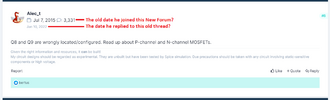

There are two dates on each post that do not say what the dates are for.
Soory?
I see only one date:
1680149729073.pngCould you please show the other one so we can report this to the Admins?
Thanks, Harald
Kiwi
Jan 28, 2013
506
Jan 28, 2013
506
I also only see one date - Jan 2022.
There seems to be a few old posts getting resurrected recently.
Harald Kapp
Nov 17, 2011
14,317
Nov 17, 2011
14,317
Hmmh, looks completely different from what I see on the PC in Chrome.
Just checked it: It seems to be a matter of the theme one uses. Since I still use the old electronicspoint theme, I see only the date of the post. The first date indicates the start of memebership, followed by the number of posts. The second date is the date of the post.
With regard to this thread, however, I still see 2022 only, not an 8 years old date:
