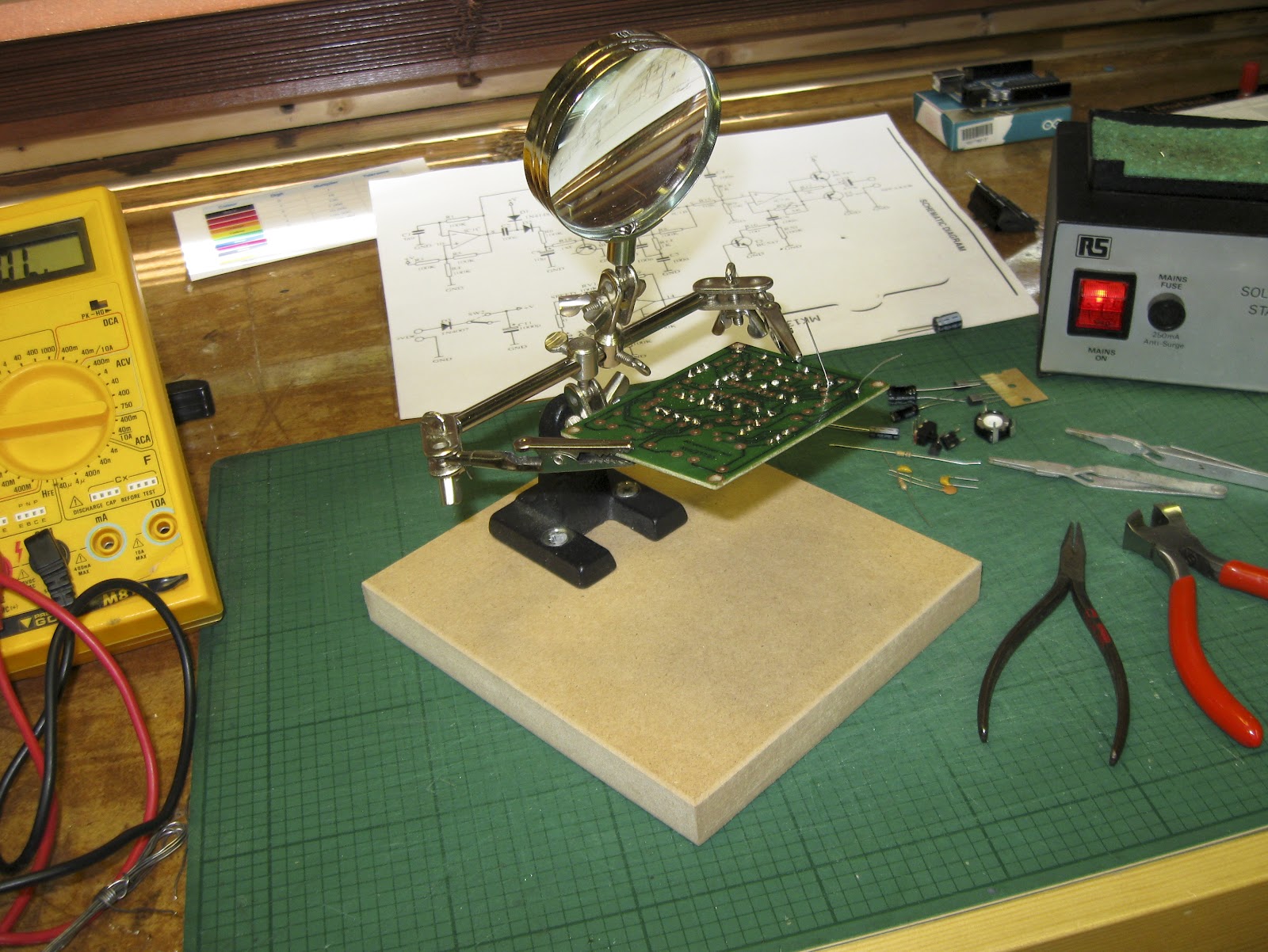

I have not been involved with practical electronics for a while and the other day I decided to put together a small kit of a steam sound generator simple little kit should be no trouble to build. As the PCB is small I clamped it in the jaws of the crocodile clips of my helping hands and set to work only to find the helping hands kept falling over every time I applied any amount of pressure to the tip of the iron.
I solved the problem by drilling the base and fixing it to an off cut of ¾ inch thick MDF. works a treat!

May I suggest an upgrade to double sticky tape and/or glue to a piece of marble tile? I find that excess flux always seems to find it's way to MDF/Wood and makes for a sticky hard to clean surface... As of late I have really been enjoying working on marble tiles, nice sold easy to clean, heat resistant (good for that hot air SMD work) and portable work space blocks... And I personally just like the feel of the stone work place, maybe I'm just weird...
