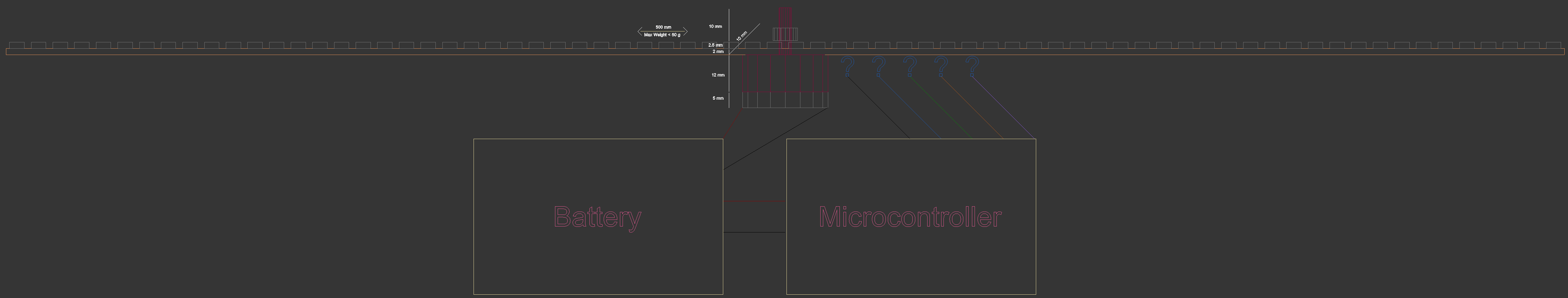

Hi,
I bought an EMAX RS 2205 2600KV Motor, and I want to attach a slip ring to it that has 6 cables.
The slip ring will be turning at a minimum of 1440-1800 RPM, ideally it would be running at 3600 RPM, and at max it might be running at 72000 RPM. However depending on the price of such a slip ring I might settle for the minimum RPM.
The slip ring will be running for a few minutes on occasions, and therefor there's no need to look for something too durable, but I don't want something of terrible quality either.
I would appreciate your recommendation for a high speed slip ring that fits the criteria and can be installed on this motor, preferably from a company that ships worldwide.
Note that I never used a slip ring before, therefor I am unsure how to install one on this motor, and I would appreciate some pointers as well.
This is the motor I bought:
https://www.aliexpress.com/item/EMA...CW-Black-Prop-Nut-RS2205-for/32694139341.html
Thank you :)

Night Watcher
Nov 6, 2017
7
Nov 6, 2017
7
Hello everyone, thank you for the prompt reply, here are more info:
The engine will be rotating a 50 cm rectangular piece, which holds some electrical components that I want to control using the signal transmitted by the microcontroller.
That is why I want to use a slip ring, if you think there is a better way to approach this please let me know.
Also if I can't in any way send the signal from the micro controller to the spinning piece, let's assume that I can attach the microcontroller to spinning piece, how can I send power? The battery is pretty heavy and large to attach to the spinning part.

I think you need to outline exactly what it is you are trying to do to get any relative help. Personally I cannot see your getting anywhere near your rev range with a 500mm disc not to mention any additional load.
I made a quick diagram of what I am trying to build
The rotor has a PCB on it containing identical components which should be perfect for balancing. I do not know how much the rotor weights yet since not all components are built yet, but it should not exceed 50 grams.

To begin with, I do not think those little motors would have any chance of spinning a 500 mm disc at even the low range of 1800 rpm. Secondly, I don't think you are aware of the centrifugal forces that would be exerted again at the minimum quoted speed. Time to do a re-think maybe.
I have built a similar device with heavier unbalanced components and a slower engine before, therefor I am positive this will work. Yes you are right there is a lot of heavy balancing work that needs to be done but it is doable.
The question is not how can I reach those speeds, the questions is where can I find component that would work even if I reached that speed.
For this iteration I need to send 5 cables to to the rotor. With some trade-overs I can reduce that number to 2 cables for power source transfer.
P.S.: I did some adjustments to the design, and just needs to run at half the specified RPMs, Also let's reduce the length of the rotor to 30 cm diameter
