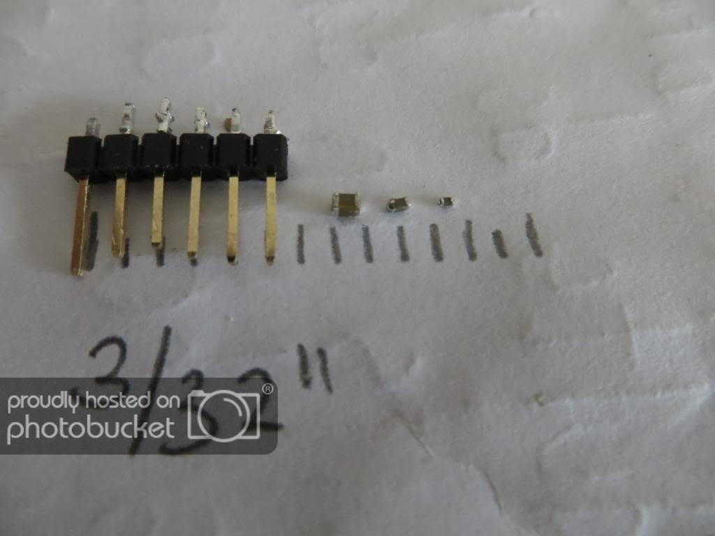

I tried my hand at removing some SMD's today. It is apparent to me that my crappy iron is not up to the task - simply doesn't put out enough heat! All the videos I see, it just takes a touch, while my iron has to sit on the component for quite some time before the solder flows. I did pre tin my tip and use a flux pen ;-) I attached a pic of some of the pieces I pulled off a scrap board. Luckily I was able to find two soic-8 chip that are the exact size of my next project to practice with :)
Can anyone recommend a good soldering iron?

It is quite possible that the boards you're trying to desolder parts from are using unleaded solder which melts at a somewhat higher temperature.
If the board has large areas of copper, this may also make life hard for you.

Copper braid, I don't know whether it was the old solder or the iron itself. I fluxed the terminals just prior to applying the braid and heating the terminal, some posts would go liquid quickly, most did not. The smd's came off fairly easy - I actually had more trouble with the through hole parts, some were soldered top and bottom? I don't know if that was just excess passing through the hole or something else.
Aside from a good iron, (which I still could use your recommendations on) is there a particular flux that is better? I have seen some being used in videos that was much more viscous, seemed like it worked better.

For surface mount devices there's often nothing else to do other than to melt all the solder and lift the device off while it's still molten. This is where hot air really comes into its own.
The removal of through hole components is almost always exactly opposite. You remove all the solder and let the device fall out. To highlight this difference, sucking is often the best approach.
