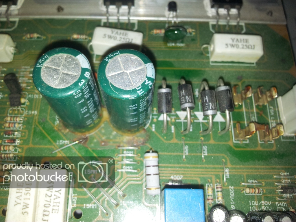

Well I'm also an engineering student... although I'm a masters degree student doing chemical engineering :D
And I stumbled upon this forum and thread when I was googling a similar problem I have with one fuse blowing.
A friend told me to check the output transistors, but they appeared to be fine. I also checked the rectifier diodes and they checked out as well. Then I checked the big caps (filter caps I guess?) and the one gave a short... So I'm off to the electronics store to get some new ones. The stock ones are 3300 uF 50V Sanyo caps (Electrolytic). So I'm going to replace both with high temeperature caps and see what happens!
I'll check back to tell u guys what happened :)
Here's a pic of the area where the culprit is... (Fuses removed from slots on the right side)

I would recommend that you check the diodes in the bridge rectifier for shorts.
See that muck under the caps? It looks like they've vomited all over the board. I suspect that changing them is a good idea anyway.
Clean up the board once you have them removed.

What is that muck on the caps? I see it on various spots on the board.
It's a budget unit, but the sound quality it provides is quite nice...
Also, the bridge rectifier diodes are the 4 diodes located toward the right of the caps? Ive checked them and they all have similar resistances so they appear to be fine.

Well the fuse lit up again after I replaced the caps...:confused:

You can try to replace the fuse by a resistor (temporarily) to limit the current to a few mA. Then follow the traces on the PCB measuring the voltage versus GND at any available solder spot along the traces. If you're lucky, you can identify the short by a comparatively sharp drop in voltage. Or by a component that gets hot.

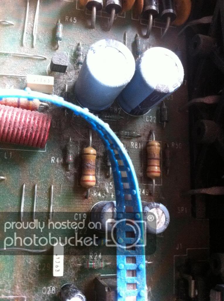

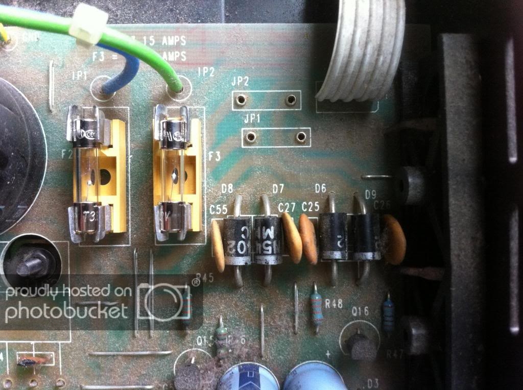

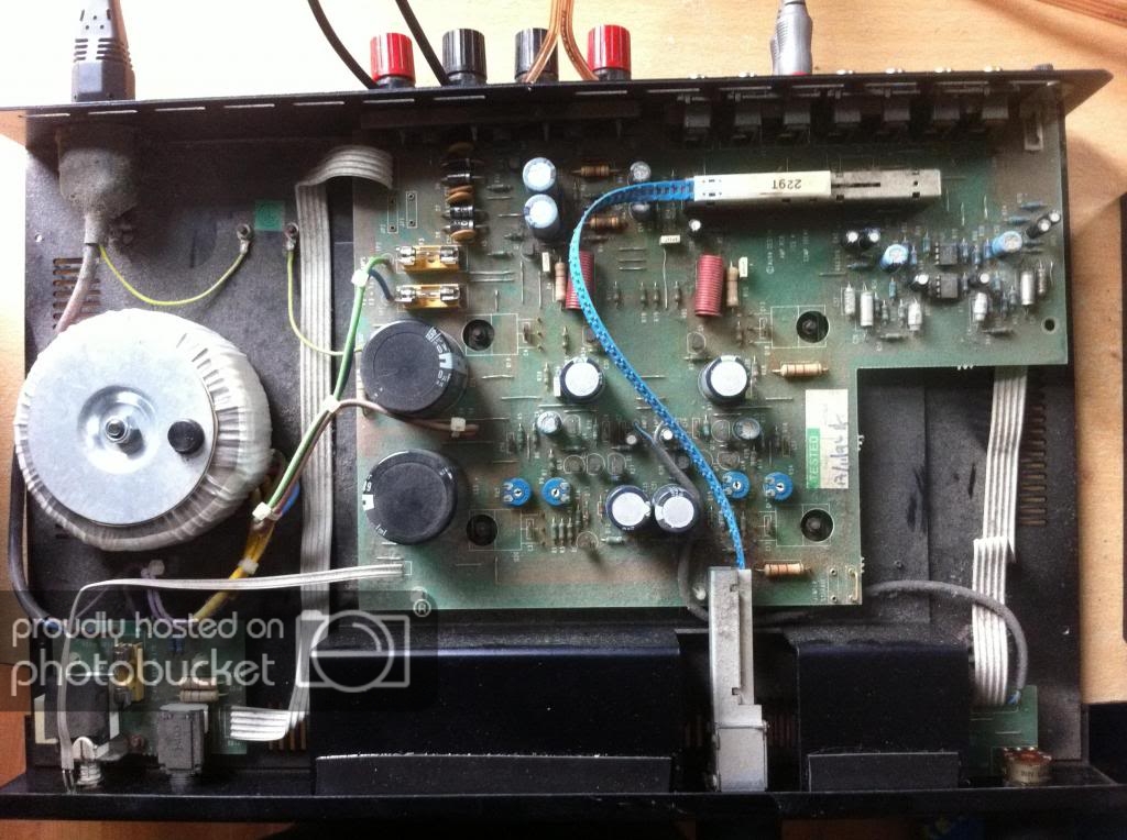

Aura Power Amp - PA - 50
Ok, so a mate gave me this Power Amp for nothing and I did a bit of research and it seems to be a good one, made by B & W back in the 90s. I opened it up and the fuses were blown, both of them. I bought four fuses, and inserted two, powered up the amp while it was connected to speakers with volume turned down very low. I also had some music playing through off my iPhone. On power up the speakers immediately began to buzz and no music could be heard after about 5 or 10 seconds one of the fuses blew and no sound was coming from the speakers. Here are some pics of the PCB. I found two very burnt out looking resistors seen in the last picture, the diodes of the bridge were also stuck together possibly from the heat over the years. I can't see anything wrong with the large capacitors but would like advice on how to test them. I have access to a cheap multi-meter.
I need to know what I should do next basically, Those resistors need to be swapped out, but I'd like to know where the short is before I start changing stuff out. What is the best way to test the diode bridge, the capacitors and transistors? Appreciate your help here guys!

Well it looks like the previous guy disappeared again, but the "muck" appears to be what almost universally mucks up the board when an electrolytic cap fails...electrolyte from inside the capacitor.
For the latest guy: it kind of looks to me like you might have a leaky capacitor also. The board appears to show some more of that mysterious "muck" under the cap on the left in your 2nd picture, unless that's just a dust bunny. And you're right, those resistors (R43 & R49) are showing definite signs of a short/overheating also.
The best way to check the caps is an ESR meter. If you haven't got one you can check the cap terminals' resistance for a short using an ohmmeter after discharging them. Use the diode test mode on your multimeter to check the diodes and transistors. The transistors should be compared to each other and any others of the same type. Check (power off!) across all the legs in every orientation and compare, look for any readings that are different, shorts or opens.
I'm still fairly new to this stuff, so that's about as far as I can go into detail. If you find something report back, if not, one of these gurus will hook you up, just remember to post back!

Yeah sorry the PCB is very dusty, need to give it a clean reckon that's just dust, I've blown a few caps in my day and this one looks ok.
