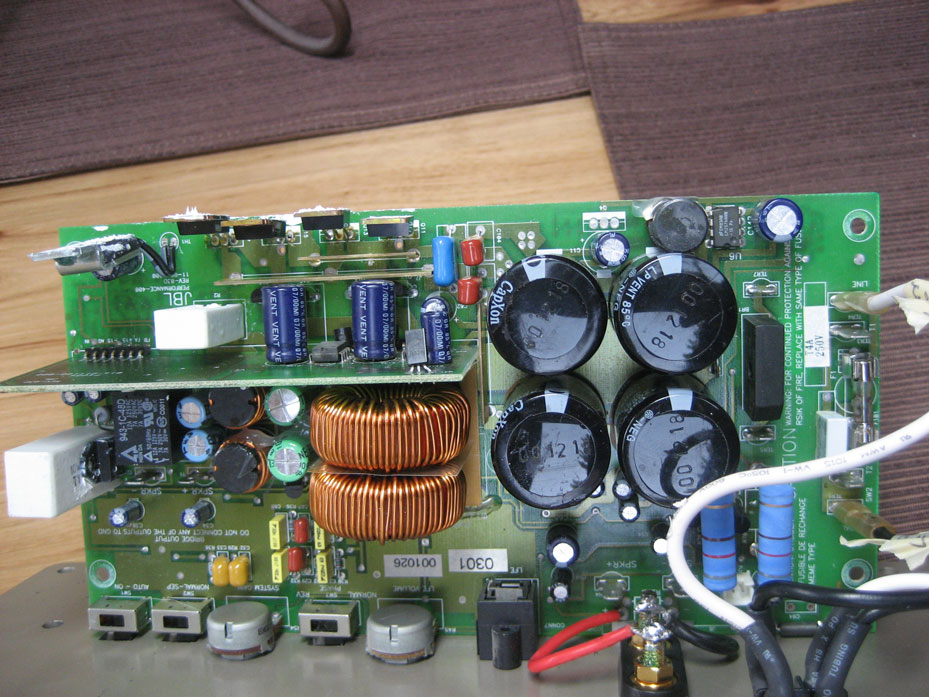

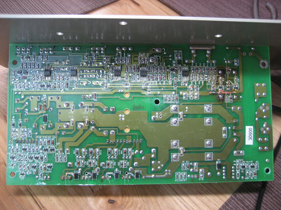

This is a plate amp from a JBL PS1400 400W subwoofer amplifier. I have tried a few things, as outlined below, but my limited knowledge has been exhausted. Any help is appreciated.
Amp version: Rev - 03D 11/06/2000
All references to components are based on the PS1400 service manual and circuit board.
The service manual (and schematics) can be found here:
http://www.jbl.com/resources/Brands...cuments/en-US/ServiceManual/Ps1400 Sub SM.pdf

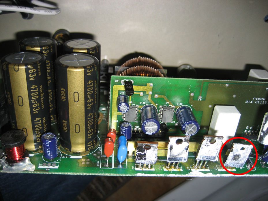

1. The first sign of trouble was when I noticed there was no output, the leds were red, and sometimes the leds would turn green for a second and would power the speaker. I checked the driver and installed the working amp from the other PS1400 in where the faulty one was and it worked fine, so I am pretty sure the problem is just within the amp itself.
Action taken:
a. I bench powered the amp and found nothing that would indicate that the amp shouldn't be working. Because transistors are often the culprit, I removed the output transistors. I then bench powered the amp and the relay sounded like it was functioning so I thought I had it figured out.
b. I ordered new transistors and changed the output transistors Q11, Q13, Q15, Q17
c. I then bench powered the amp and it appeared to be working
d. I also noticed visible dark spots on PCB board where R76 and R78 mount. It was the same on the board of my functioning PS1400. See pictures below of functioning board:
2. After reinstalling the plate amp it ran for a few minutes then back to red LEDs. I could hear the relay clicking.
Action taken:
a. I saw that the fuse had blown. I replaced the fuse from the working amp.
3. I powered the amplifier on the bench. PCB board shorted., D3 was melted, Q8 was visibly broken
a. Replaced D3, D?, R76, R78, Q5, Q8
b. Soldered over fried area of PCB board
3. Amplifier LEDs powered straight to green, but no output, burning smell
a. The PCB was fried again in same place; fixed, replaced burnt out U4
b. removed and tested bridge rectifier, diodes tested good.
c. Measured transformer resistance through DMM, both good and questionable had same measurements both VAC powered and Ohms while off.
4. Hooked up board to known working amplifier’s transformer. Blown fuse, no other visible damage.
5. I put in the new capacitors and this time Q17 blew up and then before I could even flip the switch, the fuse blew. See picture below with the offending transistor circled and you can see the new caps as well.
I took all of the power transistors out and fired it back up (with yet another fuse -- I'm getting low!). No pops or blown fuses. I was able to get my DMM in there to measure some voltages.
V+ 50V
V- -49.9V
+15v cycling between ~13v and ~16v
-15v -10v
No clue what the problem is. Maybe to voltages are off because I have the power transistors out and they aren't drawing power, but I suspect that some component is either open or shorted and/or a voltage regulator is bad. I guess I will take a break for a bit and then come back and do a ton of voltage measurements and try to figure out what the problem is.
Other things I may try:
1. Replace the output transistors again
2. There were a couple differences between my board and service manual schematic. Ex: R 76 and R 78 were not 820 Ohms, they were very close though. I wonder if there are any other changes?

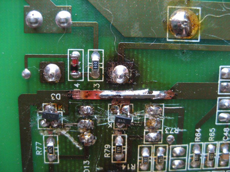

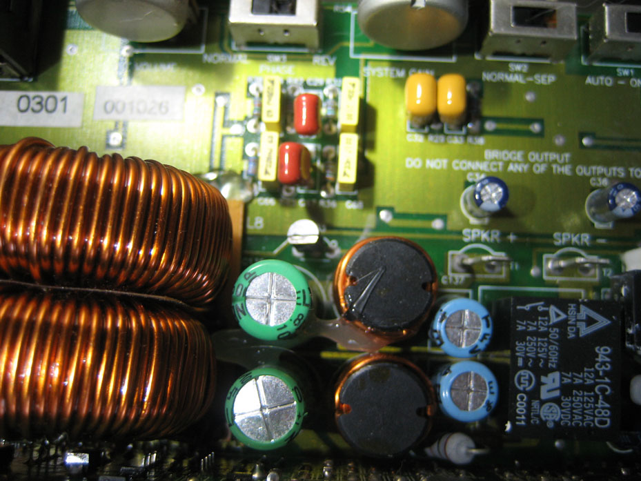

Pic of the top of the board:

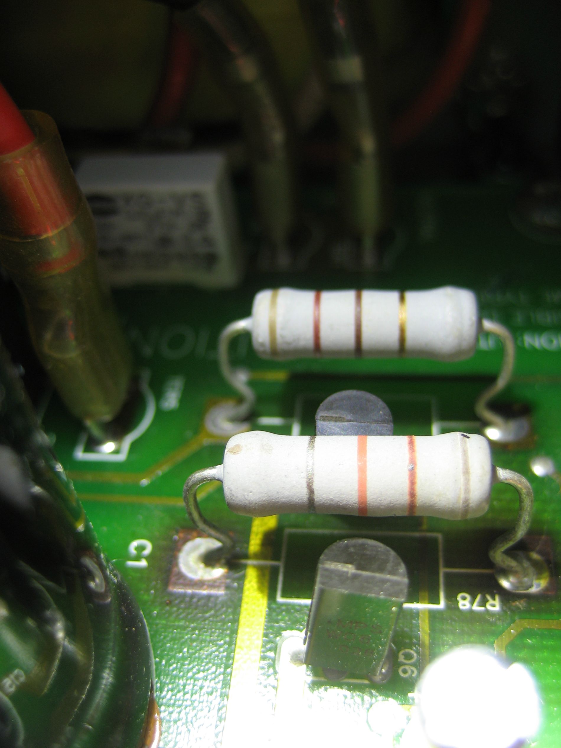

Note: you can see the replaced resistors R76 and R78. They are both 820 Ohms and 4 watts.
Any other ideas?

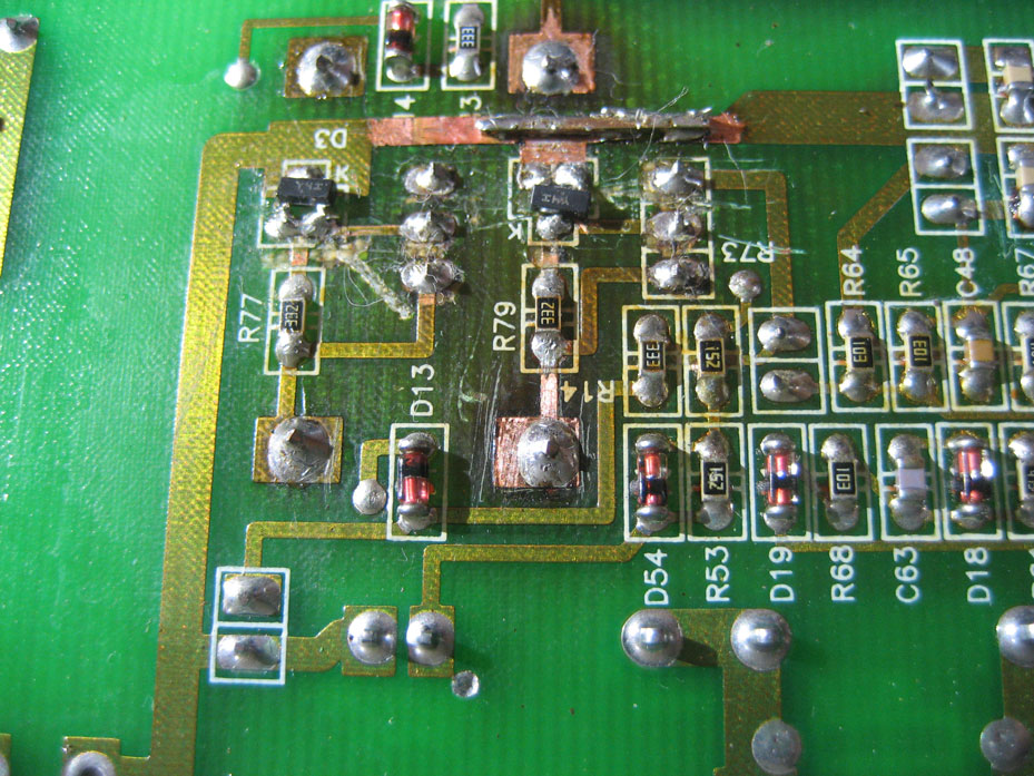

I want to mention now that I don't like the look of the area of the board where the track has lost its solder mask and has been repaired. I would clean that area thoroughly with isopropyl alcohol and a cotton swab. Personally I would first remove all the solder mask from a longer area of the track, and solder a piece of thick wire (at least 0.5 mm diameter) along it, tinning the whole track as well, before doing a thorough cleanup. That would look tidier in my opinion.
After you clean up the area, can you take a good close-up photo of it please.
I am also a bit concerned about the charring of the board, due to heating of the 820 ohm resistors. Even fibreglass will start to lose its insulating properties if it's charred enough.
You can estimate the load on the 15V rails by measuring the voltage drop across the two 820 ohm dropper resistors.

4. The heated area around the 820 ohm resistors bothers me as well. The working amp has the same burned marks as shown in one of my photos. I'm not sure if the circuit created the extra heat or if there was a late stage repair made to the board and a tech over heated the area when it was repaired. That's just an idea that popped into my head.
5. The voltage drop across the 820 ohm resistors is:
Working amp:
R76: -50V to -22.9V
R78: 50.5V to 14.14V in standby and 17.8V when active
Broken amp:
R76: -50V to -7.5V
R78: 50V to cycling between 12V through 16V and back down

first off where you have bridged that damaged track is no good-remove the broken track completely and solder a short length of tinned single core wire across it-isolate the supply from the rest of the amp and get that working first-looking at the schematic its an easy supply to repair-with all voltages as they should be ill talk you thro the rest

Personally I would leave the track and just add a wire on top of it, running down the middle. And LOL (slightly :)
Yes I noticed you said that the working amp has the same overheating issue. I would fix that as well. Perhaps move the resistors off-board - mount them against the heatsink, or the front panel, or on individual heatsinks, or at least on standoffs. You may find that thick film resistors are easier to mount onto heatsinks.
I doubt very much that the discolouration would be caused by soldering. It takes sustained high temperature over a period of time to cause it. If there's any sign that the area is becoming conductive, I would remove that section of fibreglass completely, using a drill and some files, and remake any affected circuitry - perhaps on pieces of stripboard or perfboard. That's quite a job though.

I replaced the solder bridge with a piece of gold plated jumper. I think this will be a better fix. It really looks like a mess in the macro picture, but it's the best I could do. I will get some alcohol to clean up the board a bit.

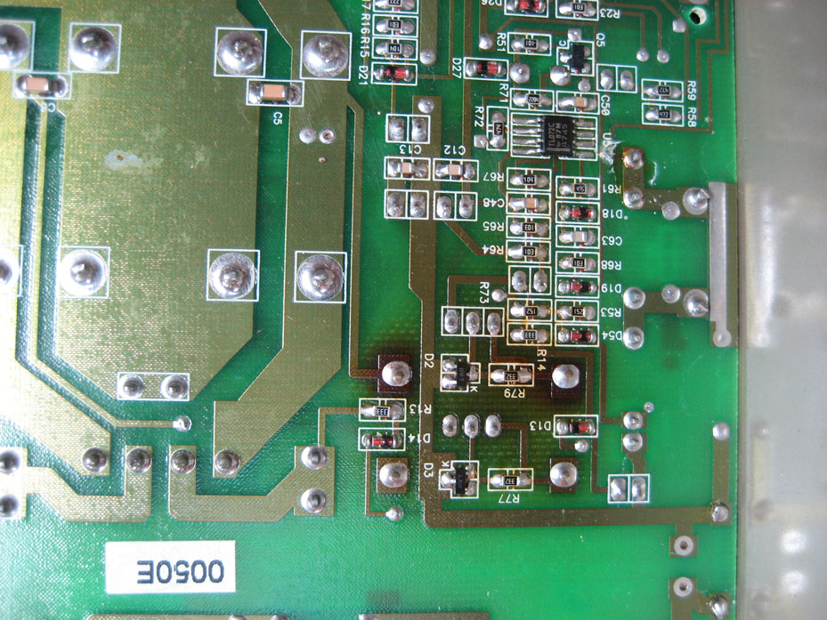

On a side note, I was staring at the board and noticed that only one of the anode pins on D3 was properly soldered and my DMM was reading about .7v through the diode. I soldered the other anode and now it reads 1.8v through the diode. I haven't fired it up after doing this.
Again, thank you for all the help!

Yes, you've used the right transistors. Q8 is a PNP. The parts list says it's an NPN; that's an error.
D3 only has one anode pin. Looking at the photo in post #7 on this thread, the anode is the pin at the bottom left of the device. The pin at bottom right is not used. If that's the pin that wasn't properly soldered (and it doesn't look like it's properly soldered in that photo), then soldering it won't make any difference.
As for the voltage measurements, I assume you're measuring across the diode with your multimeter set to the diode test range? If so, you should measure about 0.7V across the diode, with the positive lead to the anode (bottom left) and the negative lead to the cathode (top middle). If you're measuring 1.8V across the diode with the probes that way round, the diode is probably damaged. But I don't think that's the case.
Edit: You didn't answer my earlier question. What test equipment do you have, apart from the multimeter? Do you have an oscilloscope?
You were right as far as the difference it would make. No change by re-soldering. My test equipment is limited to a DMM. I don't know anyone around here with an oscilloscope.

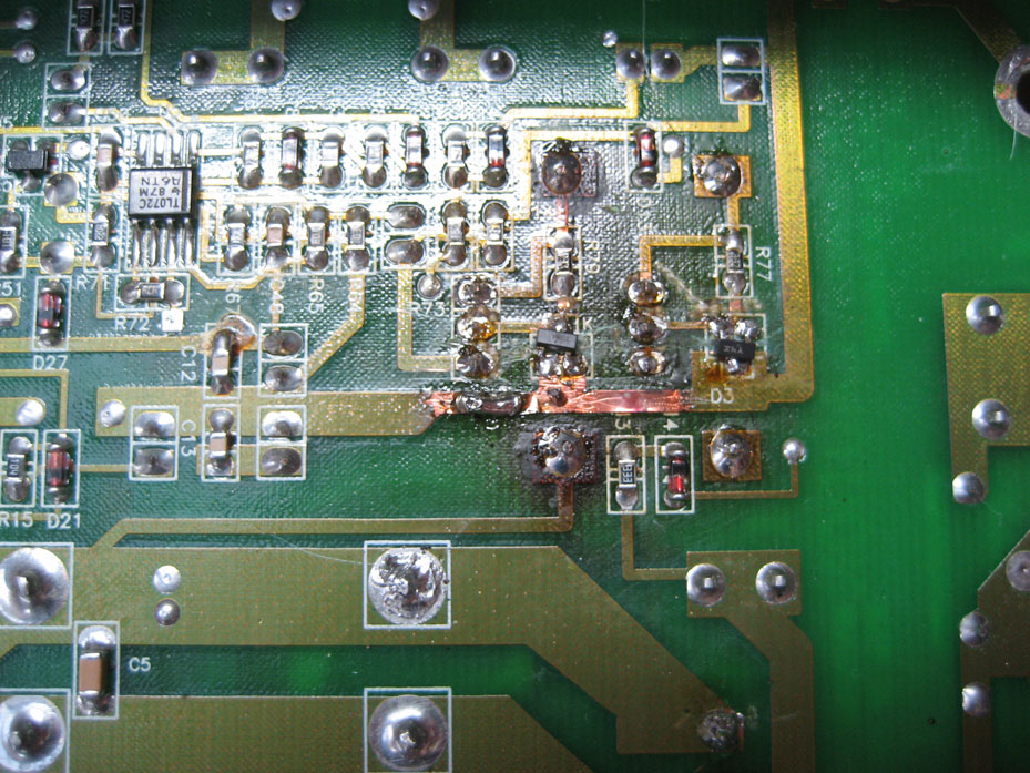

I don't think an oscilloscope is needed - yet. But this is a Class D amplifier so it will be very useful later to check the PWM drive signals. This is significant because all the PWM stuff is done with op-amps, not with a dedicated control chip that could just be replaced on suspicion.
Isopropyl alcohol should be able to clean up that board nicely. You need to use a cotton swab (stick with cotton wrapped around each end) and a fair amount of pressure and back-and-forth rubbing, but it should work. I've never had a situation where it didn't.

5. I am quite concerned about the condition of the PCB around the R78, and to a lesser extent, R76. At the moment I'm giving them the benefit of the doubt but at some stage I may ask you to remove R78, R79, D2 and Q5 and check for resistance between tracks in that area, to see whether the insulating property of the fibreglass PCB has been compromised. If this is the case, you will need to use a drill and files to remove all the discoloured fibreglass, and remake the required parts of the circuit.
6. You said that R76 and R78 are not 820 ohms but were very close. Do you mean you measured them and they weren't exactly that resistance? That's to be expected; resistors, like all components, have a tolerance. Were the originals marked as 820 ohms (either with printed markings or with colour bands), or were they marked with some other value?
7. I was serious when I suggested moving R76 and R78 off the board. The discolouration on both boards is quite bad; if it isn't causing problems now, it will in the future.

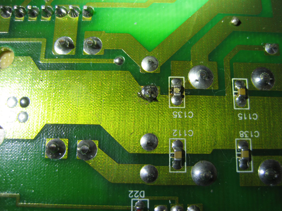

Kris: Here are a few more pictures
1. Here is a picture after some cleaning:
2. Here is a problem I noticed while cleaning. C135 appears to be fried. Also the lead next to it on the left was not soldered correctly, It was loose. I resoldered it, but it needs to be resoldered again to clean it up.
This it the top view of the capacitor that wasn't soldered correctly. It looks like it is bulging a bit. The green one on the bottom. It is C113 for reference.
I really don't want to do this :( I did measure resistance with the parts removed and I got infinity measuring in ohms.
They were marked as some other value. I couldn't tell what the colors were, but here's a picture of the good board and the resistors on it.
