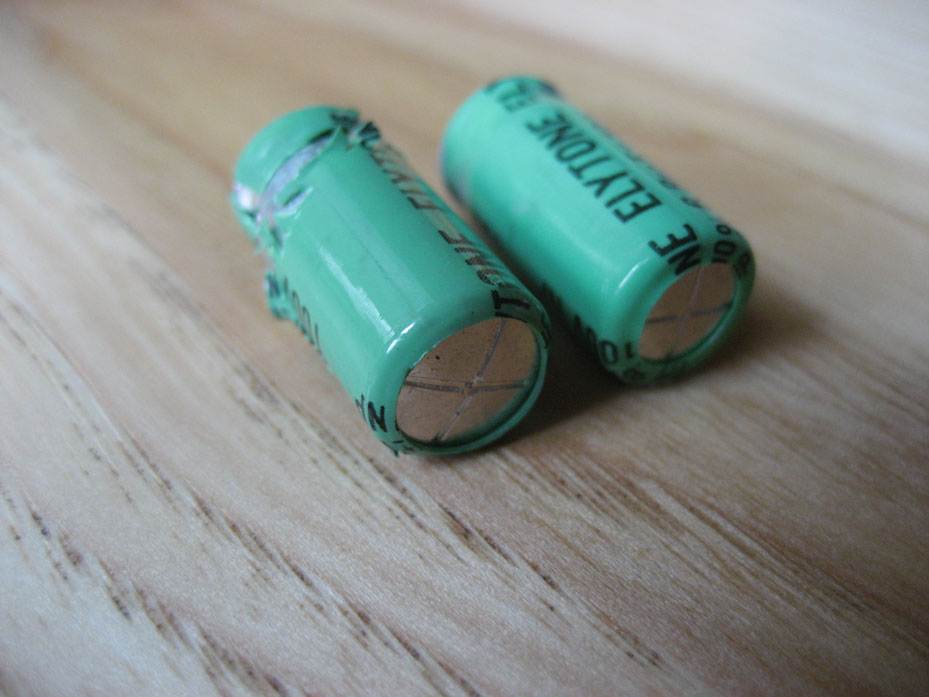

Thanks for the updated images. The reworked area is starting to look a bit better now.
Yes, C135 looks like it needs to be replaced. The joint nearby looks OK now, I think, but I think you should carefully inspect the whole board for dry joints. Run this Google images search to get an idea of what a dry joint looks like: http://www.google.com/search?site=imghp&tbm=isch&q=dry+joints
I have gone over it quite a bit and I think that was the only dry joint.

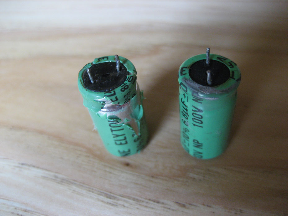

Yes, that electrolytic is definitely bulging. Is it C113 or C136? It's a non-polarised electrolytic capacitor, rated at 100V. Neither Digikey nor Mouser have any suitable replacement. Actually I don't think the designer should have used that type of capacitor. A polyester or polypropylene capacitor would be a lot more appropriate in that position. See http://www.digikey.com/product-detail/en/QXK2E685KTP/493-3526-ND/2117905. I would also replace the other one.
C113 is the bulging cap according to the label on the PCB, but I see what you're thinking. C 135 and C136 go together. When I fix this spot I will just replace C112, C113, C135, and C136. Again the components are rather inexpensive, but the cost of multiple orders adds up.
That is not the only dodgy component choice in that design. I've noticed a few poor design decisions and I think the designer may have been inexperienced.
This is from a subwoofer that retailed for almost $2000 back in the day!
The failure of that non-polarised electrolytic may be related to the failure of C135.
