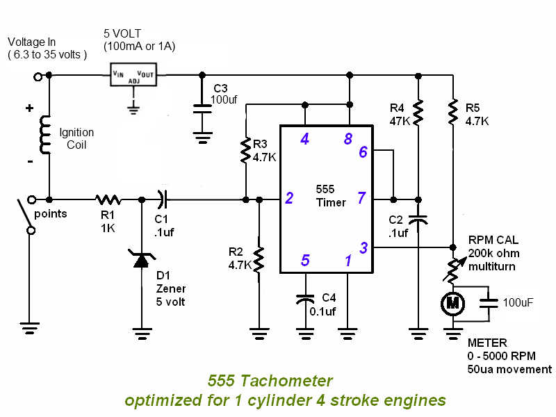

Hi everyone, I found this schematic online and I'm curious how I can adapt it to my motorcycle.
My bike is a 1 cylinder, 4-stroke engine that fires the plug on every stroke (not every other like normal). As I understand it the circuit outputs 0.01 ua for every 1 RPM. 50ua = 5000 RPM. In my case I would need a 100 ua meter to read 5000 RPM since my plug fires twice as much as most engines. The circuit is designed to read a plug that fires every other stroke. My bike has a "wasted spark" ignition system. There also are no points. It is a CDI ignition system. Can I wrap a few turns of wire around the spark plug as input instead of connecting to the non-existent points? Does any of this look out of place or could it be done better?

The meter does not need to be different, just adjust RPM CAL to suit. Reduce C2 by half to allow higher trigger speeds if necessary.
You may be able to get a signal by capacity pick up but will need experiment. I would increase R1 to perhaps 100k to protect the 555.
Do not use a CMOS 555, they will be more delicate.
A resistor (100Ω?) and capacitor to earth before the regulator will give some extra protection.

I'm very new at this so bear with me. Can you give me any idea what value (roughly) that I would need to adjust RPM CAL so that the meter reads correctly? What would the higher trigger speed do? Would the needle just respond quicker?

The 555 produces a fixed width pulse for every trigger pulse. The meter measures the average voltage through RPM CAL. Thus if there are twice as many pulses as required, then the resistor will need to be twice the value.
If the input pulse comes too soon to get a complete output pulse before the next one then the capacitor needs to be reduced to make a shorter pulse. You should look at the pulse length and calculate the maximum possible input frequency.
The needle response time depends on the capacitor across the meter and the needle inertia.

If you want something simpler, go for the LM2907, it has a regulator built in so you do not need the 7805. It is also designed to work from the dirty 12V supply of a vehicle.

The circuit you found can be easily adapted to a wide variety of analog D'Arsonval meter movements with various full-scale current ratings from "sensitive" microamperes up to several "less sensitive"milliamperes. The less sensitive movements are likely to be more rugged construction and more appropriate to the high-vibration environment of a motor bike. The circuit you posted may have been "optimized" for a one-cylinder 4-stroke engine and a 50 μA movement, but that is by no means a "requirement" for the circuit to work. And, as others have stated, there are "better" circuits you should at least consider.
Are you interested in pursuing the construction of a tachometer from a hobbyist point of view? Learning how the circuits work? Learning how to adapt circuits to your purpose instead of blindly following "monkey see, monkey do" instructions provided by someone else? If you can answer "yes" to those questions, there is plenty of help available here. Almost everyone who posts useful answers to this forum has "hands on" experience in electronics. You should get some too!
Can you "wrap a few turns around the spark-plug wire" to obtain a "trigger pulse" for the tachometer? Of course you can. There is a LOT of voltage on, and a strong electrical field around, the wire when the ignition coil fires. A few turns of wire will create enough capacitance between spark-plug wire and the wire wrapped around it to "see" a rapidly decaying pulse each time the coil fires. Problem is, you have virtually no control or knowledge of the pulse amplitude or pulse width, both of which will vary depending on whether it occurs during the power stroke or the exhaust stroke, whether the throttle is open or closed, and the engine rpm. Considering all these factors, you need to create a pulse of the proper level and duration to act as a trigger pulse each time and every time the ignition coil fires. This is where the "hands on" play becomes an important factor.

You can find lower tach signal voltage on driver transistor of coilpack which less damage to input of your tach circuit.
