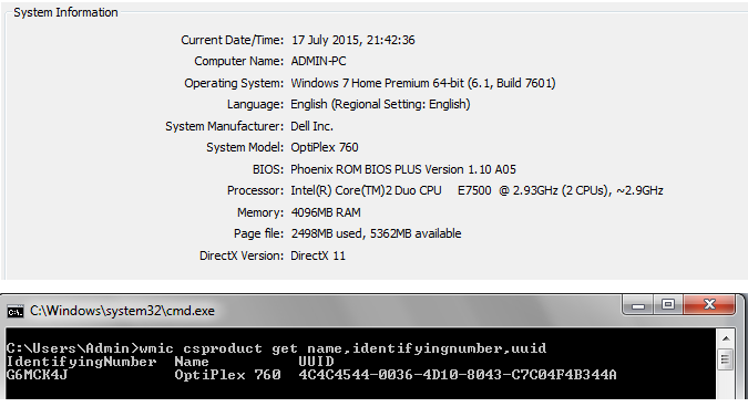

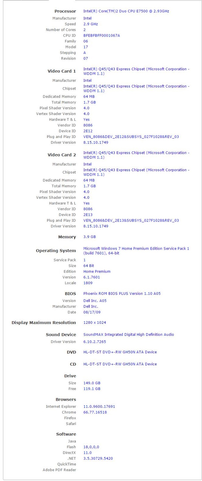

I ran dxdiag but didn't see any model number so i used cmd and got "G6MCK4J"
In case that wasn't what you need here is a screenshot:

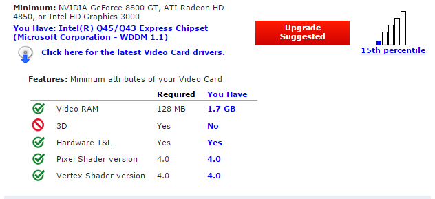

I tested random games in http://www.systemrequirementslab.com/ and for most my pc would do except for the fact my graphics card doesn't support 3D.

From what I managed to track down... you may have an issue with Video Cards being too long.
The fan and shroud around the CPU causes issues... but if the card does not stick too much further from the slot you should be fine.
As far as video cards are concerned, you can grab pretty much any PCI-express based video card you can get your hands on as long as it's short enough. WOW does not have very high requirements, so my suggestion would be to go to a local online computer parts seller and price out a couple card nearing the end of your budget.
(There is a limit of the 'power' draw a video card can have, but given your budget, I don't think you'll get a card powerful enough to exceed your computer power supply)
My suggestion, would be to find items on sale, and check them on this site : http://www.videocardbenchmark.net/high_end_gpus.html
A benchmark rating of 2000 will be fine for WOW, and more than enough for many other games.

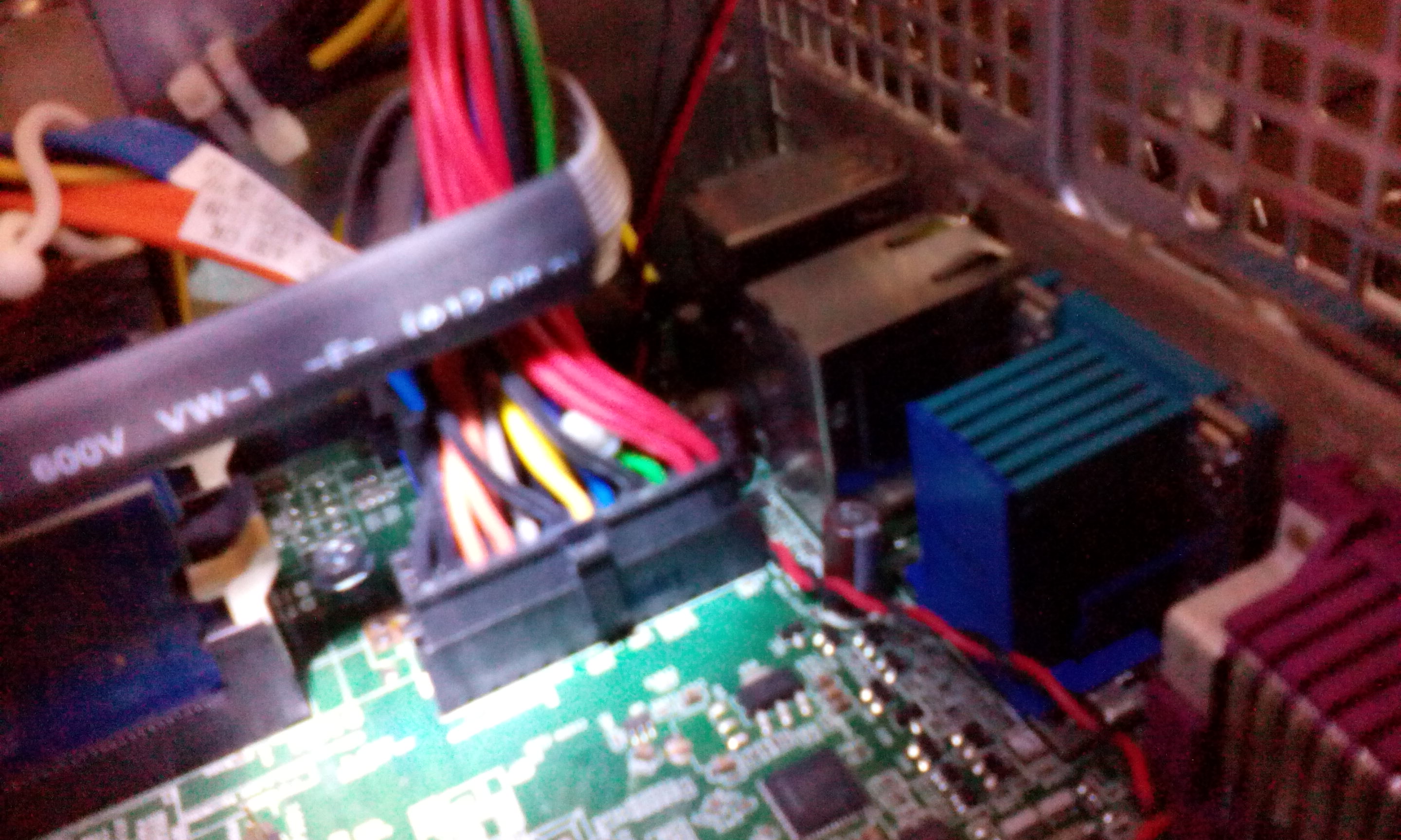

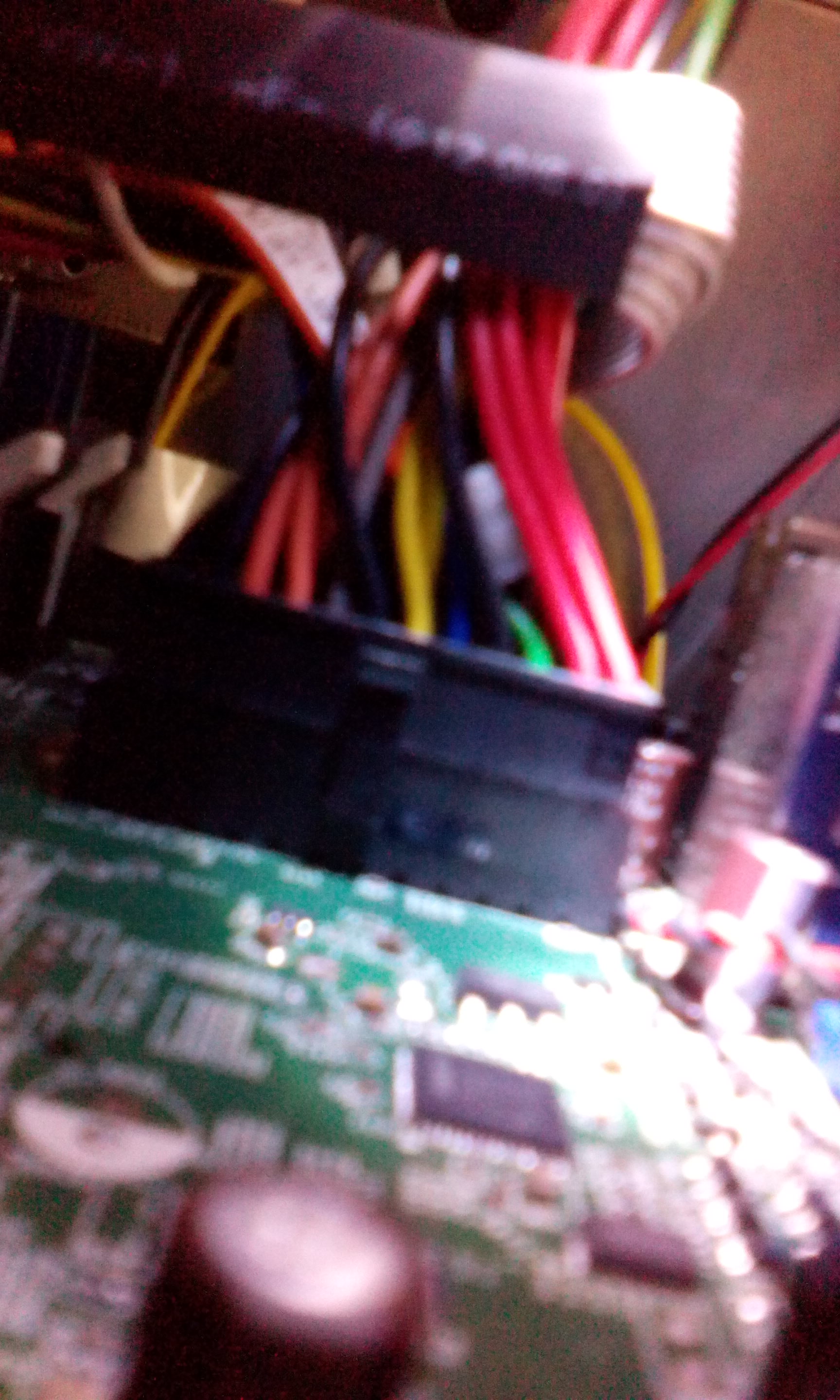

And just when i thought i was all set, I ran into another problem :( my power supply is 255w and all the graphics cards i find are 300w minimum.
To replace the power supply (read some posts online that apparently changing the power supply for my dell optiplex 760 is hard :() What should i look for? how do i know if it will be compatible?

You 'may' be able to squeeze it in anyway.
The GT640 uses between 50-65 Watts.
The processor in your computer uses 65 Watts, and hard-drives typically consume between 6 and 10 Watts.
Considering the computer is not a performance driven build, the motherboard should be sitting at no more than 50 Watts.
Once you account for the optical drive, a couple sticks or RAM and 2-3 case fans, you are pretty close to your limit.
Two things help you out in this case though.
1) The wattage for a Power Supply is usually under-rated, and is difficult to judge due to the fact that the wattage is split up between the +12, +5, +3.3, -5, and -12 Volt outputs. If the
2) The wattage quoted for the components are at 100% load which would realistically only be seen during extended stress tests of the machine.
Remember that for the machine to actually reach this limit, you would have to be reading/writing to the hard-drive excessively while the CPU is bogged down running at 100% while you are playing a game that is maxing out your Graphics card.
Not all computer power supplies are created equally though either... The harddrives for example rely heavily on the 5V rail on a computer power supply, while video cards rely on both 5V and 12V, with many higher end card requiring an extra 12V connection. So simply adding Watts together will never give you an ideal answer because it's entirely possible to overload the 5V output on the power supply but still have plenty of room on the 12V output when your total wattage is less than the PSU. It's a flawed system, but it's 'easy' for quick simple answers... Unfortunately, you need the details so it becomes a little more complex.
Personally, if I were in your shoes, I would see if my friends had any old PCI-Express cards that I could try/have for free... It's old and they don't need it right?
If that didn't work, I'd research the requirements to swap out the Power supply, then risk running a 640. I would be confident the 640 would not push the power supply over the edge, but it's too close for me to give you that guarantee. I had read that your PC came with a 300W supply, but perhaps that was a recent change.
(And FYI... I've done a swap from an old PSU to a new one for an HP... I hated it because they didn't use a standard header for the PSU...
http://www.amazon.com/Pavilion-Motherboard-5189-0683-M2N61-AR-ACACIA-GL6E/dp/B00GBS3GUQ The little black connector on the left of the board (2 rows of pins) is what HP used... so I had to cut off the connector on the original power supply and solder the wired to a female connector. I now have a handy home-made adaptor that lets me use any power supply with a standard plug on this annoying custom motherboard in the HP. Take pics of yours, and we can see if it can be done.)

Yea mine uses the same connector
haha... man, I dislike that connector...
If I had the gear on hand it would have been easier for me... I cut the wires, stripped and tinned the ends, then soldered them together with heatshrink, then tapped the crap out of it to keep it together.
You can also use butt connectors, or these fancy things : http://www.amazon.com/Shrink-Solder-Sleeve-Crimpless-Connectors/dp/B00IEFOCRK
Luckily for both of us, the pinout and color codes should be identical. Doublecheck first and your good to go.

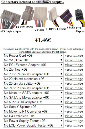

I can't find any power supply that will fit :confused:
(5.75" x 3.25" x 6.0") (14.605 cm x 8.255 cm x 15.24 cm) (W x H x D)
the only one i found thanks to a really old dell forum post is
http://www.atxpowersupplies.com/630-watt-power-supply.php which is the exact size, but would 630w damage it? I am getting the GT 740 which won't require anywhere near that amount.
And if it doesn't matter if it's 630w what should i choose to connect it?

Unfortunately, none...
The ATX 20pin is the standard, the P4 ATX on occasion gets added to it to make an ATX 24 pin connector.... You will need to cut that end off and solder on the 24pin connector from the old power supply...
The remaining connectors will be used for harddrives, cd-roms, floppy drives, and larger PCI-Express items. (Like performance video cards)

From the looks of that power supply... it's just a standard ATX supply. You can get those almost anywhere.
I had to purchase a special "Slim" formfactor Power Supply for mine:
http://www.stuartconnections.com/11...tt-Power-Supply-67P3M-PC6038-86010NA00532.jpg
Word of warning, the Graphics card looks a little long... You may need to move or remove the black plastic shroud around the CPU. (I'm not sure exactly how much space you have, but that card looks a little long. You won't know until you try to put it in though.
(The nVidia chipset is used in lots of other cards . By MSI for example, which may be a different length. This is probably the detail I will least be able to help with.)

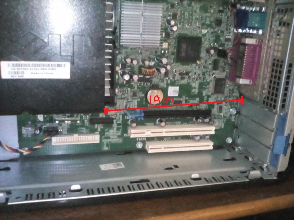

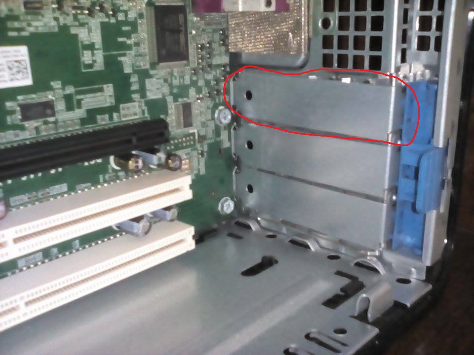

There's 19 cm from the shroud to the case, the EVGA Geforce GT 740 is 17.5 cm long.
So i think it should fit, except that the slots where the end of the graphics card goes looks too small.
I remember seeing there were adapters to make the ends smaller what were the name for those?
